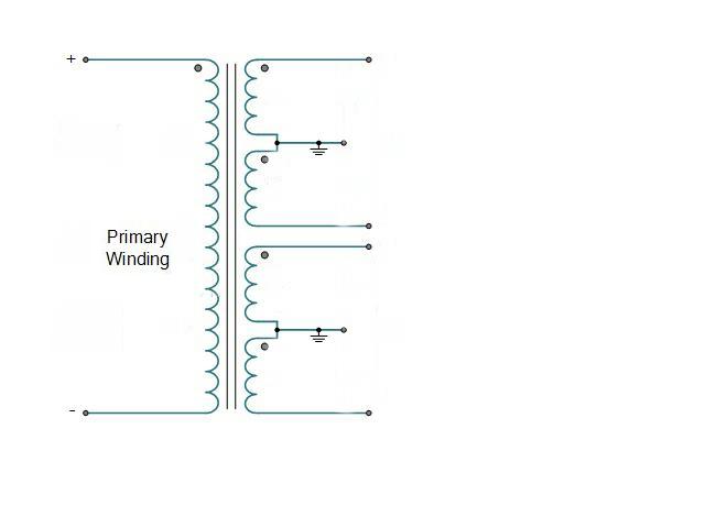

Hi guy's looking for some advice with best way connecting two secondary with centre taps

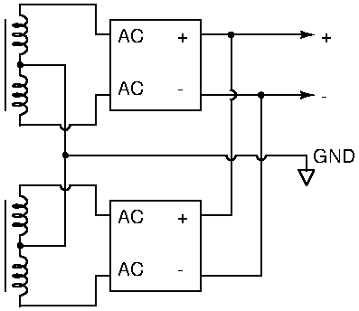

This should explain it for you.
Series Connected Secondary Transformer - Electrical Engineering Stack Exchange

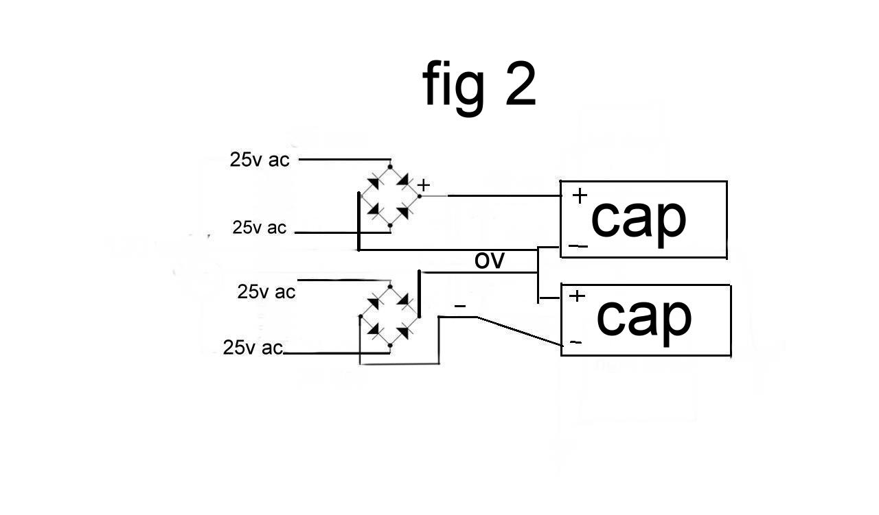

i understand about connecting secondaries either in series or in parallel etc with out any centre tap's. i wish to use in parallel question is what about the centre tap's connection?
Do you want the voltage of only one winding rectified but more current than one winding can give? Are the voltages of all four secondary windings the same?

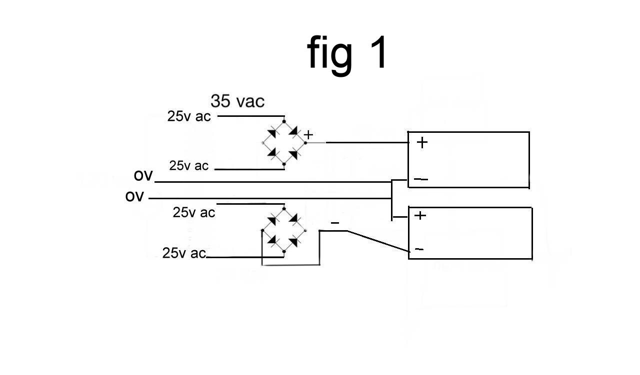

the secondary's are 25-ov-25 & 25-ov-25 about 300va and only need a single output i don't want to change voltage but double the current to drive a amplifier board
How much single DC voltage do you need? If it's low and you don't want use huge regulator's heatsink you could also rewiring both secondaries up to a desired AC voltage output, and then use them as a single supply ignoring the O volt connection.
First connect both secondaries in parallel, i.e. connect dot to dot, CT to CT and non-dot to non-dot. Then connect the rectifier's 1st ~ terminal to the dotted secondary terminal and the 2nd one to the non-dotted one. Connect both electrolytics in series, as you've done it yet. Connect the jumper between both 'lytics to the CT's, connect the rectifire's + terminal to the upper 'lytic's + terminal and the rectifier's - terminal to the lower 'lytic's - terminal. Thus the + terminals will show +35 Vdc at idle and the - terminals will show -35 Vdc wrt CT/jumper.

Your Fig 2 will give exactly the +/-35 V you want.
By the way, if you only have one working bridge on hand, it will work that way, too. There will be folks on here who consider it inferior (from an audiophile viewpoint), but only a few years ago that solution was standard.
Just curious -- what was it about Fig 1 that made you think that you needed that specifically?

😱 Oops -- my 'drawing' will give you twice the voltage you need.
Next time I'll try to think faster and type slower .. 😱

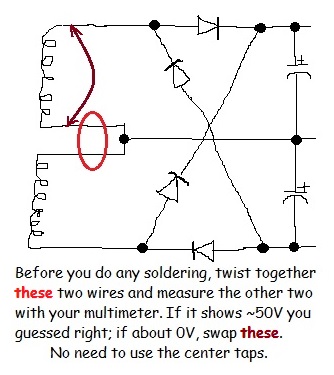

Its wise to sanity-check the winding polarity before paralleling any set of secondary windings. First connect one end of each winding together, leaving the other ends free. Power up and measure the AC volts between the open ends - should be zero, or as close to zero as makes no difference. If you get the polarity wrong this will be obvious. If the windings don't have the same number of turns this will result in a small difference voltage.
If you know the DC resistance of the windings you can estimate whether a small voltage difference is a problem. The circulating current in parallel connection will be the voltage difference you measured divided by the sum of the winding resistances. This should be a lot less than the winding's actual current rating.

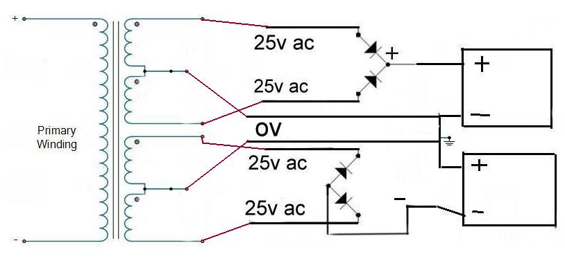

thank's guy's for your info after not having much free time to work on amp lately but did a few try's and what ever way i connect i blow Rectifier's (KBPC5010) i ended up using my in inline bulb to limit power on start up and all seem's to power up with out blowing Rectifier's and the power draw when swich on was about 0.47 amps which seem's to be low to damage Rectifier's plus there is a soft start circuit board fitted.
i was able to dismantle the Rectifier and found the diode's inside was 1N1336 but can't seem to find much info on them
