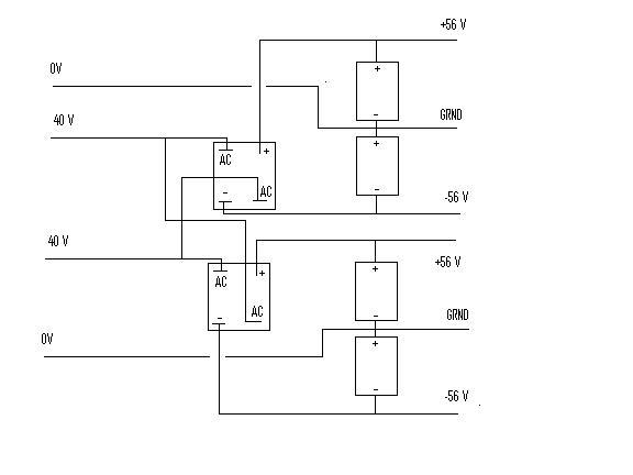

Hey all...got myself a ZAPPULSE V2.1 and having a bit of problems with the power supply..
Got a 500VA dual secondary 40V transformer... 40V-0V on one pair and 40V-0V on another. I have two 35A rectifiers and four 10,000uF 63V Caps.
Having a bit of problems here - hooking up the way LC audio advises blows the fuse...
I did have luck pairing the two 40V to each AC input and taking their respective 0V as ground on each amp module....this way I got 56VDC off caps.
Connecting the 0V and 40V on AC input only gets me +/- 28V at each output....
Is there an issue with the way I am planning the Power Supply??
Got a pic below...

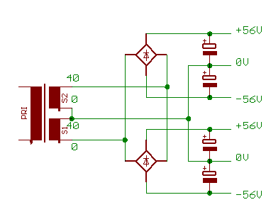

The schematic seems correct, though you may have encountered problems from not linking the two grounds (0V wires) together at the supply. The picture you attached may seem a bit confusing, you might want to take a look at Rod Elliot's supply design to clarify things a bit:
Note: The components on the left are not necessary unless you encounter ground loop problems.

That first schematic is totally INCORRECT. The two secondaries should join together in the middle to form the ground connection.
The second schematic from ESP is correct and you should try to use that one. The centre-tap can be made by connecting the two 'inner' wires together like so:

OK, but I seem to remember as soon as I connected the 40V-0V to make teh center tap, I blew a fuse on power supply......
But I will retry again.

john, if you blew a fuse wiring up the supply as shown in the schematic in my post then you have a short somewhere or some component is bad or you used the wrong kind of fuse. You said you've made these kind of supplies before so I'm thinking you may have a bad bridge rectifier. Check each of the diodes with your multimeter.

OK, if it is a center tapped transformer then it won't work if you wire it up like the schematic in my other post.
Try going simple and wire it up like this circuit in this link that uses one bridge rectifier.

BWRX --> I am troubleshooting before the rectifier - in other words, without the rectifier and Caps connected, the hot fuse blows when I connect the 40V to 0V to create the centertap.
ie, fuse blows when connected like this --> 40V (0V40V) 0V
The fuse does not blow when I connect the two 0V leads. I measure the two Blue 40VAC connections and I get 80VAC.

Ok then. From what you've just said you have a center tapped transformer. That must be what the parentheses around the second 0V means. The fuse blows when you connect the 40V to 0V because you're shorting out that winding. You can only do that when the secondaries are isolated from one another.
Try wiring it up like the schematic in my previous post and it should work. Or use the schematic BV posted if you need two sets of rails.
