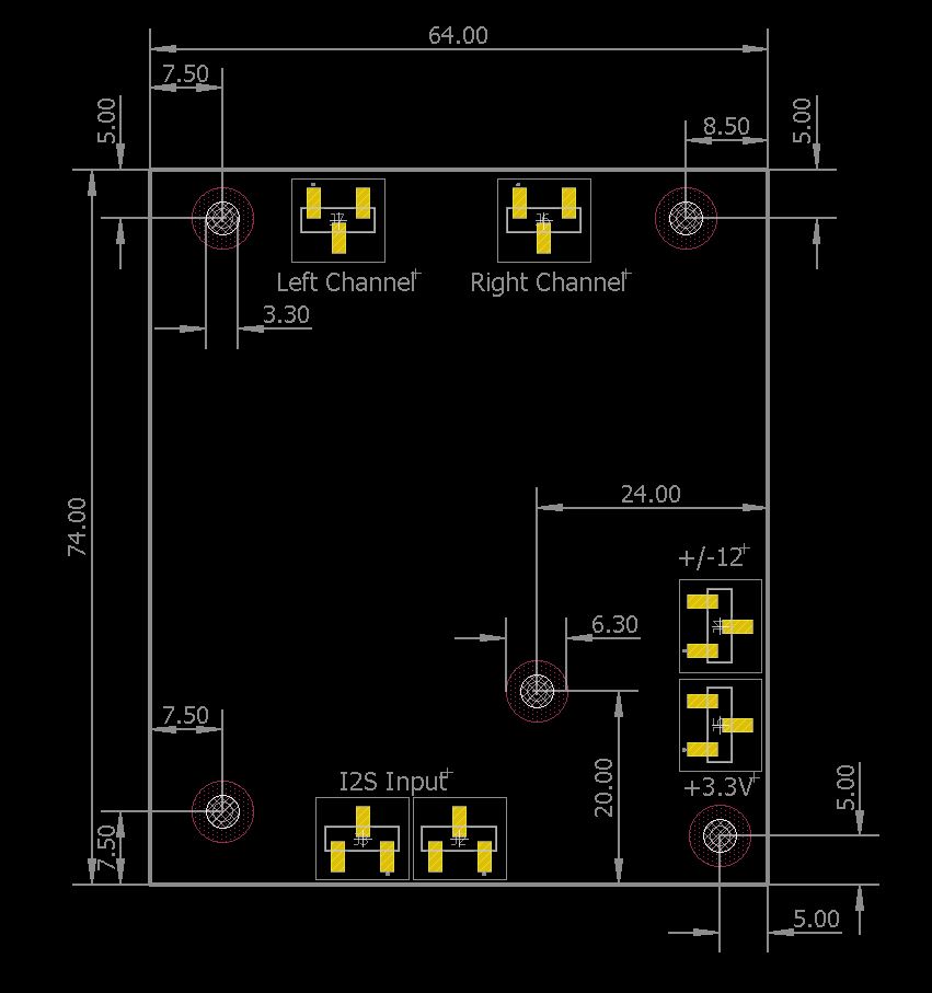

Hello,
I am in the process of designing a PecanPi DAC module that I already have a customer for. They are purchasing 100 of them.
I am putting this here to see if anybody else would like to join in to purchase these modules. Each module will be about $200 each. I will have final pricing in the next two weeks or so. The price will be lower with more buyers.
The modules will feature dual PCM1794A DACs in monaural mode and have specifications identical to my company's PecanPi DAC.
The module will have:
  • Balanced and single-ended outputs.
  • The input power supplies will be +/-12V (analog) and 3.3V (digital)
  • The size of the module will be 74 by 64mm as per the attached drawing.
  • The input signals will be I2S at 3.3V and support up to 24/192.
  • The modules will use my proprietary dual differential output stages with OPA1612 op-amps.
  • Complete reclocking with Crystek femtosecond jitter oscillator

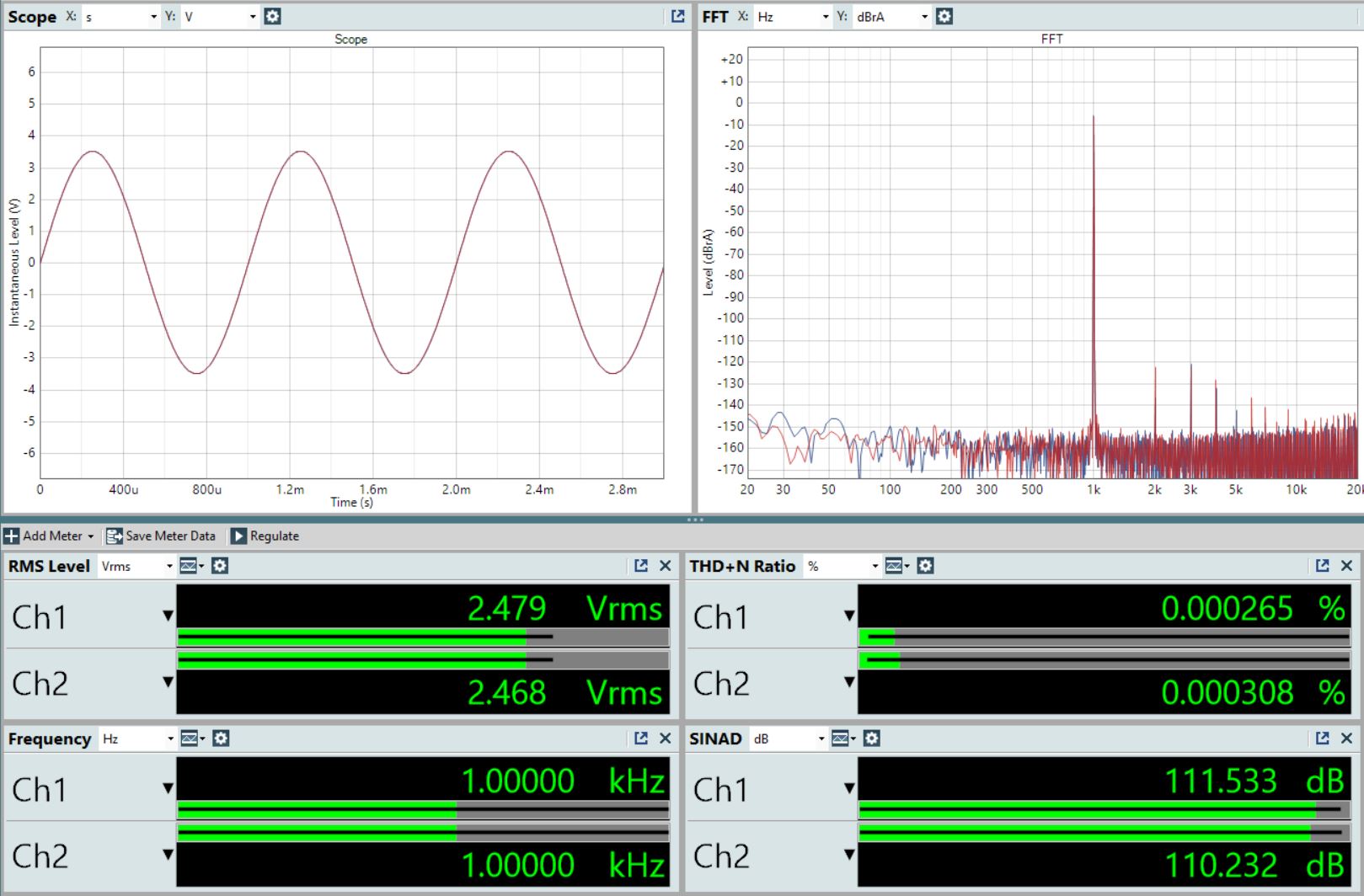

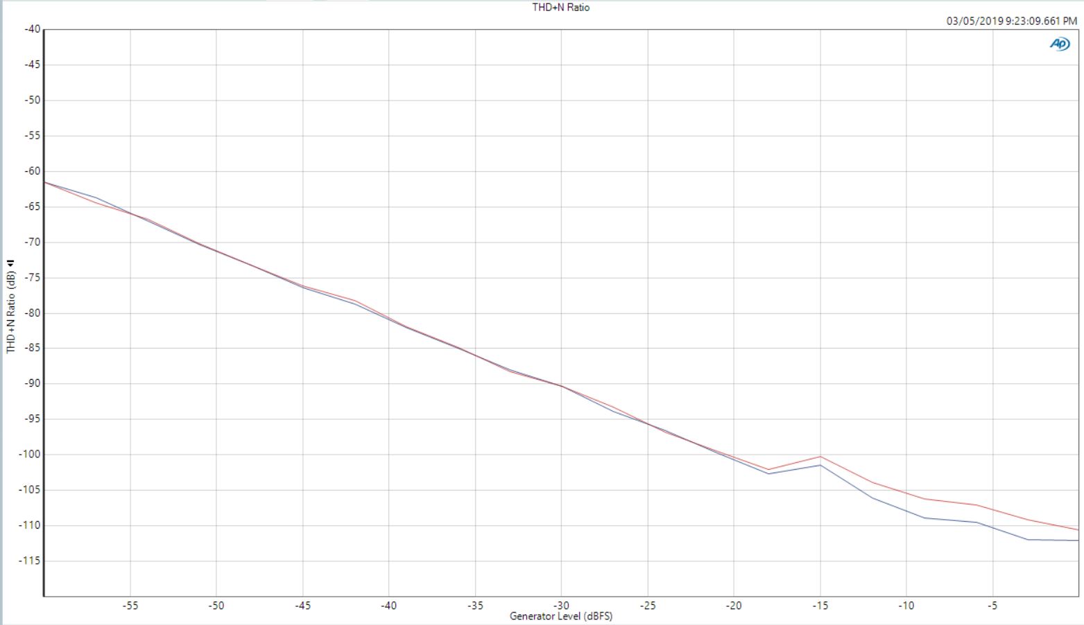

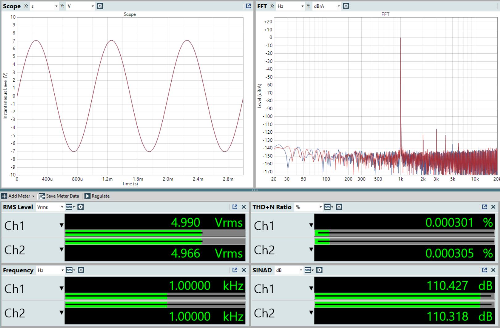

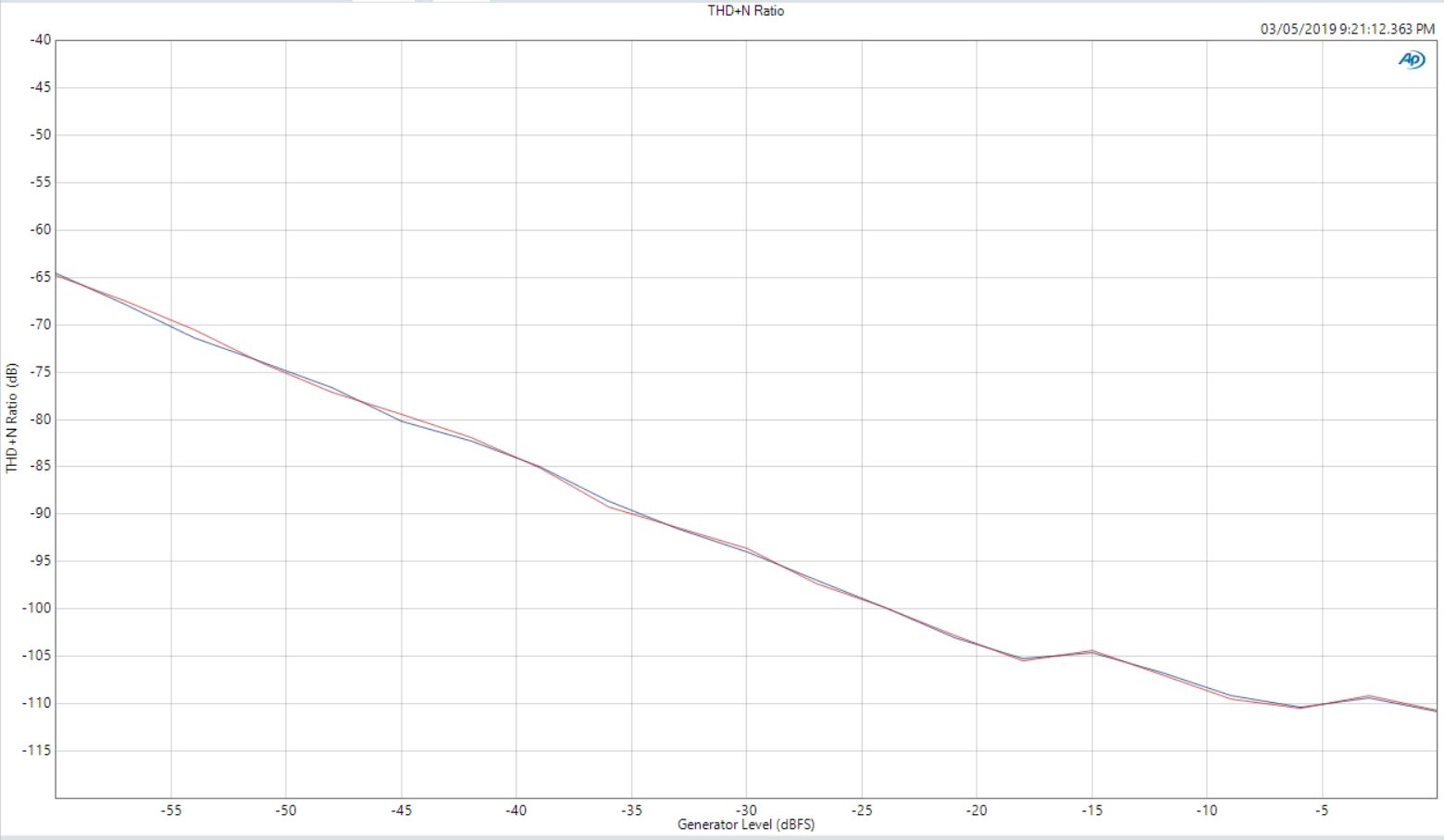

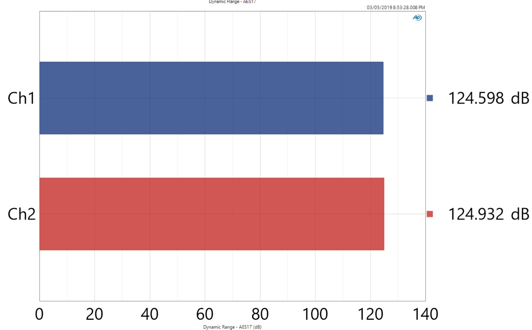

As per previous post... measurements/test results attached.
Half of the images are for single-ended output (2.5V at 0dBFS) and half the images are for the balanced output (5V at 0dBFS).
These measurements are from my PecanPi DAC, I don't see any reason the module will be any different as it uses the same exact parts and layout.
