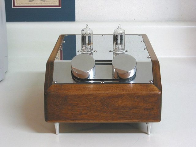

I too wanted a dual set-up for my preamp and I wanted remote volume. I ended up with
[url=https://khozmo.com/index.html]High Quality Audio & Industrial Attenuators and Passive Preamplifiers[/URL]
He has a dual mono set up that the volume of each can be set via the remote and then the volume tracks from there if that makes any sense.
Here is a link to the demonstration video Khozmo sent.
Shared album - Dave Millon - Google Photos
The units are nicer than what is in the video.
Expensive but it works exactly how I want it!
