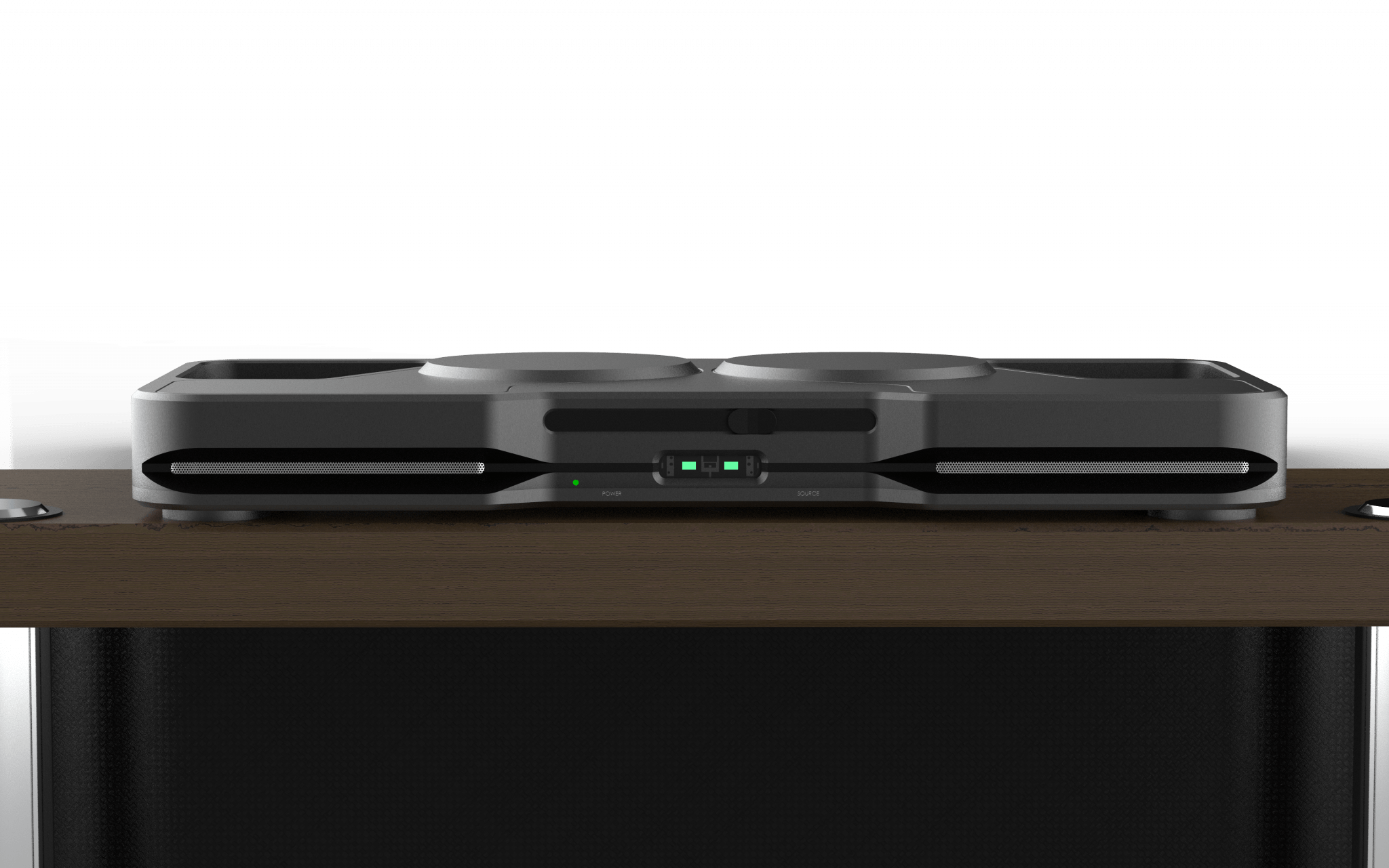

Not all that beefy, 25w classA Pass. What I am trying to do that is somewhat novel is pack a Nutube B1, M2x and dual toroid PSU into a 1U billet aluminum block. Rowland style, if you will. It's taking some pretty extreme fitting but I'm convinced it's doable. However, the PSU is the trickiest space wise and both the amp and preamp circuits will have to totally be reconfigured to deal with that. The long and wide boards won't fit. Here is the concept in its current form...No matter what you decide, I would really like to see the build. I am reading beefy power amp.

Oh dang! Glad you caught that, I was about to place the order lol. Okay, so my original version was about perfect at 160kuF total. Phew 🙂Haze Head:
To be clear, my F6 has 192,000 uF in total power supply capacitance -- 96,000 uF per channel (48,000 per rail). In any event, I like your design -- good luck!
