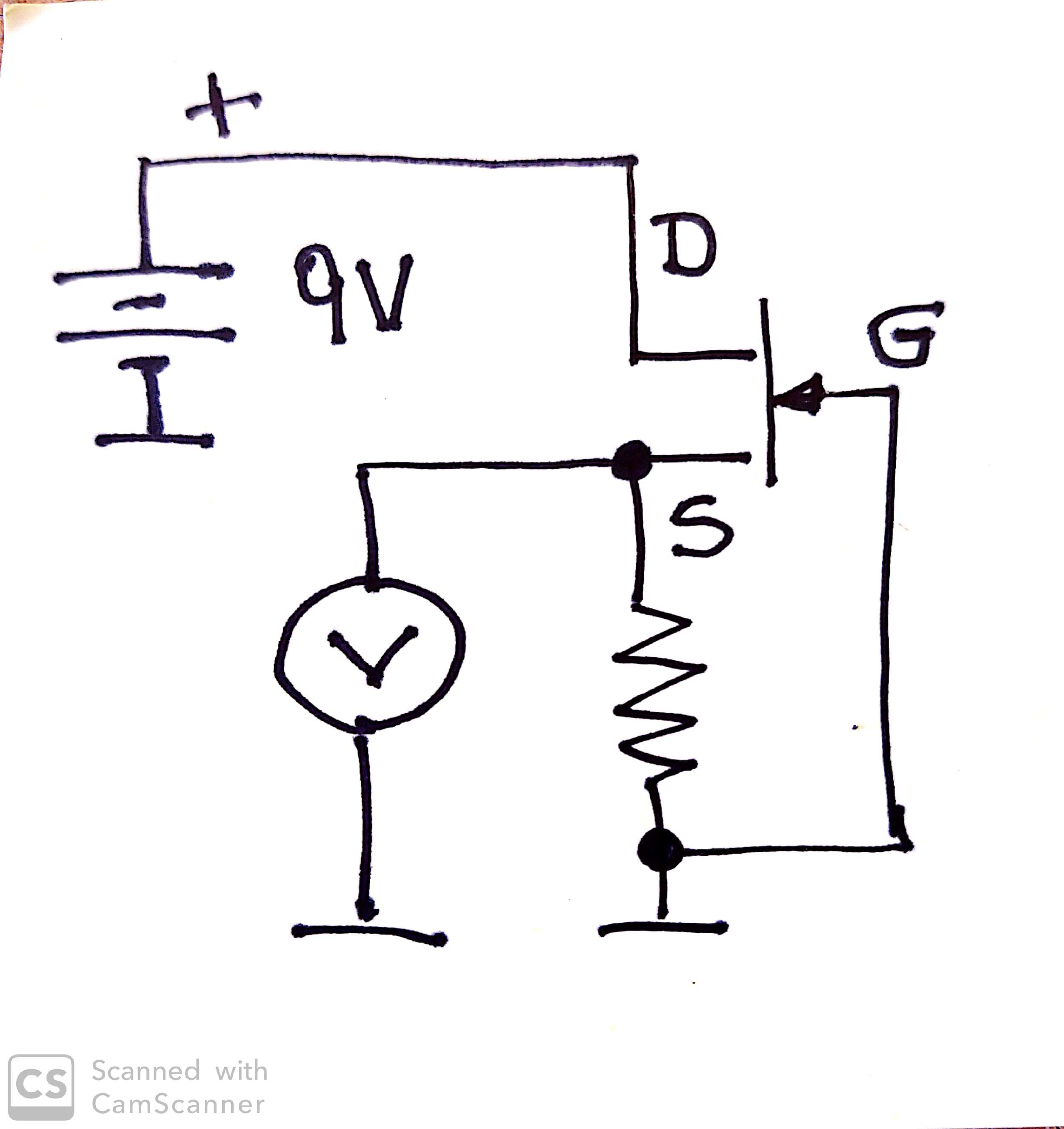

Thank you very much GoatGuy.
I think this picture shows your solution, please correct me if I'm wrong.
I'll will test this guy right away.

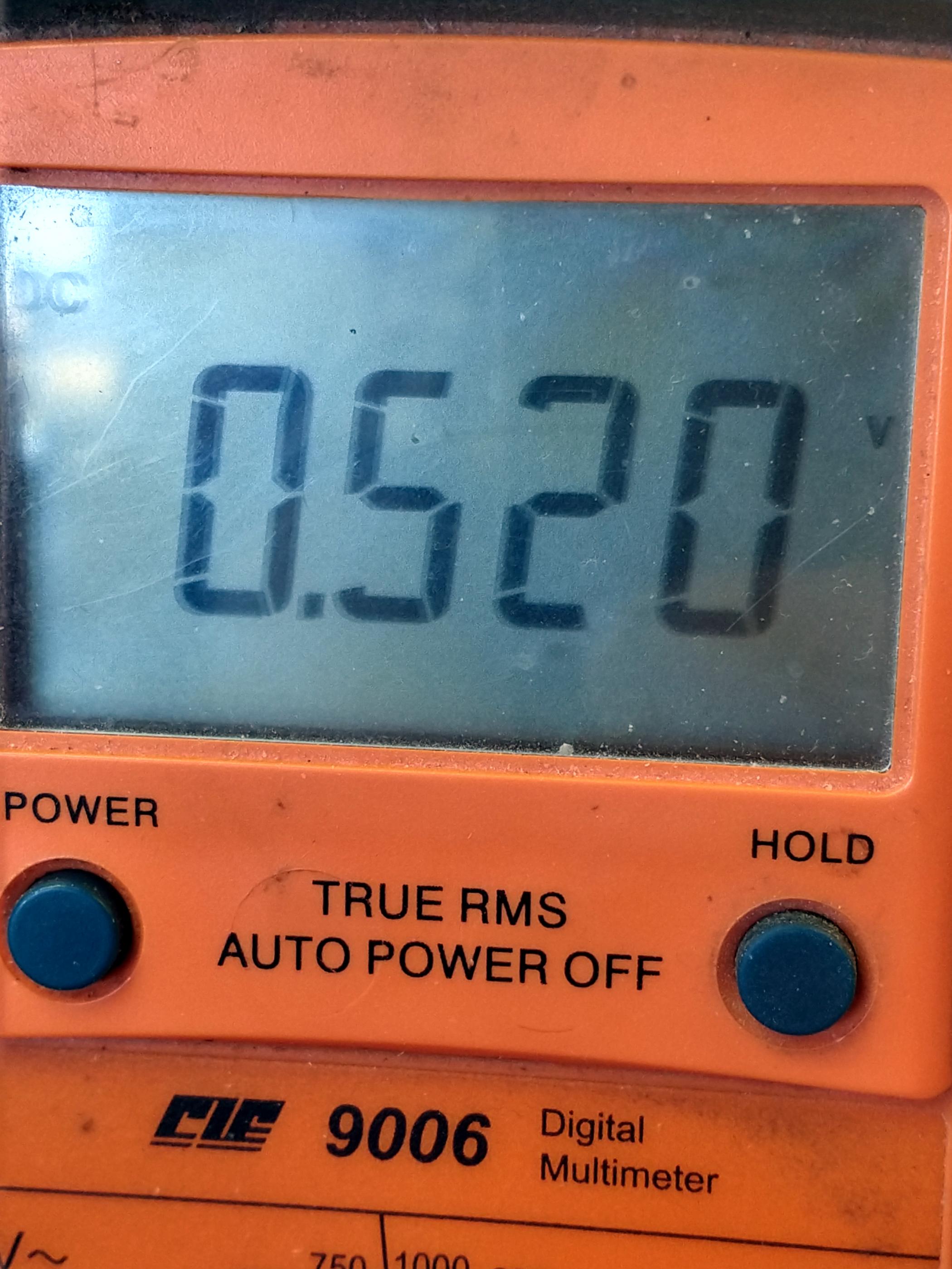

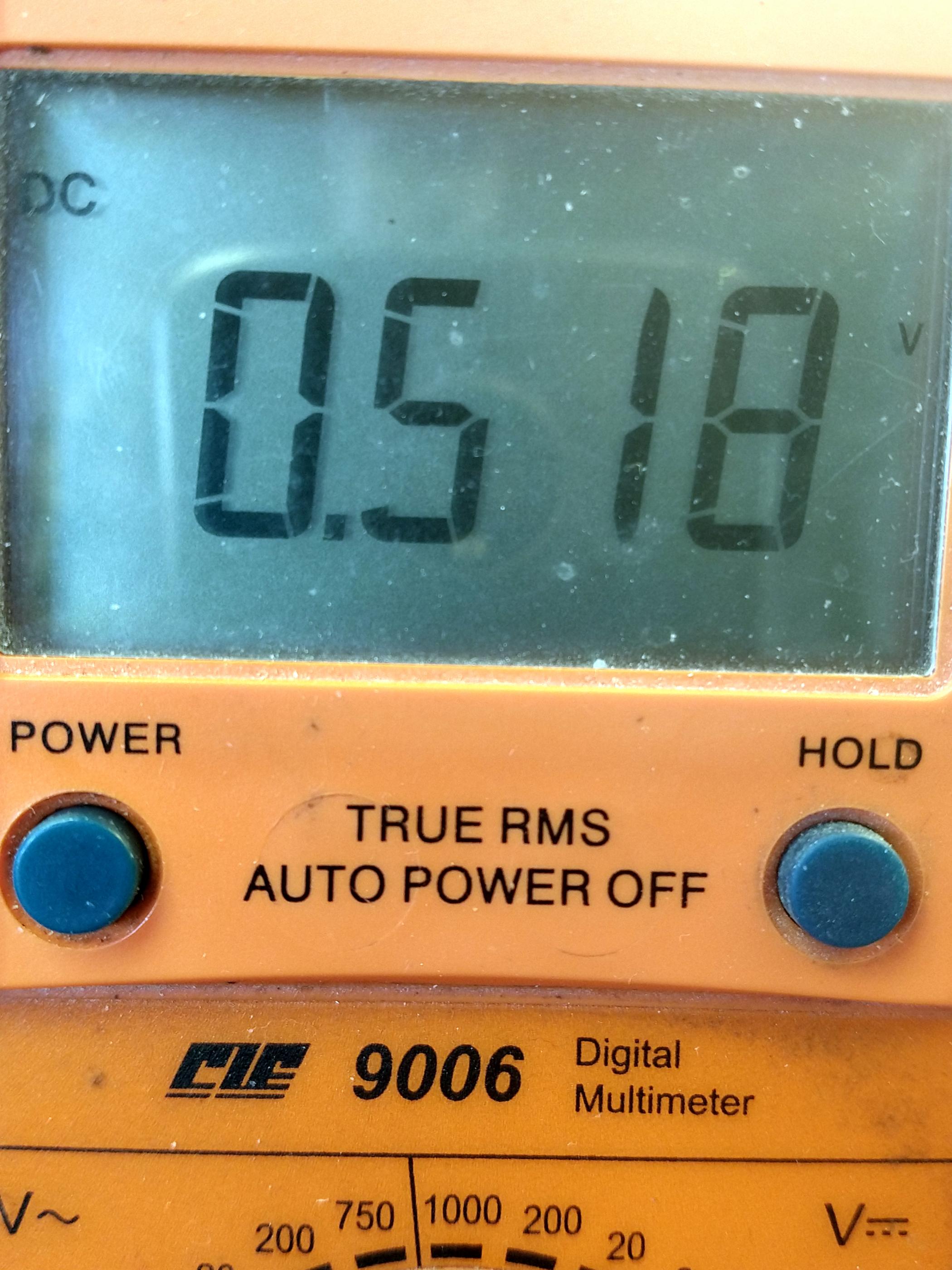

Yap… that's the number. If you have a bunch of the now nearly-obsolete 2N5565's, you could also test 'em all, to see what the nominal range for VRs is. My calculations were educated guesses based on using a lot of JFETs in a lifetime of fiddling around. However, nothing is better than a larger body of statistically significant measurement. Good Luck! ⋅-=≡ GoatGuy ✓ ≡=-⋅

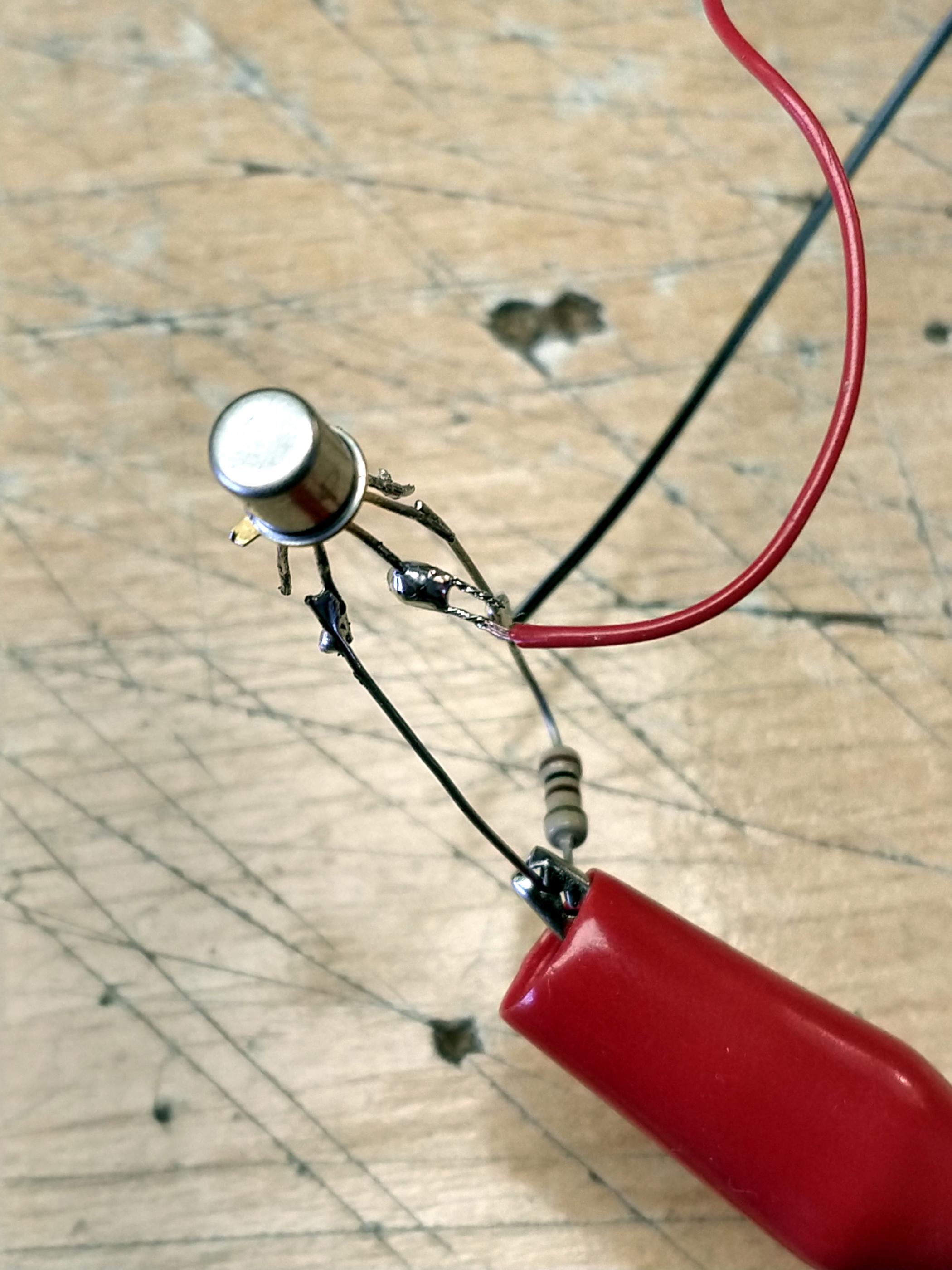

Ohhhhh yessss !😀
I have many of those here in my lab and the price in Argentina is really low $6 to $10 depending on size and quality.
It is just that I had my soldering iron hot and that I pulled out the DJFET from the faulty board one minute before. I straighten the leads and took just one minute to test.
I would have definitely used a protoboard if the device was brand new.
Thank you for the tip !:cheers:
