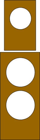

A picture's worth 1,000 words. The top box is the monitor, the bottom box is the subwoofer. I want to make two of these. Each sub would have its own amp. I'm think having the drivers face forward would be better since I want the bass to extend up to 120hz or so.
What do you think?

I'd go for 8's over 6's or 6.5's. It's better to have too much and turn it down, than not have enough and be unable to turn it up.
That being said, I 2nd the idea of having a side firing woofer. I feel it helps clean up the face of your enclosure. It doesn't look so cluttered.

At that frequency, it won't make any difference. Playing 120hz test tones and some a/b testing with left/right speakers, you might be to tell which side of the room it's coming from, but simply having the driver rotated 90° isn't going to make any noticeable difference in real world use.

With an 8 inch driver, it's hard to find one that has the displacement the you would need for a true sub. Your target low FR of 40hz is not as low as most sub builders bemand. If this limit was chosen only because of the driver width, 8in., the you could mount the woofers on the side of the enclosure, the speaker's widest dimension. Some commercial speakers do this. Like you they want the lower, woofer enclosure, you want the face dimension to match that of the top enclosure, which houses the mids and tweeters. With proper bracing, 2 10" woofer would fit.
I'm not exactly sure what is my budget. I have a REL Strata III that I will be selling to fund the project. They are going for around $1,000 these days.
As far as a choosing 40hz as the lower frequency goes... I was trying to be realistic about what I could get from a smaller driver. Although, now I'm considering a side mounted drivers. I have furniture between the speakers, so I'm a little concerned about side-firing woofers. Should I be?
I want the sub enclosure to be around 24" tall the width somewhere between 7 and 9 inches and the depth around 13". Again, these numbers are based upon aesthetics. Maybe going with a single 10" or 12" would be better.

Well that's a little over 1 cubic foot and is plenty big enough to get a 10" in there. Having the driver face into the furniture won't be an issue.

that aurum in post15 needs a vented cab of about 2.5cub ft and Fb=28Hz.
or
1.2cub ft and F-3=46Hz in a sealed box.
neither will get anywhere near a stratus.
