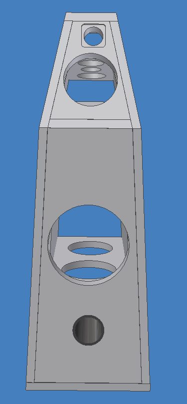

Ok,
I think I have come up with a subwoofer design. It is going to be unusual in that it will look like a large floor standing speaker. It will be in the corner and have two drivers so that I can balance out the bass levels.
THe lower driver will be a Dayton 12 inch DVC in a large volume dual chamber reflex. The upper speaker will be a 10 inch Dayton in an aperiodic enclosure. THe upper speaker should have slightly better transient response and upper bass articulation.
The lower speaker will move more air and really reach down low in the frequency range. I will be able to balance the level of each speaker independently to get the best possible sound.

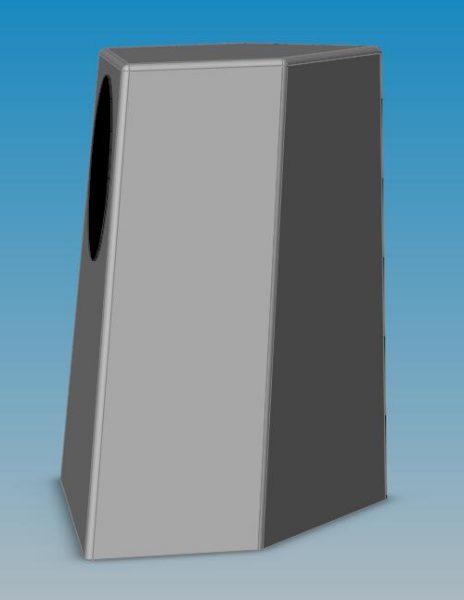

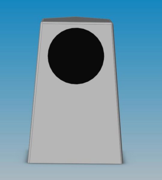

I have changed my mind and come up with a more practical design than the larger two driver tower that I had originally conceived of.
This is what I have come up with for the basic cabinet shape. It is designed to fit snugly in a corner and utilize the corner space for cabinet volume. It also has few parallel walls.
Now that I know the basic shape and size that I am shooting for I will start to build up a more accurate model.

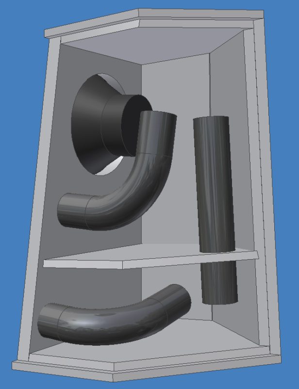

OK guys,
Here is a snapshot of my more developed model. Two of the walls are cut away in this rendering which shows the inner vent arraingment.
I have decided on a tuning frequency of 23 Hz. The butterworth tuning point was about 23.79Hz with a 3.2 cubic foot box. I will have about a 3.5 cubic foot box and a little lower tuning that should work well with the room gain.
At this point I am using three inch vents which are about 18 inches long. I am still going to add more internal bracing and I have some elements of the model to clean up.
WinISD shows about a -3db at around 24Hz and with room gain I should be flat or maybe +1db at around 20Hz.
Hi Hess,
Looks good. Is there a reason why you don't drop down to an 8" woofer for the upper bass? That would be much faster.
-Chris
-Chris
Faster? Let me laugh a bit 🙂
This is only for a subwoofer, it will be perfect with a 12. Deeper bass, louder, less distortion, and same fastness...
He ditched the idea with two woofers.
Hi Chris,
I originally had intended to build the cabinet taller with the 12 inch sub on the bottom and an eight inch up high in a different type of loading.
I guess it seemed too complicated when I first started approaching the cabinet design but there is no reason why I could not do it. At this point if I do decide to build the upper sub cabinet I will build the upper sub in a seperate cabinet that sits on top and has some kind of decoupling barrier.
The only thing is that the upper woofer would be firing into the back of a keyboard rack and I am afraid that it might excite vibrations so until that thing is gone I am going to see if I am happy with just the 12 inch driver.
I am now also going to build some new front full range drivers to replace my front 6.5 inch cheap two-ways. They will have an eight inch vented woofer and a 5.25 midbass as opposed to the current sealed units. The fronts actually sound quite good for how cheap the speakers were. But they don't reach down very far or move much air.
I think the combination with the new front speakers will be sufficient. Because I can have the HT receiver send the sub effects channel to the front speakers also if I want. I will experiment and see if the upper sub is warranted.
