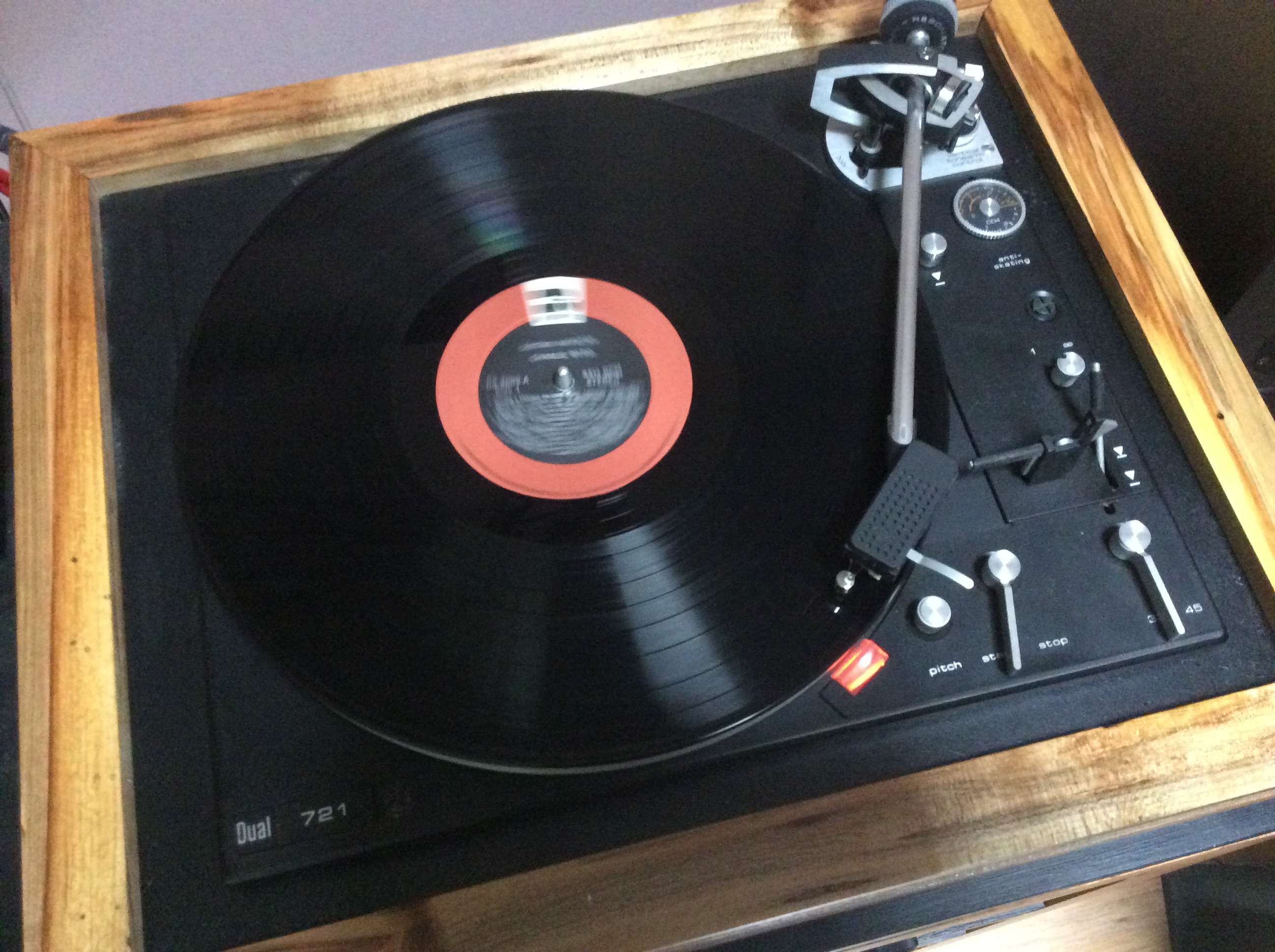

Everything else on the turntable functions beautifully other than the plastic start/stop lever which need to be addressed.
Tracks like a dream, came with a very nice Pickering xv15-1200e cartridge.
It’s uncanny how quiet the auto mechanism is. Makes my 1219 sound like a tractor.
I did away with the plastic base and put it in my recently fabricated
red maple plinth. Now to make a dust cover.

PJ, that wood base is just stunning!
Excellent job, did you make it?
And I like that grooved outer face, makes it stand out.
The mitered corners are my weak spot - I could never get them exact for some reason.
So I use butt jointing when doing a frame. - I need a better table saw blade.

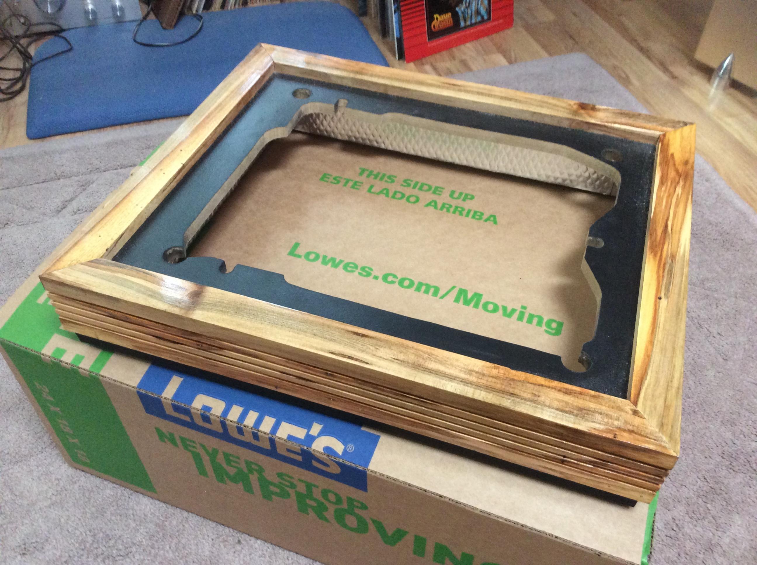

Yes, I made the plinth from a dead red maple tree that I felled last year. I enjoy woodworking and have made several for 1019, 1219, 1249 etc from oak, walnut and cedar. Mitre joints are alway finicky and it takes me a few passes on the table saw to get them perfect.
I find the idler wheel Duals benefit from the heavier base. I put rubberized damping inside this one, planning to use it with my 1219 which is presently residing in a cedar plinth.

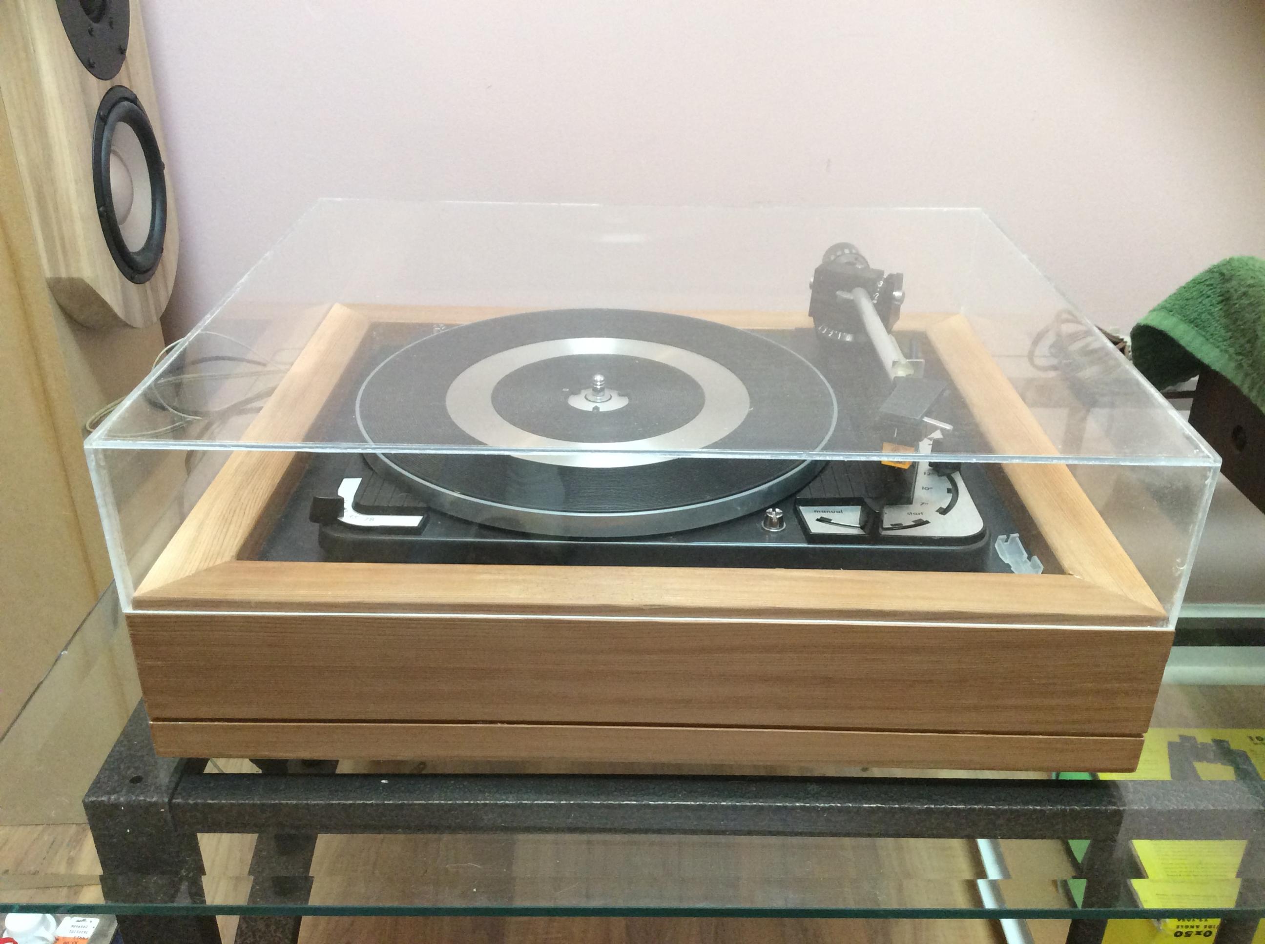

Here’s a picture of my 1009sk in a cedar plinth with my home made dust cover, courtesy of Ace Hardware acrylic sheet and a smidgin of acetone. I’m working on improving my technique on the joints.
The plinths I don’t keep I sell on the auction site, with or without a restorable turntable that I fix up. Most buyers enjoy the distinctive look of a hand built plinth.
PS......acrylic sheet may be hard to source right now due to the demand for protection against the spread of Covid-19.
