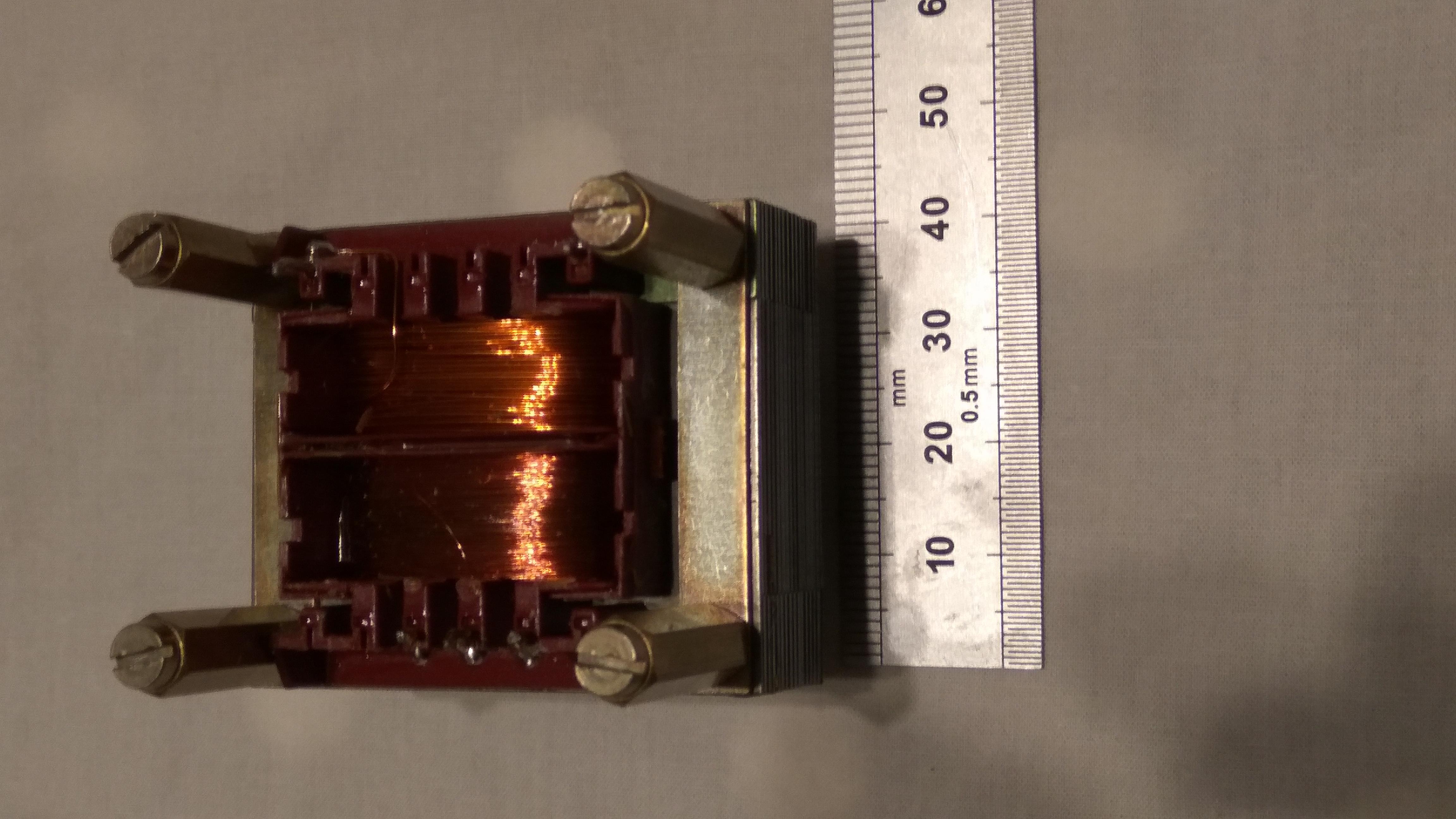

As per title need help with this turntable...
Does someone know where I can get a power transformer for this record player or have one willing to sell ?

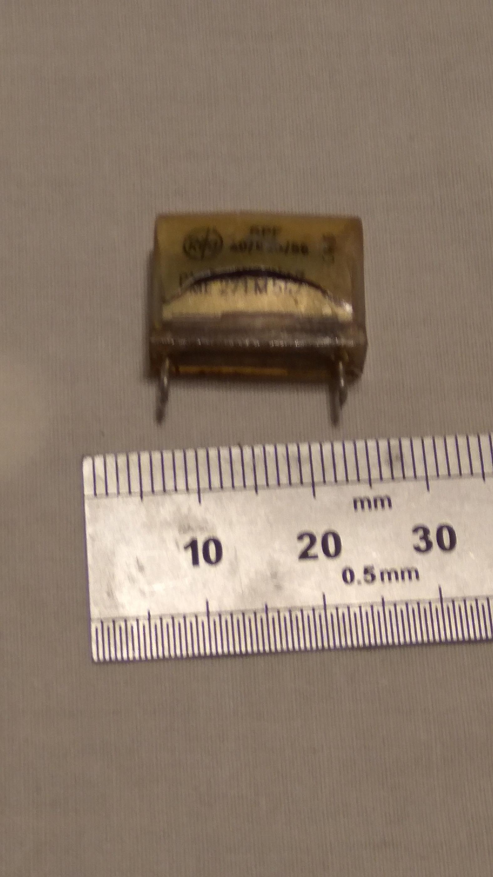

47nf (X2) capacitor shorted and passed 240V to the 110V line and fried it.
Dual P/N 244474 (position 111 in service manual)
0-110-220 - 16.5Vac.

Hi, sorry i was tired yesterday hence the stupid question (I knew it was the trafo)
That transformer is way to big the service manual states 25mA at start up and 15mA running at 220/240V.
The original transformer is +/- 50x40mm with +/-15mm for the lamination.
Also need the 110V leg of the coil for the strobe light.
Thanks people.

EI 50x40 is not the smallest of all transformers.
You can probably find a suitable replacement at the local electronics shop.
Nominal voltage of 15 or 18 may be applicable.

I think you don't need the 110 Vac tap. Replacing C51 in the strobe lamp circuitry by 33 nF should do when connected to 230 Vac. If the neon doesn't get bright enough, go to 47 nF.

I wish you were right with that but the transformer is fried/burned the primary coil is no more and it blows the fuse strait away.
I could "improve" the power supply but would like to keep it original.

Yes, I had understood your tranny is toast. I was just referring to my answer to your request via my PM account where I suggested to use just another PSU without that 110 V tap.
