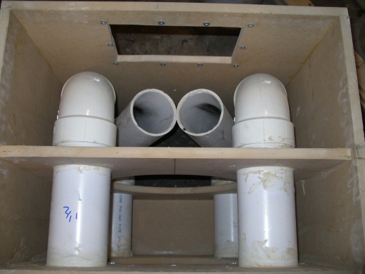

So the box dimensions I've decided on, that I think I can still fit into the cabinet I'm going to build are:
26"L x 20"D x 29.5"H
The Internal dimensions are going to be:
24.5"D x 17"D x 24.5"H
That should give me right around 181L.
Since I'm using 3/4 MDF, 1 divider in the middle of the box, and 2- 3/4 boards on the front so I can flush mount the sub, and be able to flare the ports with a router.
To keep air velocity under 20 m/s I need 3- 4" ports that are 10", which would have to be doubled to 6 for the other sub.
No way am I going to spend $13x6 = $80 on port tubes when I can make them look just as nice with PVC.
One question, when adding multiple tubes the lengh in winISD is multiplied by the number of ports, so I divide that to get the length per port right?

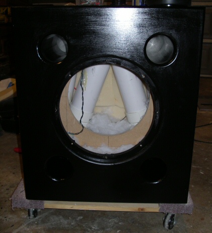

As I was typing this, one of the speakers showed up a day early. 🙂 It's big alright. If you guys see any problems or have any suggestions for me, please let me know. Thanks for the help so far. . .

30 ms at 20 Hz isn't that bad.
You don't divide by the number of ports. WinISD reports the correct length for each port. One 4" port will tune to a certain frequency. Two ports will need to be ~twice as long to tune at the same frequency because the air mass spring is less strong.
You could use two full length precision port 4" to get a 23 Hz tuning in your 181 liters box. That would be a nice compromise.

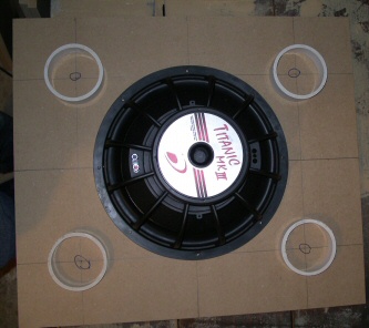

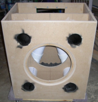

I thought I would post my measurments in case somebody wanted to try and build this. Here they are for 1 sub:
Front/Back: 26"x29.5"
Internal: 24.5"x28"
Top/Bottom: 19"x24.5"
Sides: 29.5"x19"

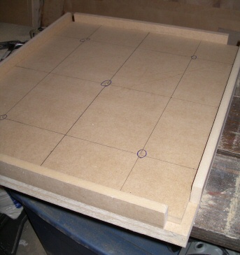

You need 2 of each of the above. I made 4 of each for my 2 boxes and did it with 4 sheets of 3/4 MDF.
I test fit one of the boxes with corner clamps to ensure everything was ok, and then started to layout the speaker and ports. I decided to put the speaker in the center and ports in the 4 corners.
Then I stacked 3 board together and lined them up with some scraps. That way I could drill the holes for the circle jig, and they should line up perfectly when I assymble the box. I think this is better than trying to measure each board because they will vary slightly. Anyway, I used a centerpunch to start the drill bit correctly, and I used an attachment on my drill that almost creates a mini drill press, so I'm sure to get 90 degree angles on all the holes.
I drilled 3 at a time (drill bit depth limitation) and then used the top one to redrill other boards for the second box.

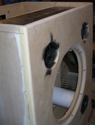

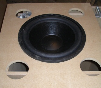

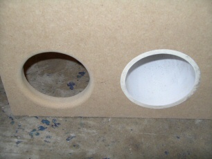

Ports
Now, on the ports I have a couple of questions.:
1. Where do I measure a flared port? from the middle of the flare or the very end?
2. Do 90 degree turns in the port tube change anything? It should add some resistance to the flow, with is similar to what extending the length would do.
3. Should they all be exactly the same length? If I can make 2 of them longer than the other two, should I do it?
Here's how I'm making my flares. The hole on the right is what the front will look like. It's cut to exactly match the inner diameter of the 4" pipe. The other one actually has the pipe in it. So my plan is to do the front plate like the hole on the left, then the 3/4 right behind that will be on the right, and the brace in the center of the box will also hold the pipe in place.

NP Chops. Yea, it's comming along. I'm tied up this weekend, progress will have to wait till next week unfortunately.
As for the tuning frequency, I don't know yet. The number one design goal is to build speakers that can dissapear into the furniture. That way I don't have big speakers showing, and my hottie girlfriend sill comes to see me. 🙂
I got the port length wrong, so I get to correct that now, but I couldn't have changed the box dimensions anyway. They are as large as I could make them.
With right turns the ports should be in the 30-40" range, which should give me a velocity of 16m/s (with 4), crosses -3db at 21Hz, and 0db at 27Hz on the transfer function graph. How exactly do I read tuning frequency from the graphs? Is it the -3db point?
Cone excersion doesn't cross x-max until about 18hz, and I plan on using some kind of high pass filter.

I woked on the box yesterday, and got it assymbled. I started with the 2 front poards and used the short pieces of pipe for the ports to line everything up. Then I used my finish nailer to hold them together so I could attach the sides and bottom.
Then I put the middle piece in and added the pipes. I decided on about 8" of space in the first compartment. I plan on putting some kind of steel in the box to help with magnetic shielding. I'm going to have 2 of these sitting on either side of a computer, so It's a concern. I haven't put the top on so I can slide the plates into place.
Box tuning came out to 25 Hz, as I was only able to get about 30 inches of pipe to fit. I may be getting port noise because of the close proximity of the ports to the walls. It sounds like a bird flapping it's wings, and only starts at low (<30Hz) frequencies. I'm thinking some stuffing or sound absorbing material might help.
I tested it out yesterday by putting the top on, and then adding about 100lbs of weights on top. This thing rocks! It was loud from the mailbox. I found 2 lightfixtures that needed tightening. It rattles the couch like it has a bass shaker on it.
That's just with one! So adding the second should give me a higher SPL with a lower volume right?

It's Finished!
Well, I got the box done today. I could have spent more time with wood filler on the edges. However, It's going to be sitting in a cabinet behind speaker cloth, so it's not that important.
I needed to add shielding to the box, because it interfears with my old school TV, and I'm concerned when I do the projector and have a computer sitting next to it. I checked sheet metal prices, and it would have easily added another 80 bucks to the project.
So I wene to the city's transfer station, and found an old stainless steel grill or something. Anyway, I took it apart and cut the shapes I needed. It worked perfectly and it was free. The picture shows the strip on the top, and one on the side. I later put a screw into the side with 2 wires running back to the amp where I grounded on the backplate.
I went to wallmart and got foam and polyfill. The picture shows How much I used. Any thoughts on more or less you guys have would be welcome. The wire running back is to ground the metal shielding. I used a hot glue gun to glue it to anything it was close to, and might therefore cause a rattle.
