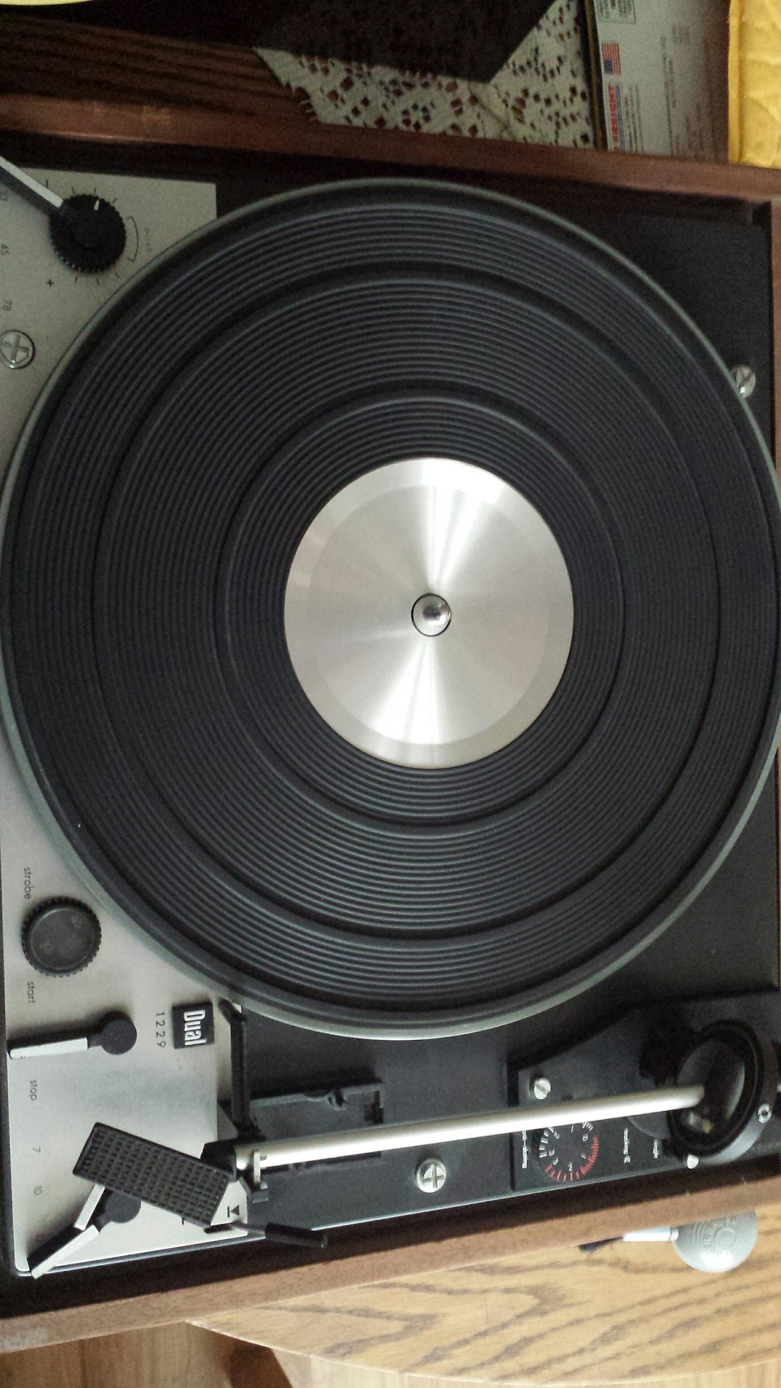

I just picked up a Dual 1229 that is mechanically good and could do with a little TLC.
Anyone familiar with the little attachment on the deck just behind the tonearm support? It is not screwed onto the deck, and looks like there may be a couple of 1/16" thick adhesive pads attaching it. I am not familiar with Dual products-this is my first, and I have not seen one of these things on any other 1229s.
Peter
Peter

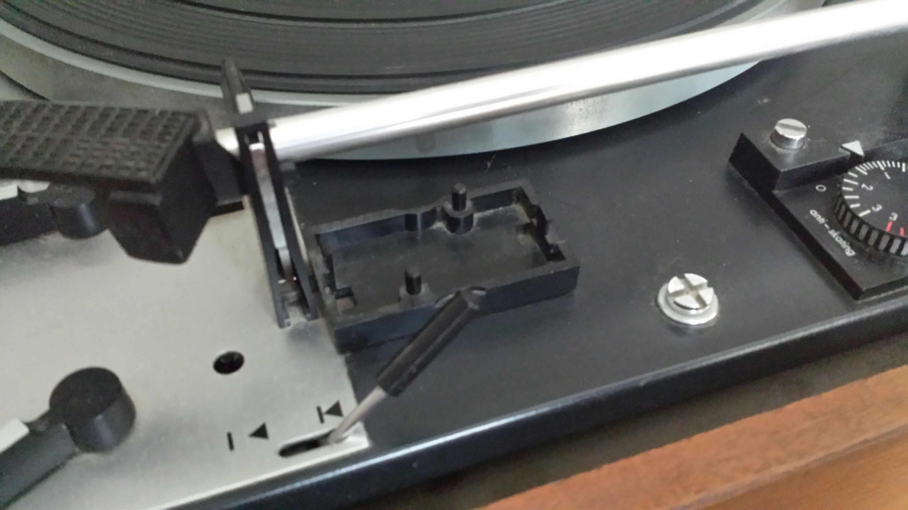

It's some kind of third party product, like a stylus brush, etc.
Just move the arm out of the way and pull it off. It's held on by adhesive pads.
My dad had one of these tables until quite recently and this is something someone added. I second the notion to remove.

Be sure to remove the headshell before you start working on this.
I have owned a Dual 1229, 1229Q, 601 and 701 (still here). None of them had that. I agree with the guesses of it being an after-market accessory.
I would warm it up with a heat gun or hairdryer to soften the adhesive and make it easier to remove.

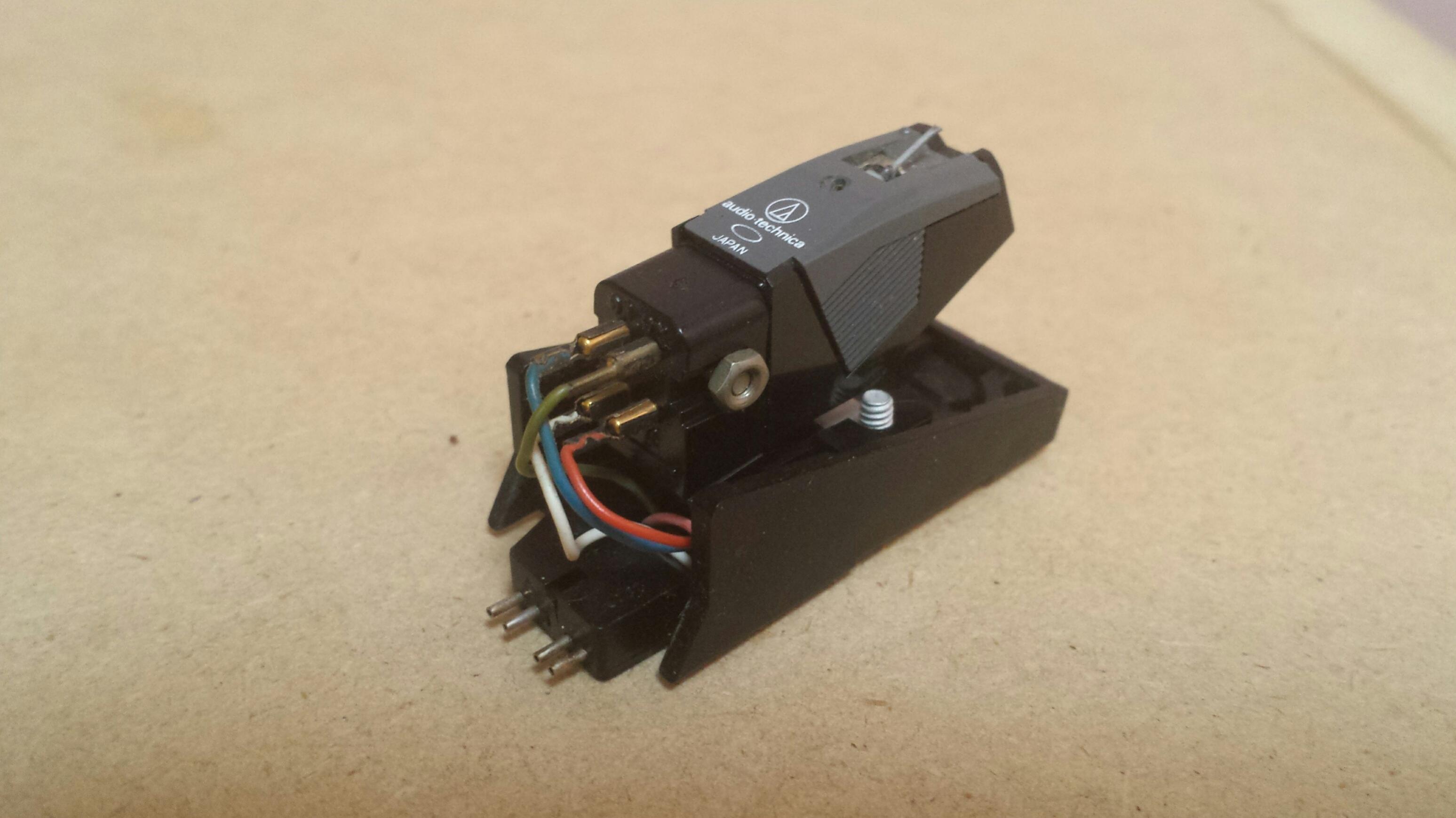

Btw, at least according to your pics your 1229 lacks the proprietary Dual TK14 cartridge adaptor which is a black plastic thing that carries the cart and needs to be attached to the headshell by two 45 degrees' moves (first backward, second forward) of the small handle. Here's a picture showing two Shure M75's sitting on Dual TK's. The left one is the TK14 the 1229 originally came with. But the right one, a TK24, will also fit and still can be purchased as NOS from specialized vendors:
You really don't need to dissasselble the empty headshell prior to removing your strange thing. Instead, I'd strongly advice you not to try it, as this means some real challenge.

Here is a picture of the cartridge carrier that came with it, with an AT TM7 mounted.
