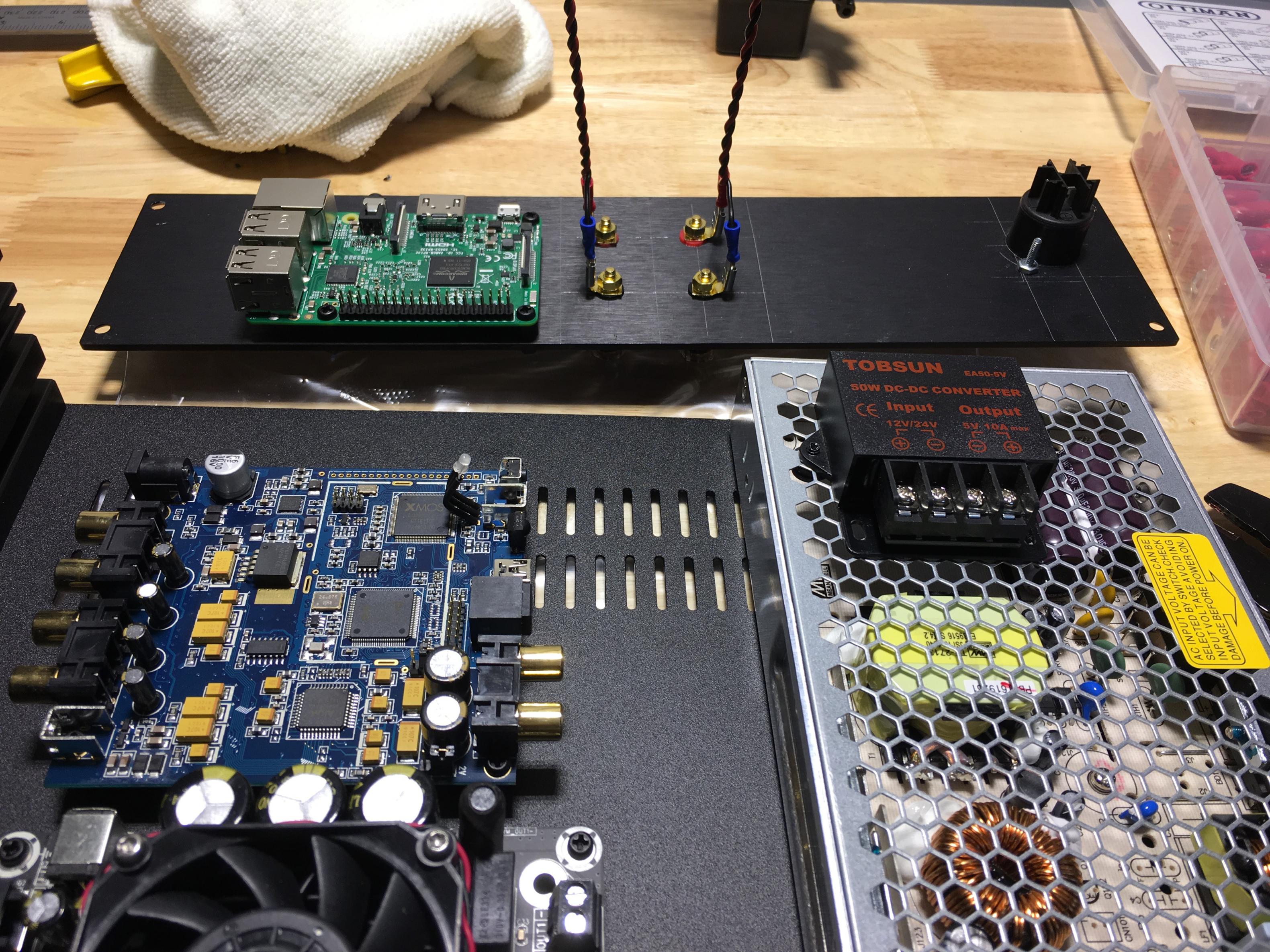

Update and pic dump:
- Most assembly complete, now down to wiring, then programming.
- I still need to figure out how to address the RCA cabling. Rather than use the jacks, it seems I could desolder and run star quad cable between pins... anybody done that on these boards, or should I just use right-angle RCA to save trouble?
- I'm going to need to do something to prevent the power-on thump of DSP board. This might be a manual solution for now, then a 555 IC or something later.
