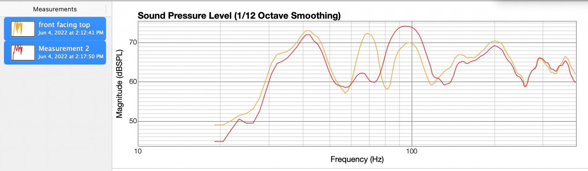

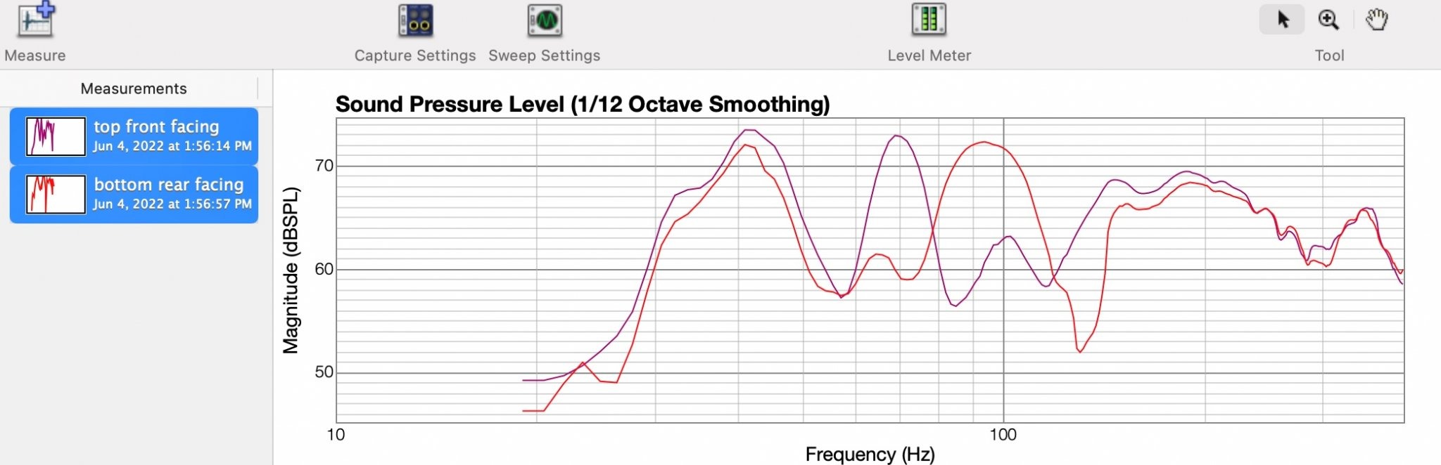

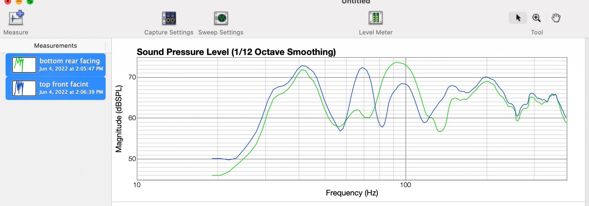

I already did some rudimentary testing of this concept. I have 2 M-Audio BX subwoofers, and I stacked them on top of each other, with the bottom speaker facing the rear and the top facing the front. The height of the two subs stacked was 34". I also added spacers to get 41", and again raised it to match the Genelec's 43" height. This test is NOT meant to represent what Genelec's product does, but it is intended to see how much of an effect this unique speaker alignment makes.
I found that the 34" height showed the most difference in room nodes, in my very not good room. (The subs were spaced ~32" from the wall.) The effect seemed to diminish with height, but I expect it begins increasing again at a certain height.
I also found that it works for a limited frequency range, between 60hz and 200hz. The response curve above and below were identical in all tests.

Measurements via FuzzMeasure:
34" stack
41" stack
43" stack

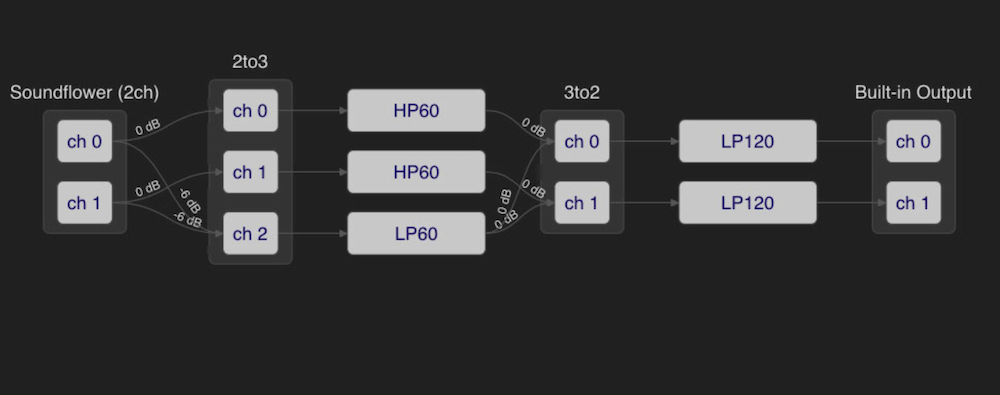

Mini DSP or DSP0408 are pretty limited in their process flows. Though I think they both have digital delay, like WhiteDragon mentions. There are more flexible DSP alternatives if you really want to sum portions of a channel. You could do a 2 channel XO at 60 Hz, sum the 2 LF channels (and reduce by 6 dB) so it was a mono channel, and then add the result back into your HF Left and right.
You could do that sort of thing in software with Max / MSP, as long as you have a computer and the audio ins and outs in sufficient quantity. There are probably other packages to do it also, but Max is the one I know.

Thanks for the responses!
Yes, I agree it is a rabbit whole. But what a rabbit hole! 🙂
And to the original point I was asking about, it is what I was stuck on at the moment, but I'm realizing that it's probably a non-issue. Mdpaudio's comment is a workable solution, but now I found an off the shelf solutions in pro audio. And with some help from the internet I could make my own if I really want to.
https://www.bhphotovideo.com/c/product/333330-REG/Galaxy_Audio_JIB_C_JIB_C_Jack_In_The.html
I mentioned the MiniDSP 4x10, which I think is ideal for integrating all the components. At the moment I am expecting to use 8 channels. The break down:
(Left Main) + (Left LF 1) + (Left LF 2) + (Mono Sub 1)*
(Right Main) + (Right LF 1) + (Right LF 2) + (Mono Sub 2)*
* LF 2 and Mono Sub signals will be combined into a single signal after the DSP as discussed above
