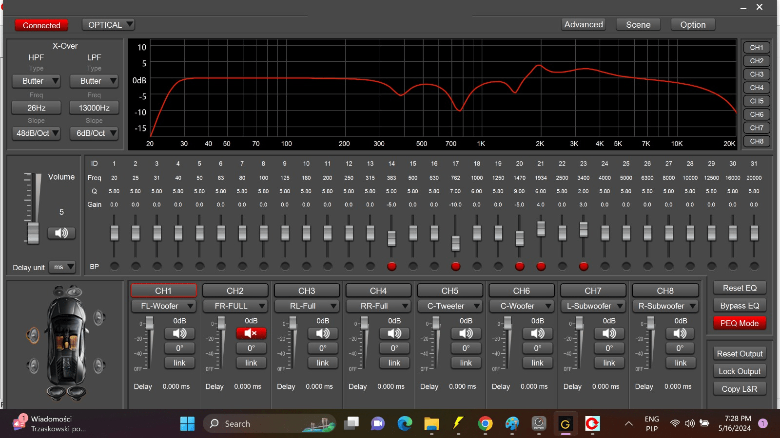

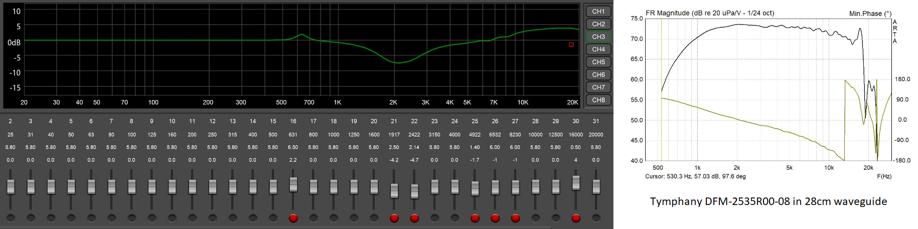

Trying to learn DSP crossover when you have only GEQ. Waveguide plus midwoofer crossed at ~2kHz:
  • how to calculate a god HF lift?
  • use nearfield plus lets say 1 meter measurements?
  • no autotune in eg REW? all manually by trial and error?
  • what about step response and tweeter delay?
  • better use low order and match acoustic slopes?
  • Bessel, Butter, Linkwitz slopes for crossover 6-48dB
The fastest method.
Example hardware:
it has autotune build in but I think it will not work.

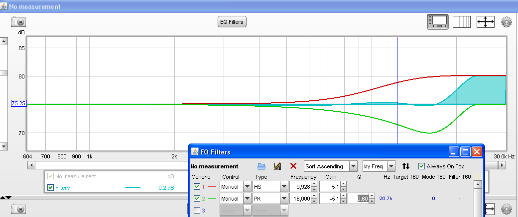

What are you trying ? Is it crossover filtering or speaker/room compensation ?
Your picture shows Parametric EQ. I assume GEQ is graphic EQ, where only the gain is adjustable with fixed Q-factor and frequencies, often spaced sub-multiples of an octave apart. For a GEQ to be successful, the number of bands needs to be high, for example the common one-third octave GEQ is 31 or 32 bands across.
Reactions: krivium
I think most software (like REW) can output a list of PEQ (generic) that you need to dial into your processor. However, PEQ is mostly used for speaker tuning. For crossover, the regular HP / LP / BP / AP filters are used.
With GEQ, again the frequency bands are fixed, so what's the point ?
