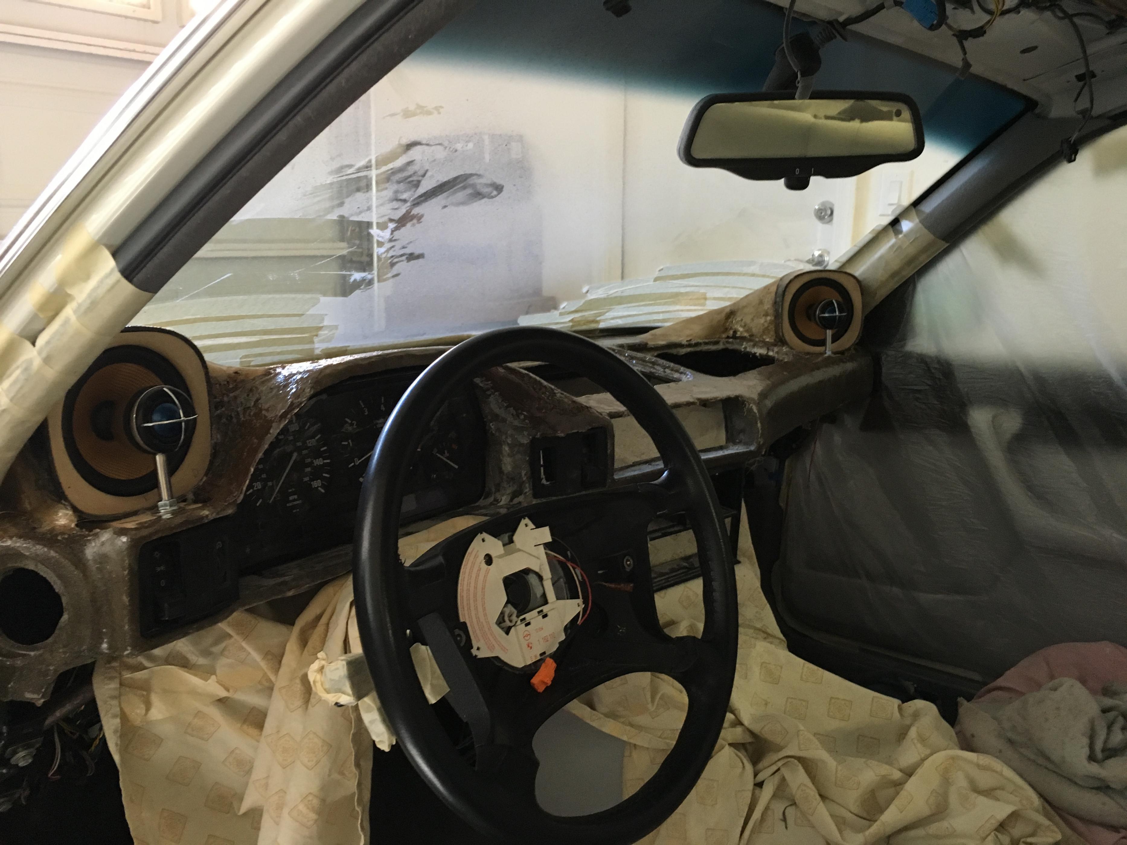

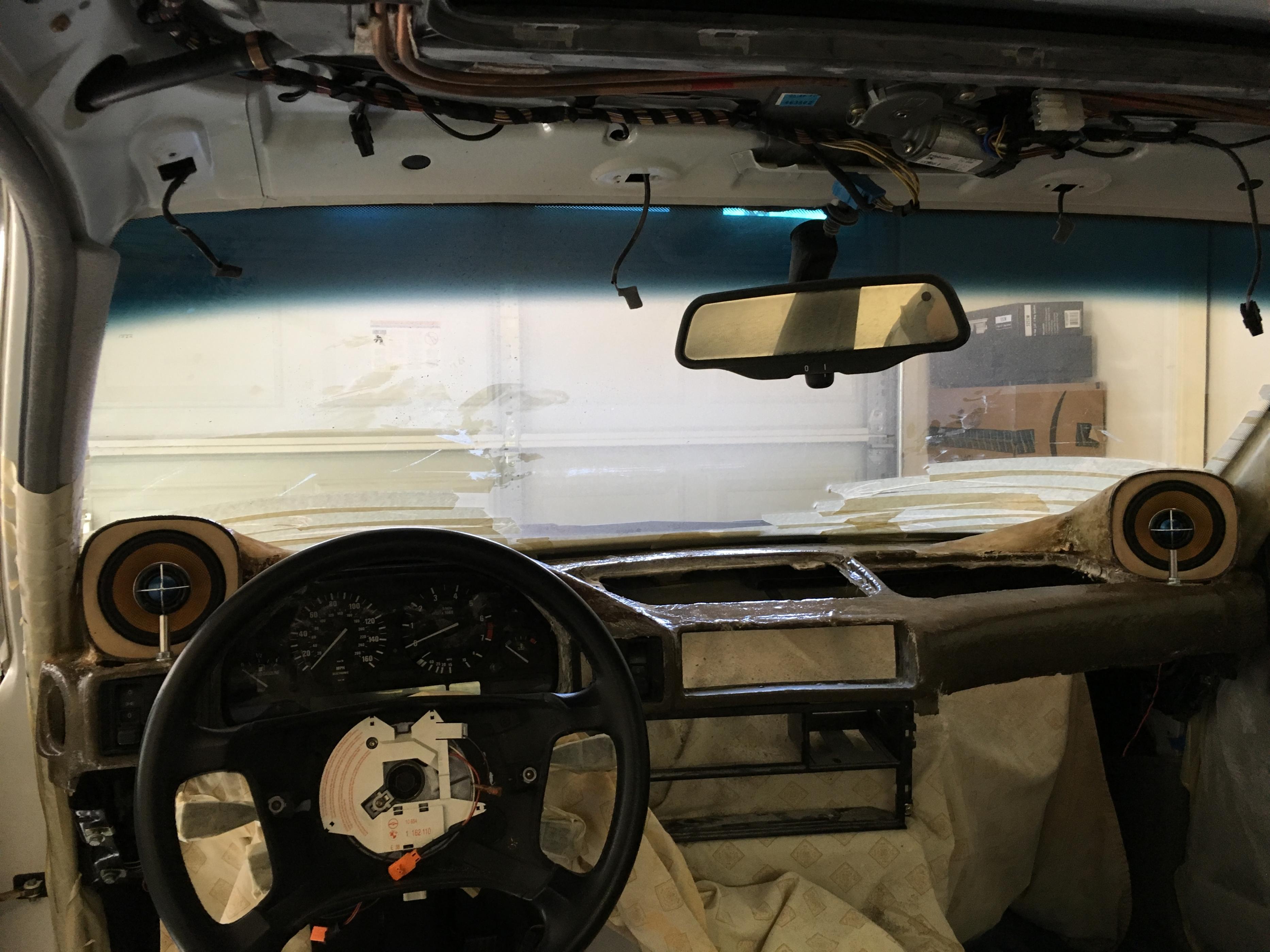

Thanks again for the response, fellas. My overall goal is to be able to have the highest resolution, but also will require some processing. The configuration is a bit unique and since you both have a high level of understanding, I will explain a bit further. Again, I truly appreciate your input here.
I spent about 20 year in 12v retail and was an avid competitor for about 10 years, a few of world finals trophies under my belt, but hi res is all new to me. I have heard it, and I want it. Back "in the day", I heard all the top car, which I believe rival most anything out there today, from what I have seen. Of all the great systems, there was one that was in a different class, IMO. That car was owned by Earl Zausmer. Earl Zausmer - 1994 BMW 540 - 1995 CA&E. I knew some day I would have "that sound". The car I am building is the same body style (BMW E34), and I am building the system much the same way, but with some improvements. Earl and I are now very good friends, and he is assisting with the design. I am using the same mid/tweeters (which took me the past 10 years to find). At this point, I am working on the dash, see pics attached.
My goal is 30 band EQ (w/memories), TA and active 3 way x-over.
I realize what each of you are saying regarding the Helix, and the strength of the processing. Perhaps the only way to know which is best is to test both options. Thanks again.

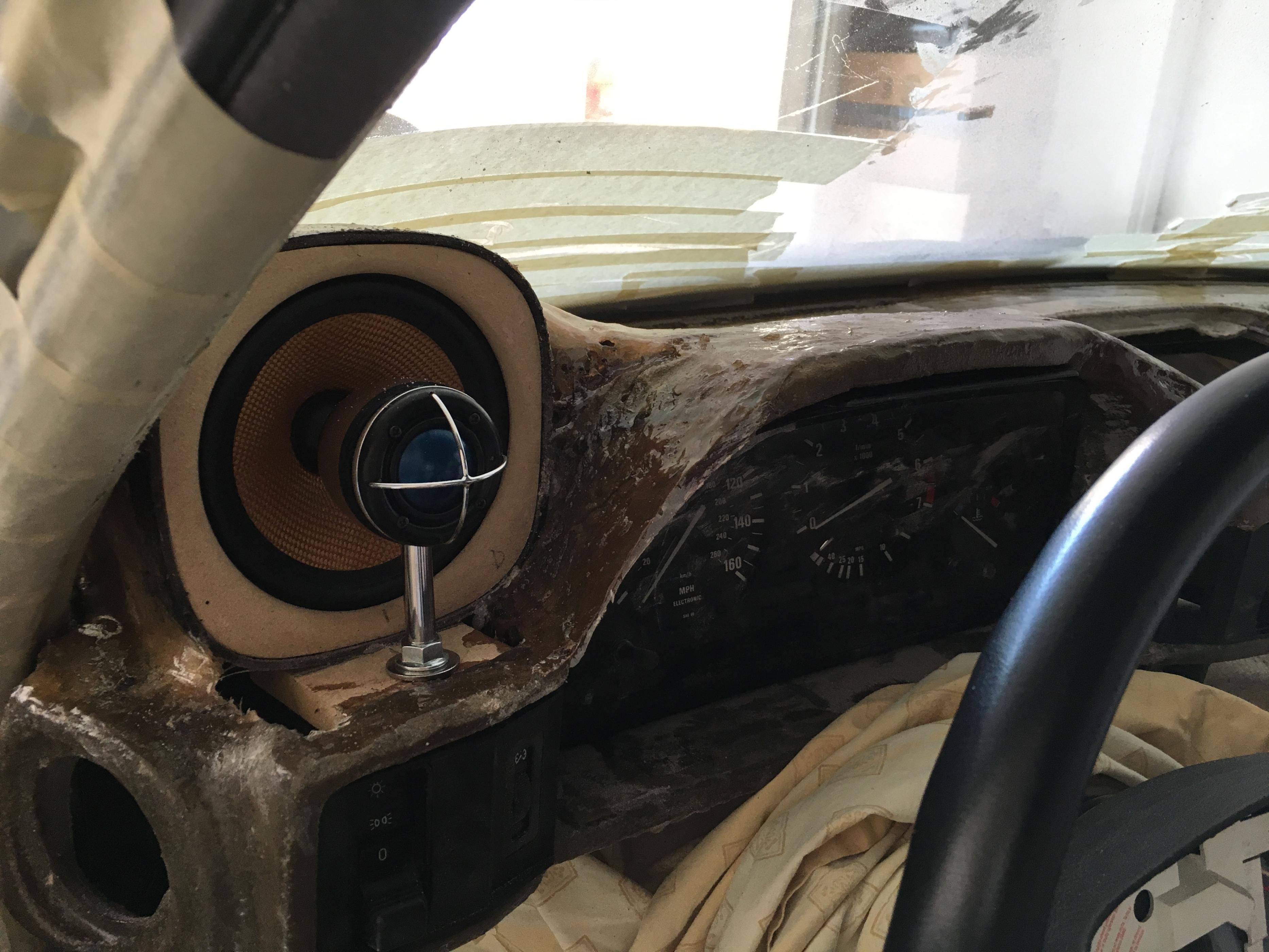

Wow! That looks like some awesome fiberglass work. And great choice on the B&W drivers! Yeah, the Silver Signature drivers are rare and really hard to find. I actually use B&W Diamond series here for my home theater speakers. They have an excellent full-bodied midrange.

Thank you very much for the compliment. The dash is very rough in those pics, I have been filling/sanding since. The combination of the B&W drivers and Milbert amps is amazing. Very warm, detailed, full with amazing dynamics, especially with the driver placement. I find the on axis greatly reduced reflections and preserves the sound. As you can see, the drivers are positioned directly at the driver's ears (with a laser pointer), hence the need for delay.
