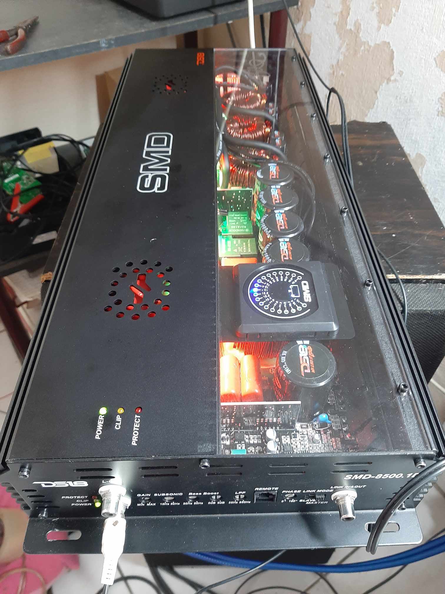

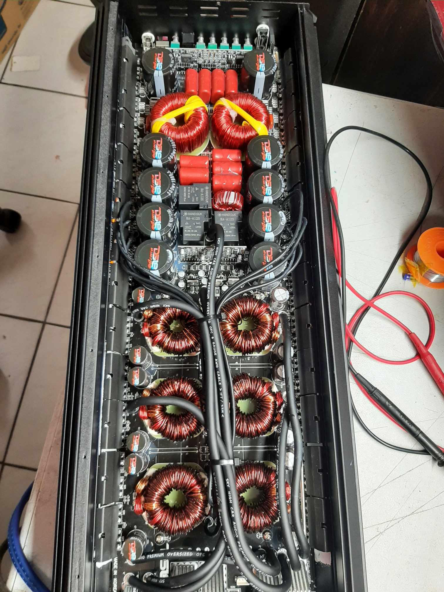

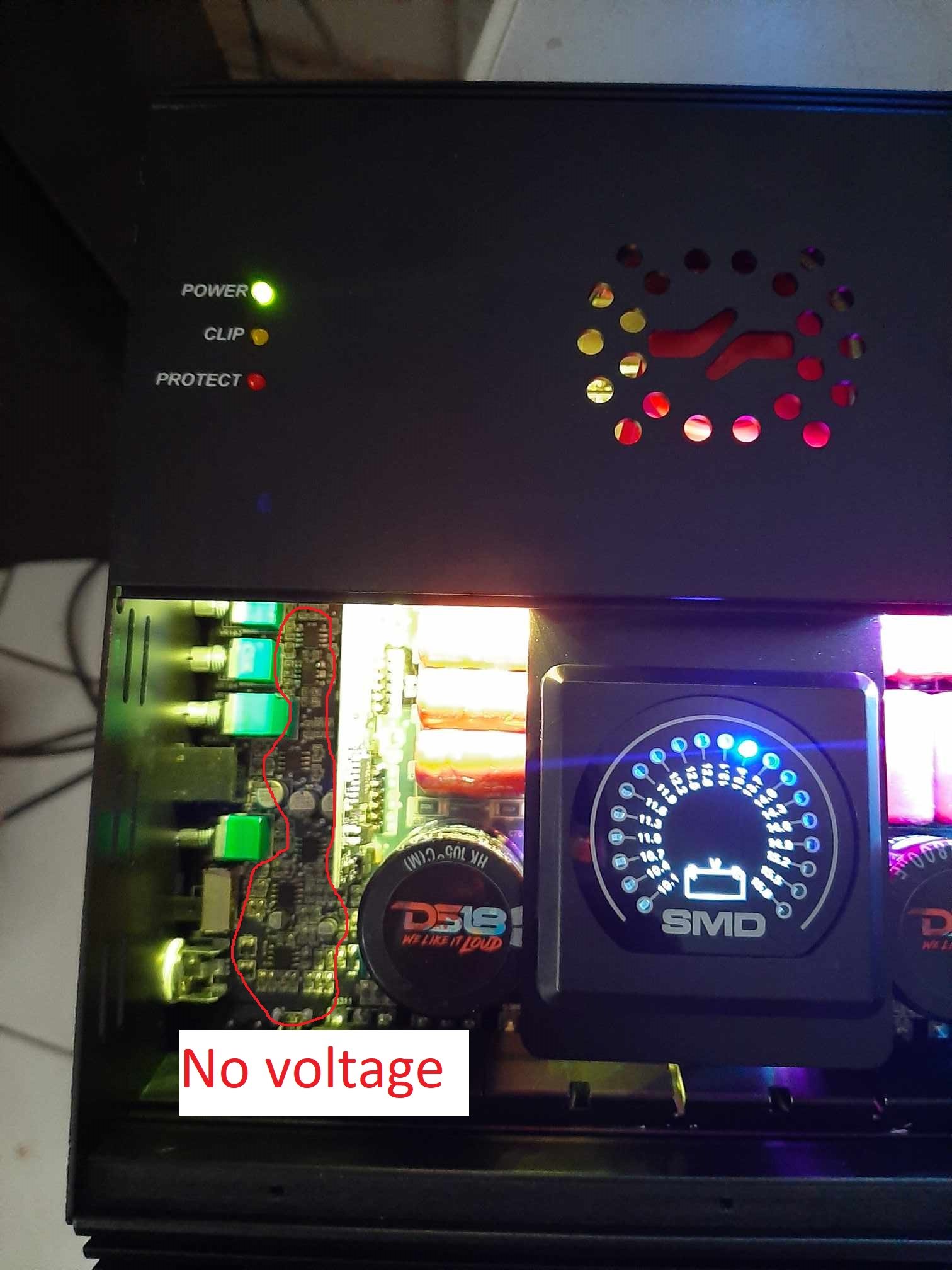

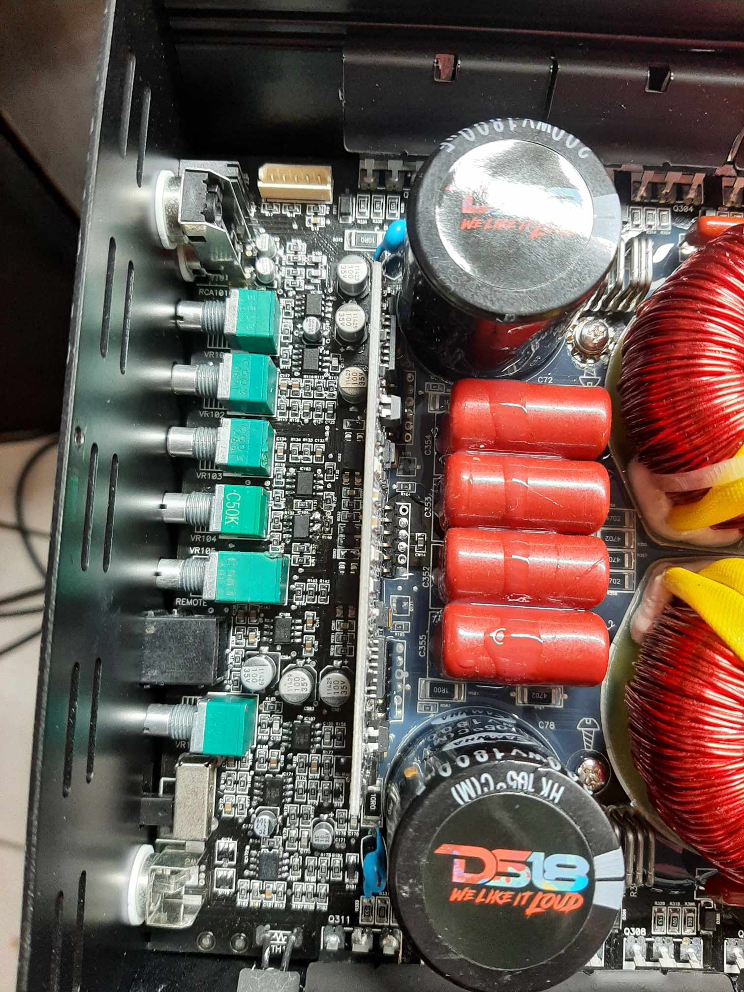

Hello,
I have a problem with this amplifier. It powers on fine, doesn't go into protection mode, but there's no sound output.
I measured and noticed that there is no symmetrical power supply to the TL072, The rail voltage is at 190V.
Any idea where the problem could come from? Where are the regulators located?
Thanks.
