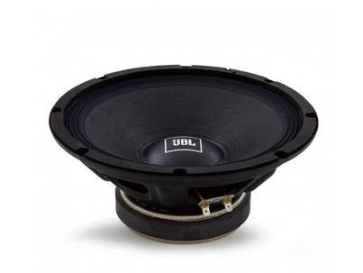

I'll try to explain myself better guys I was told that for a 3-way sound system it would be better to place a dry cone or mid-bass woofer as a woofer in a sealed cabinet, as they say in my country.
It would be a woofer like this without that rubber sticking out like my midrange

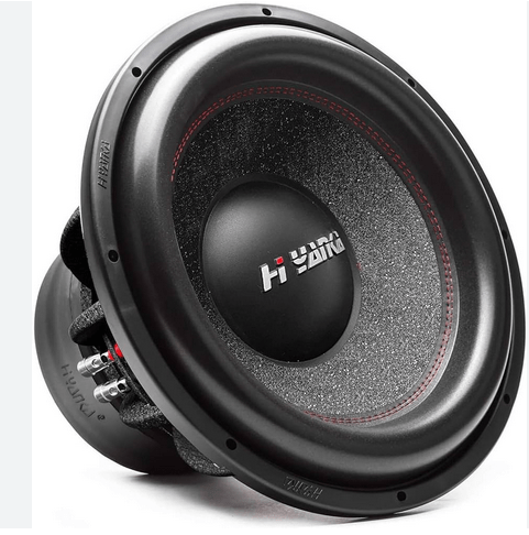

I think it might be more fundamental, I think he may be confusing sub-woofer and woofer?
For a conventional 3 way hifi speaker a paper cone with pleated suspension or roll surround (made of rubber) would be preferred for its good performance into the mid-range.

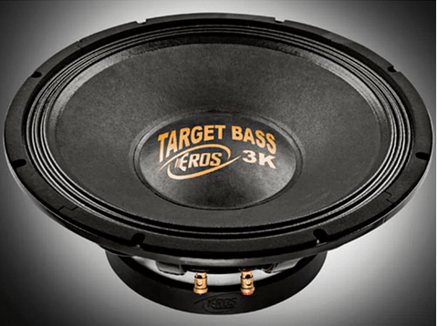

That's what I imagined, but finding one of these in my country is very difficult unless I order one to be made, but then we run into the problem of measuring the parameters thielle small
When I search for woofers speakers like the ones you mentioned in my country, only subwoofers appear.
