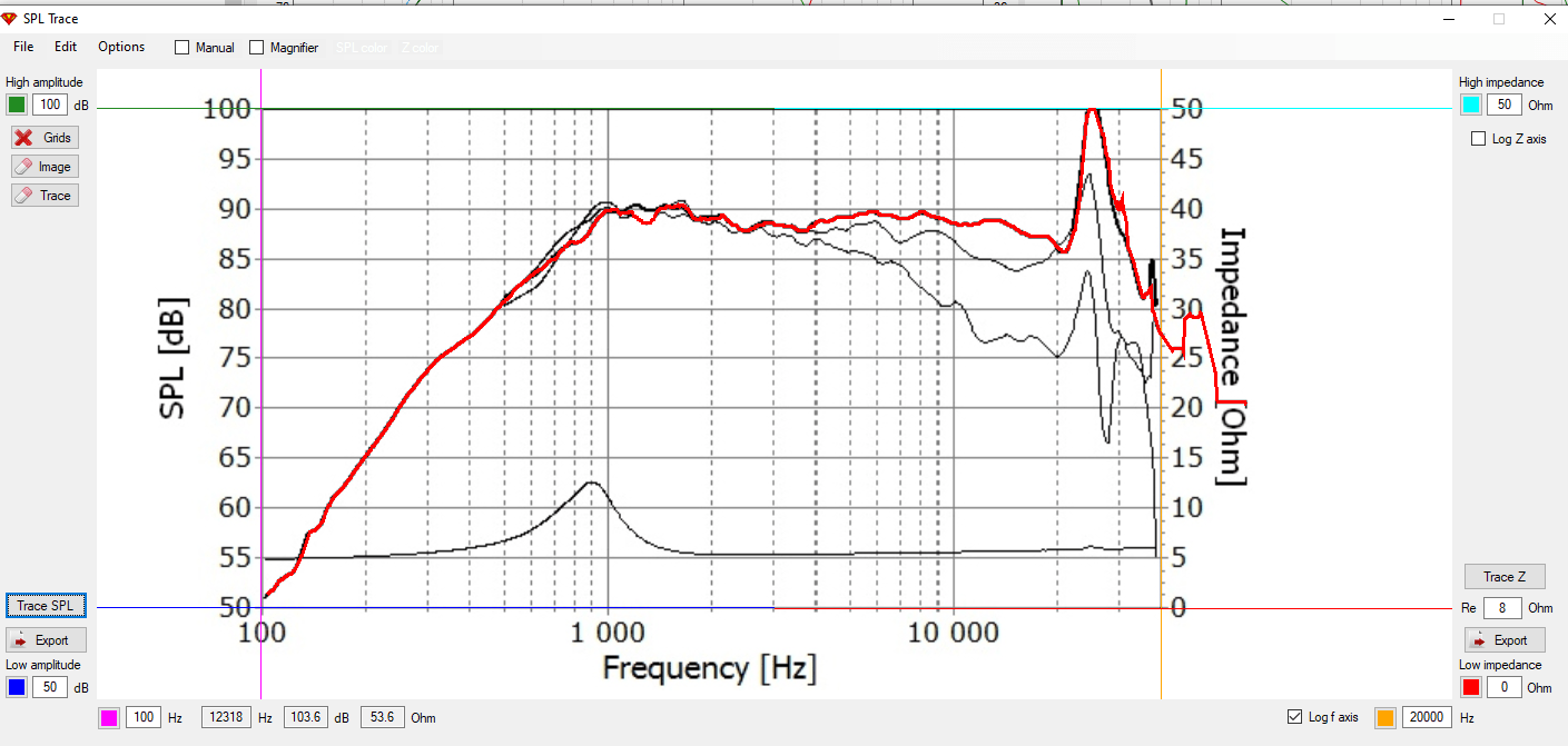

In the Spring, I finished the Missing Link boxes for the InDIYana 2022 xover theme with the added objective of using it for more upcoming 7" 2way type build stand-mount projects.

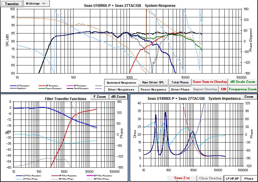

Most of you have likely seen the first use with the SB29RD(A)C and Dynavox LW6004HRN. This is the second one, using the Seas U18 and 27TAC Titan tweeter. The 50 Hz tuning and stuffed 15 ltr box was good for the U18. If I tuned lower, it would sound a bit anemic, but the highish tuning used supported the bottom end fairly well.
I used the first of my 2 pair of Titans in the EMP build recently in the last couple years, and this is now the second implementation of a tweeter I really enjoy a lot. What is posted here for FR and HD is prior the addition of a 1 ohm resistor after the xover on the tweeter to adjust to taste. It was flat before, but just a hair bright, so just eyeball about a -1dB tilt above 2.5k.

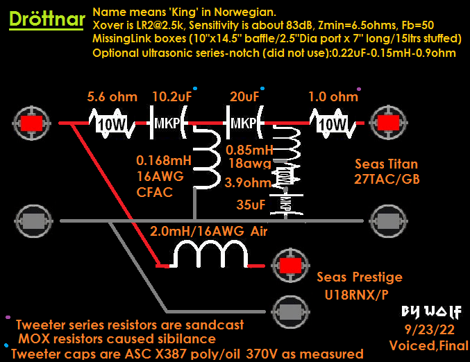

The xover ended up being LR2 at 2.5kHz, which is one of only a couple times I've managed that result. Because of this, the toe-in needs to be just a bit more than normal to get the image right and not shift when moving my head. I literally can look down the outer left and outer right sides of the respective channels when seated in the right spot. To get the drivers to comply at LR2 took a single coil on the woofer and an overdamped 3rd order on the tweeter with an additional Fs LCR compensation. The TAC has no ferroFluid, and this is a likely compensation circuit to add in most cases.

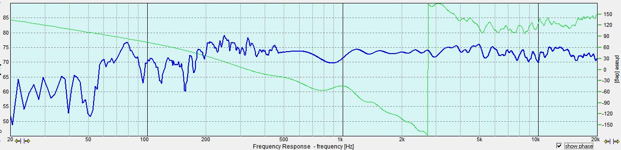

  • I heard more details in some tracks I know really well, and that is saying something. This is a VERY clean design. It has lower HD than a lot of my other builds, dominantly -50dB for the most part.
  • I had some sssibilance initially when I added the second resistor, which was a MOX Lynk type. I changed to a sandcast, and the problem subsided.
  • I have some very small Russian polystyrene caps of 0.002uF. I paralleled the tweeter caps with them just to hear the results and had no expectations. They are very small in value. Well- I removed them after a first listen as the tweeters sounded broken, disjointed, and distorted badly. I really thought I might have had a bad tweeter because of what I was hearing. After removal, the relaxed and detailed sound that I heard prior returned as I had left it. I'm not really sure what caused the bad interaction, but it was awful!! I am not a supporter of bypassing for the most part, but since I had them and they were doing nothing I gave them a shot.

For the parts used, in case you're curious, I used ASC X387 poly-in-oil caps for the tweeter, and I hand wound a 16AWG air-core for the woofer that I triple-dipped in polyurethane. Sandcast resistors used throughout.

Omnimic/PCD doesn’t model for off-axis, but acoustic LR2 @2.5Khz is the sweet spot for drivers this size, particularly if the drivers are as smooth and extended as the U18.
For decades Wolf’s ear has been assessing what we’ve only started being able to measure in the past few years (horizontal and vertical off-axis out to +/- 180 degrees and thus power response and predicted in room response)
Another job well done Ben!
Hi Wolf - do you bother with off-axis simulation and measurements? if not, why not? Just curious (not a loaded question - always learning).
PCD does the Power Response model, the green curve. It's a best fit sum of all the supposed axes in one plot. You can also toggle off axis left and right or up and down or both at the same time using piston diameters. In terms of modeling on this build, that's about all I did here.
If you look at other builds like the Purveyor as an example, I did quite a few off axis measurements in Omnimic. It just takes a lot of time.
So, yes, I do take off axis into account. However, I feel the primary axis reveals the most about a design.
Omnimic/PCD doesn’t model for off-axis, but acoustic LR2 @2.5Khz is the sweet spot for drivers this size....
For decades Wolf’s ear....
As I said above, it sorta can, and I've used it this way a lot. Thing is, the U18 just won't do LR4 simply. The response will not allow it. I did try to see if it would. LR2 is simple with just a coil. I'm not opposed to lower slopes/orders, but this is an atypical convention for most drivers. The U18 will even be capable of a 3k xover if desired.

I really like the Curv drivers. They are very light in mass, and yet very well damped with minimal breakup. They do however have a little flex to the material, so are not the most pistonic for the best bass response. Since the minimal breakup follows, this means that the networks don't require excessive conjugates to make it behave. Back to the flexing cone though, you can see the rise in HD around 800Hz, and this cancellation and minor wooliness is audible and really the only minor flaw. It does not sound bad. The U18 has a very smooth sound, with the right weight in the lower mids, and detailed midbass.

As to the rolloff of the U18 being preferably LR2, the rolloff with a single coil simply matches LR2. You would have to use a 3rd order and some clever compoents to yield the LR4 match. Most woofers do not meet LR2 or even a quasi 1st order (tapers to 3rd order acoustic outside xover with in phase and -6dB summation) acoustic xover result easily, and favor an LR4. This is one of the rare birds that do it well. If the tweeter can do it too, which can be a tough endeavor in a lot of cases, it is indeed a rare combination. Tweeters work harder to play with an LR2 result than a typical LR4.
