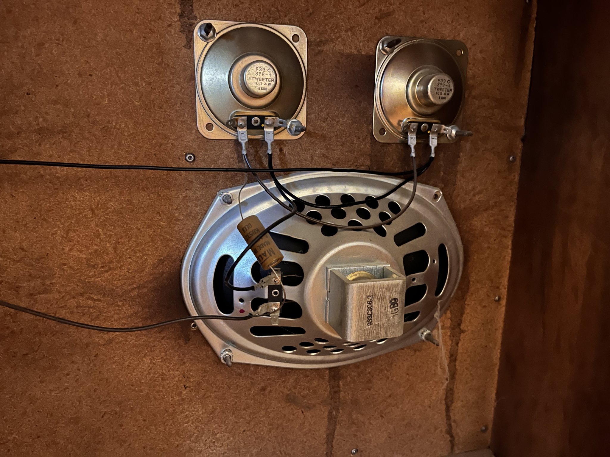

I'm helping a friend who wants to make use of an old cabinet with speakers, tuner, and built in phono -- you know these old things you see sometimes that open from the top to access the record player, etc. . . ? Not interested in an original restore, but rather an easy way to add a bluetooth and line input, etc. . . I was thinking a little class D amp, a raspberry pi, and a selector switch. The speakers currently work, and I'm trying to figure out if I could drive them with a reg amp? I've worked on tube gear before, and comfortable with soldering and whatnot, but wasn't sure if these speakers need something esoteric to drive them. We'd like to replace the old amp in there.
Each side has two little tweeters and this woofer. Any idea if these could be driven by a regular amplifier? I've one messed with full range speakers before, but I assume the capacitor there functions as a crossover for the tweeters?

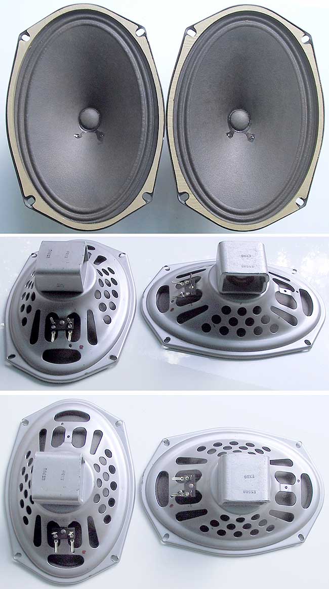

I’d be tempted to see what the oval sounds like all by itself. From the numbers i’d guess an RSC (made in Canada)

What's the original amp, and does it have a 16ohm output? I see the tweeters are 16 ohms each. A class D amp will most likely have a 4 ohm output impedance.We'd like to replace the old amp in there.

The two 16 ohm tweeters are in parallel giving an effective load of 8 ohm. I would presume the woofer to be 8 ohm. The capacitor acts as a filter, blocking the low frequencies and allowing only the high frequencies to pass to the tweeters.
I see no reason why this combination can not be driven by an 8 ohm capable amplifier.
It may be a good idea to replace the capacitor with a modern non-polar (bipolar) equivalent.

A class D amp will almost certainly have an output impedance near zero. But they, as a general rule, are quite 4Ω capable.

Ahhhhhh that makes sense, thanks! I thought it was weird to have 16ohm tweeters.The two 16 ohm tweeters are in parallel giving an effective load of 8 ohm. I would presume the woofer to be 8 ohm. The capacitor acts as a filter, blocking the low frequencies and allowing only the high frequencies to pass to the tweeters.

Maybe I am mixed up was thinking of using an old Topping TP20 as an amp, which is technically class T? I thought it was class D. It seems to drive 8ohm fine.

It is small, replace with a poly. Those tweeters are not that good. it probably sounds better without them connected.

Now that I look at the pic it's obvious. 🙂The two 16 ohm tweeters are in parallel giving an effective load of 8 ohm.
