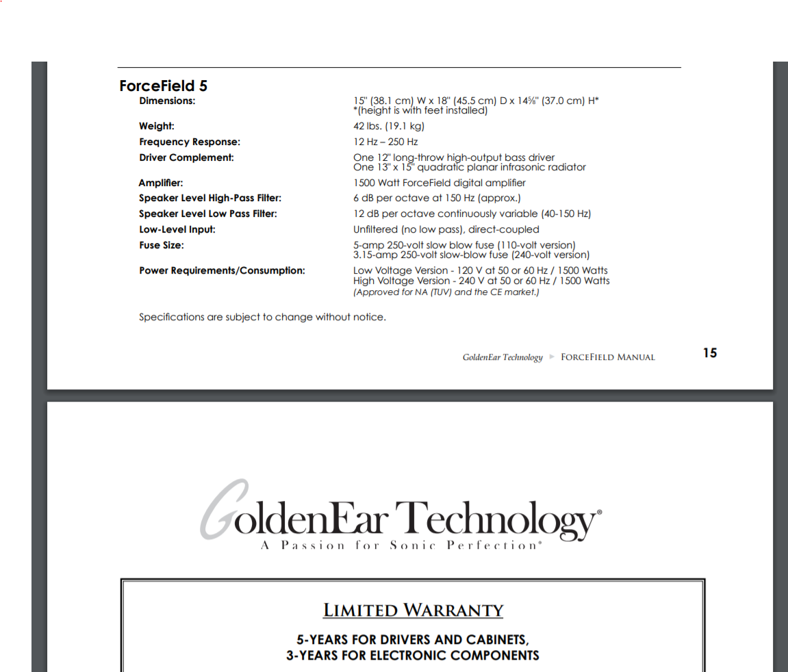

Approx. 30 feet terminating at this subwoofer:
Golden Ear ForceField 5:
I use this sub with the speaker inputs currently or with the sub output of a receiver, receivers already have LPF on the sub out. However I just noticed that the line in of the sub apparently doesn't have a LPF built into the sub, only the speaker ins have that. I guess they don't bother putting LPF's on the line in level of subs because receivers already have a managed bass sub out. So I may have to put a small LPF in front of the line driver in my design. And if I simply use a smaller coupling cap after the driver I can have the HPF be that, and eliminate a capacitor, thinking I needed to put a HPF prior to the driver tube, duh.

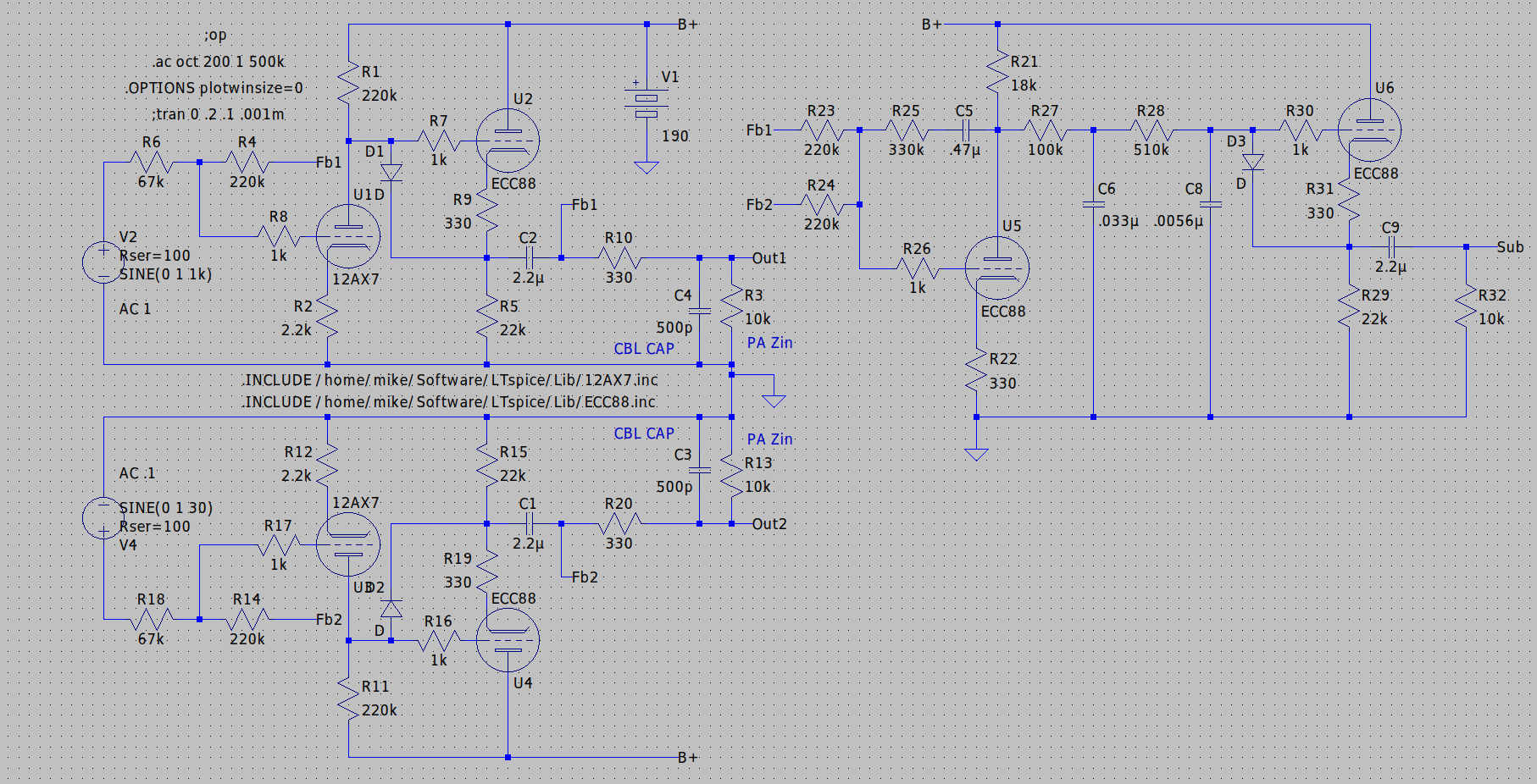

The line in of modern subs are full range, so that means I need a simple RC low pass filter. My goal with this project was to intentionally relieve the OPT of deep bass by reducing the size of the coupling capacitor to roll off the power stage at, lets say 60hz. Then the LPF feeding the sub would roll off highs at 80hz. That gives 20hz and more of common overlap because the filters will be gradual 6db simple 1st order CR / LR filters. Because I am intentionally giving my OPT a break by relieving it of lows, I cant use the speaker inputs of the sub.
I'm sketching out a schematic for the subwoofer driver and LPF board and where in the circuit I will tap off, probably after the driver just before the amps coupling cap. That way the volume control works for everything and the sub driver board has some gain in front of it to compensate the LPF and CF losses.
I'm thinking the LPF and sub driver board will have a cathode follower, then the RC LPF followed by another cathode follower. This way the filter is unaffected by input / output loads or volume controls, because it is sandwiched between two CF's. The second CF then feds the sub. The first CF takes its input from wherever one wants to tap off of.
TAP OFF AMP DRIVER OUT ----> INPUT-CF ----> LPF ----> BASS LEVEL POT ----> OUTPUT-CF ----> LONG CABLE ----> SUBWOOFER IN
This little board will also have a sub woofer level control to act as my "bass" control. Not sure yet if it's worth putting in a switch to select from maybe 3 different LPF frequencies 60hz, 80hz, 100hz, it would be easy maybe the board should have it. Initially I'll try a 10K resistor with a .2 uf shunt capacitor, that will be approx. 80 hz LPF. As mentioned I'll roll off the power stage by just reducing the coupling cap
It should be a handy board because I really need my subwoofer, my speakers are Klipsch bookshelf speakers very transparent, smooth, dispersed and sensitive enough for flea watters, for the range they have. The sub fills them out nicely on the bottom. I could see dropping this board into all my projects.
I will post my schematic here sometime in the future as I think I'm finally making some headway. I'll have to breadboard it to make sure the bass level pot right after the LPF doesnt affect the cutoff freq with level changes, I dont think it will?

Maybe I've had too much beer tonight, but why not just drive the 'speaker' input with your buffered output? I've seen plenty of such inputs that don't require speaker levels or impedances. Measure or find out what the impedance actually is (may be 5k to 25k!), and the level required actually is, and from that we can design a proper buffer -- if necessary. 😉
Floating the input with a line-level transformer may still be necessary to stifle hum. But it's an expense in both $ and SQ -- if you don't really need it, leave it out. Why plan/buy something you may not need?
If it were me, I'd avoid simple first-order filters. With the rare exception of bass guitar performance rigs, the stop-band attenuation and phase performance is simply not adequate. Designing for a '20 Hz overlap' is a gross oversimplification.

Sub outs are usually taken at the preamp. If you are doing it in the power amp I would take it before the VAS as the sub amp is going to be expecting no more than a couple of volts RMS. For what it is worth here is a preamp design I am working on with a sub out. Note that I have a simulated cable capacitance on the main outputs and I ran that up to 9000pf and still showed a high frequency roll off (-3db) starting above 30kHz.
Anyone that follows my antics knows that my favorite choice for a follower is a mosfet.
If a tube must be used, I would go for a high Gm device, either a TV IF pentode like the 6EJ7 / EF184 or a triode like the 5687, 7119, 7044 or 6DJ8 / 6922.
Proper filtering is always needed somewhere in the chain. Either in the sub itself, from LFE, or a low pass inserted. Chances are you need about 4th order for it to sound like anything other than “booooooooooommmmm”. If it were me I’d use DSP unit to dial in the required filtering by ear or measurement, and then implement it however you see fit. If an LFE output was working to your satisfaction, implement that filter. It will be more than just an RC. 4 cascaded RC’s often works, but not always, and still requires experiment to get right. If you’re playing with k-followers anyway, you can make Sallen-Key filters and gyrators out of them to make whatever filter you need.
If your preamp and sub both have 3 prong power cords you WILL need a transformer to break the ground loop. There are rare instances when you can get away without it, but with 3 prong power cords it is the exception. Home brew tube amps/preamps usually have 3 prong power cords (or should). Consumer electronic preamps/receivers never have a 3 prong cord, which is why most HT systems can get away without a transformer going to the sub. The little “200 Hz capable” $6 Triads will work as an experiment. They go below 20 when driven from 600 ohm sources. If you get hum without and none with, then you can justify a more expensive transformer.
All my stuff gets mixed pro/home use, so transformer or balanced in is the rule. And why I suggested even beefier followers - l like getting output Z under 100 ohms. If 600 is fine, you can use mini novals, and there are a lot of choices. Don’t discount small signal pentodes for making high gm as a k follower (and TV tubes are cheap).

R3 and R13 are just simulating the input impedance of the amplifier that the preamp is driving. In reality I would have a largish resistor there to discharge the output cap when no load is connected. The parallel caps there are just to simulate the capacitance of a cable and is not an actual part at all. If you want to simulate an input level control on the amp change those resistors to a series string of two resistors with a tap between them feeding the input circuitry of the amp.
A White CF is the proper way to drive a transmission line. An ordinary CF drives the line capacitance in the +ve direction only. High Gm is required.
In the -ve direction the line capacitance depends on the cathode resister, not as effective. 5687 or 7119 would be OK for a White CF.
