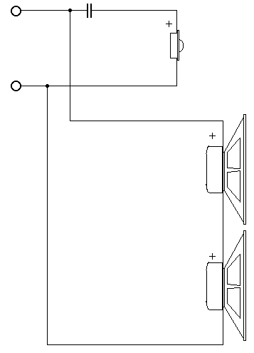

I am planning to build a tower with 2 woofer one midrange and a tweeter. I might be using an 8" 8 ohms driver. Do you have any ideas how to link them on a Xover in order to produce 8 ohms not 16 or 4 ohms. I need your expert advice.
Thanks🙄
ndestruckt said:
Do you have any diagram to a 2 woofer and a tweeter?
I'll go for 4 ohms for the woofers and 8 ohms for the tweeters.
2 4 ohm woofers connected for 8 ohms
This is a minimal solution. Usually the XOs will be more complex.
dave

chris ma said:
With the diagram that you posted above, if I were to use one woofer instead of two, what cap value spec I should be using consider the followings;
1. Woofer is the Triangle full range
2. tweeter is one of those Audax dome tweeter
3. No crossover
4. Bi-wire for now, Bi-amp later
5. Open baffle, no box
Well you need a crossover on the tweeter -- that's what the cap is. I'm not sure how high the Triangle's go, but i'd think they go high enuff that you can get away with just a cap on the Audax (is it ferrofluid? -- that smooths out the resonance peak and makes a single cap work better).

chris ma said:
But I need to know the range of values of the caps normally used in crossover, like
100uf 50V mono or polarised etc.
Any hint?
To get a ballpark you need to know the nominal impedance of your speaker and the neighborhood of where you want to XO.
a 2 uF cap into a nominal 8 ohms gives an XO of 10kHz. Making it 2x as big moves the XO to 5 kHz, halving it moves it to 20k.
If you have a 4 ohm T, double the cap value, if a 16 ohm T halve them.
