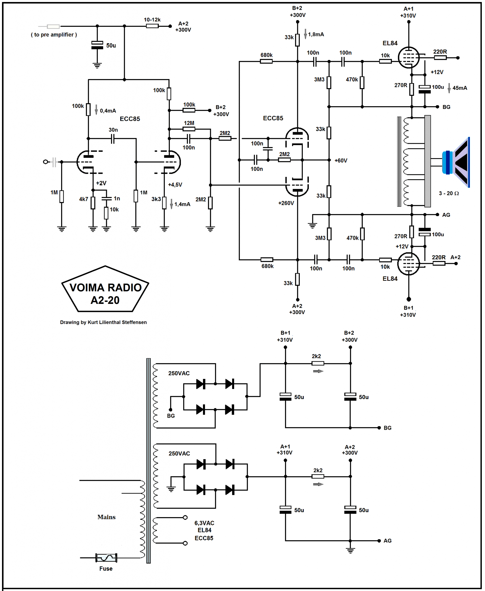

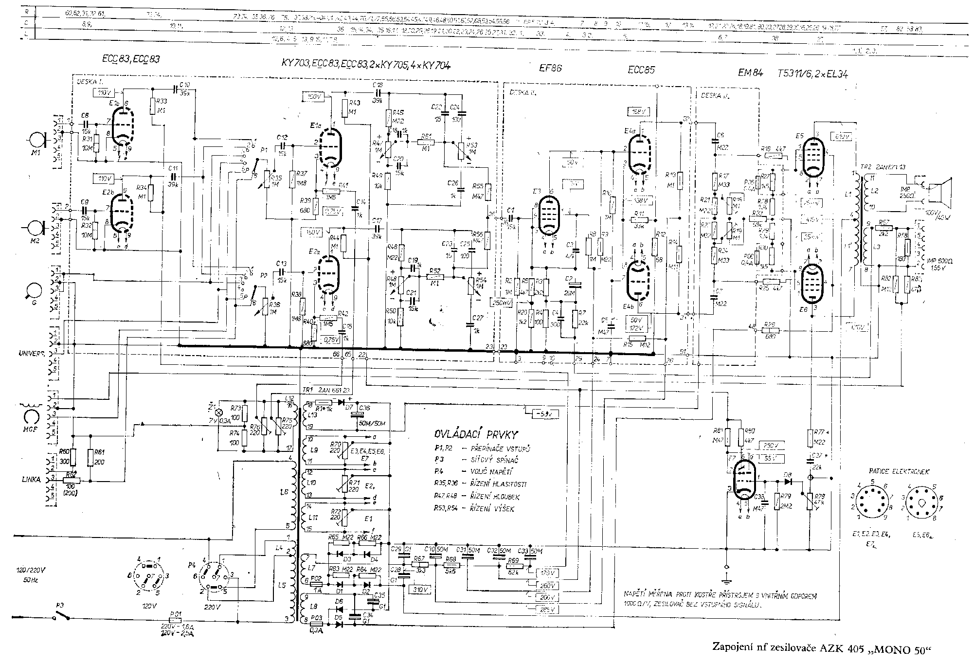

Attached are the schematics of the Philips EL6425 and four other amplifiers using the ECC85. Three of these five are intended for 'normal' use, so not (primarily) as PA amplifiers.

2 x ECC85 + 2 x EL84 c-follower pp (Voima Radio A2-20).png541.3 KB · Views: 169

2 x ECC83 + EF86 dc-coupled + ECC85 + 2 x EL34 pp (Tesla Mono 50).gif79.7 KB · Views: 137
