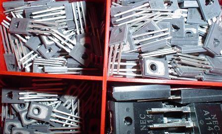

As for BD139/BD140, different ball game : datasheet
How many would you like to see ? =>
