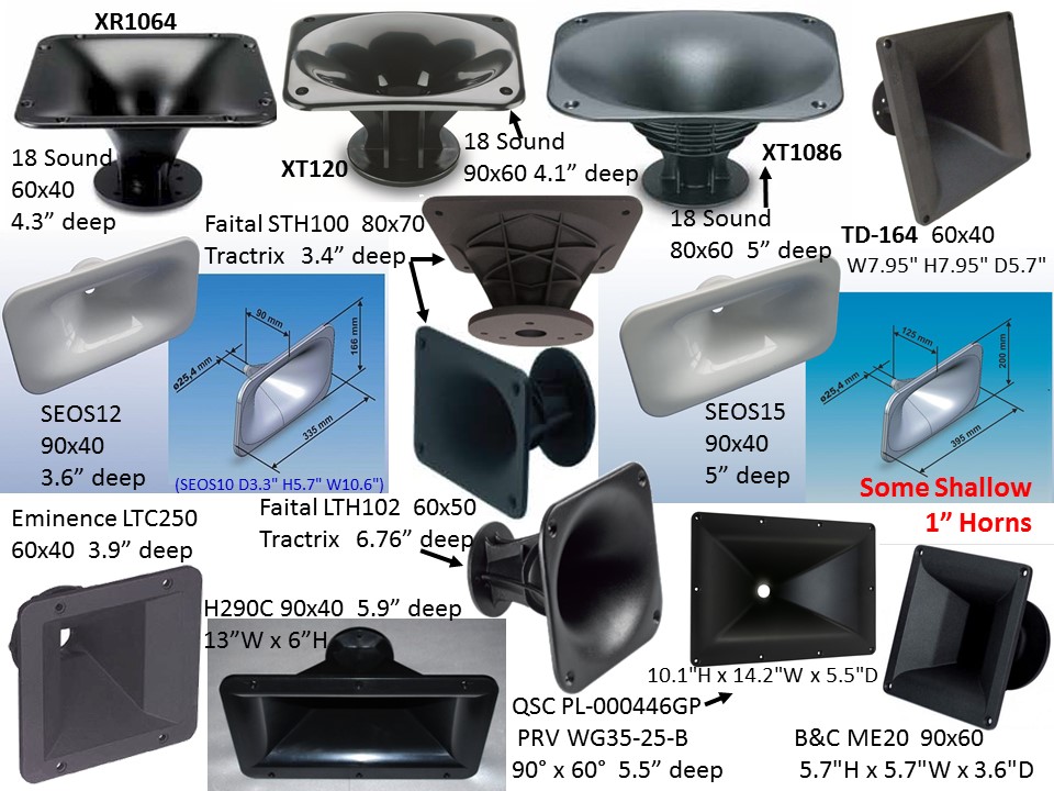

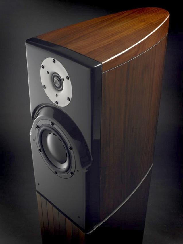

You can obtain both controlled directivity plus time alignment with a well designed horn speaker.
There are a few shallow horns/waveguides which can time align with the voice coil on a modest diameter woofer. The 3.6" deep SEOS12 waveguide offers close time alignment with a few 10" - 12" midwoofers like the 4.9" deep Eminence Delta Pro 12A. The massive EconoWave threads will provide education and proven design options.
With a standard dome tweeter, a properly constructed stepped baffle for time alignment has become popular.
