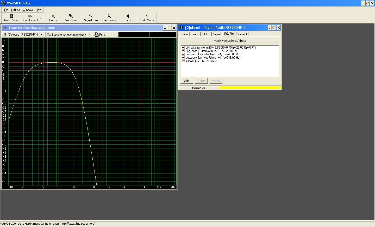

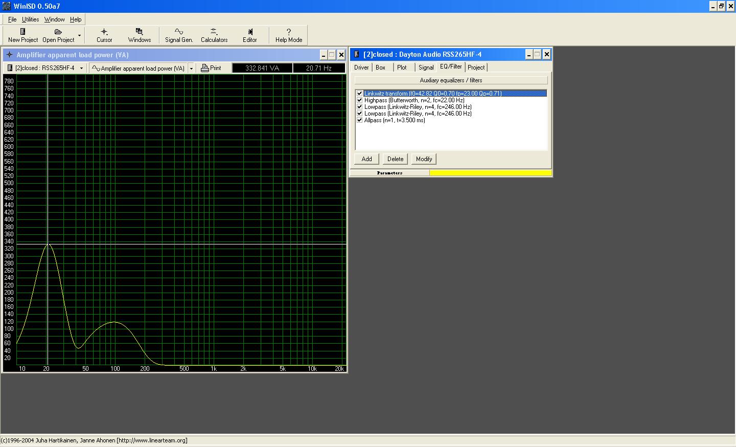

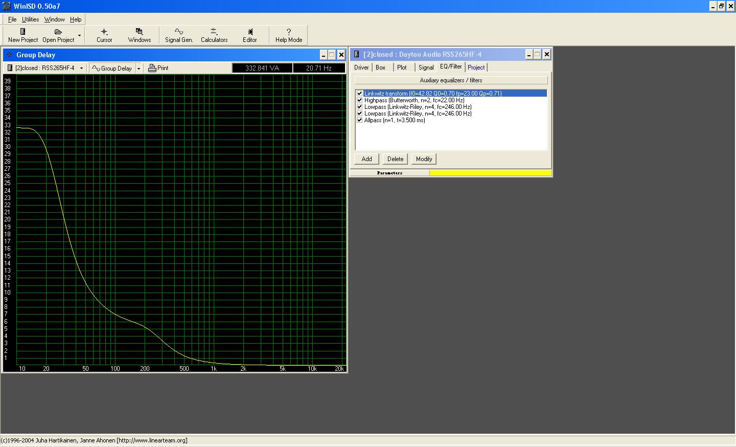

I would like for guys (and girls) to give me some ideas on which driver to use for my next project. Low frequency extension for my previous project http://www.diyaudio.com/forums/multi-way/207159-trinium-my-latest-build.html
This project will be powered by Hypex PSC2.400d amps (DSP controlled), I want it to be a sealed design with 2 10'' drivers per side. Max 30L per driver, and go down to ~30Hz. Xover will be an LR8 ~300Hz. For looks I would like the drivers to have a black cone.
2 options I already simulated that seem to do the job with a LT:
Dayton Audio RSS265HF-4
Seas D1001-04 L26ROY
Max cost per driver ~ E200,- Thanks!

Four of the Dayton's should do quite well in 120L. I like them a lot, tight and punchy little drivers. You'll be limited to ~220w but that should get you ~110db at 30hz with a PEQ center at 30hz/Q=2 and +6db boost.
Yup, that's what my sims showed to. Looks like a nice match for the amp (400W RMS / channel, 600W max 2 channels)
Because it is DSP controlled I have a lot of freedom to EQ (13 biquads / channel)
