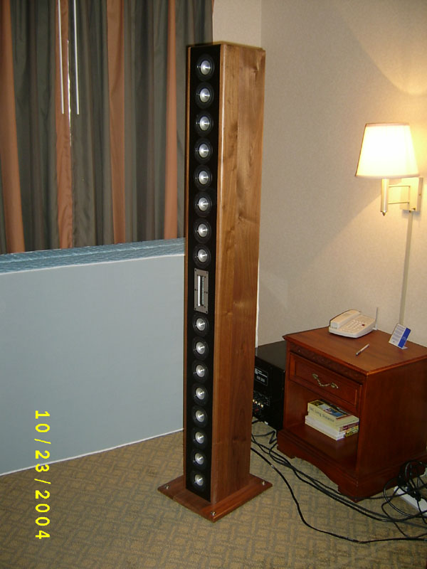

I have been working the DIY line array issue for nearly 20 years. My research and thoughts lead me to write the Near Field Line Array White paper in 2003 which Greg referenced above in Post #.
My early work is summarized in this thread starting at Post #43:
Proven DIY Line Array Design?
Back in 2006 I completed a large two-way array array which used 9 Aurum Cantus G3 ribbons and 12 Creative Sound Solutions 4.5" WR125S woofers per side. You can see a photo of that array at:
While the Aurum Cantus ribbons are still available but the woofers are NLA.
Another line array from 2003-4 time period was a petite model that I call the Needles which had 16 TangBand W3-871S drivers and a single G3 ribbon per side. Think of it as a MTM with extended Ms above and below the ribbon driver.
More recently I used Don Keele's CBT work to develop an array which I call the Modified CBT24 which is documented in this thread:
My New Line Array--It's a Modified CBT24
My recent recommendation for a full range driver array is to use a small driver (I use the SB Acoustics SB65WBAC25-4 in the Modified CBT24 project). Others have built straight arrays with that same or similar driver. A subwoofer can be added to fill the lower octave or two if you need more bass. Photos of the Modified CBT24 are shown at:
Modified CBT24 - Google Photos

Pawelgreece,
My Needles array crosses between the TangBand drivers and the ribbon just above 2000 Hz. You will need a subwoofer to cover below 100 Hz or so as the small drivers would need an overly aggressive EQ to raise their output level. My subwoofer has a plate amplifier with filtering so that low frequencies are amplified while high frequencies pass to the amplifier for the array.
As wesayso has mentioned you will need a longer array to achieve optimum results if you use a straight array. The driver spacing needs to be as close as feasible. A straight line array would likely be the most straight forward construction project. But once you get over its curved enclosure, a CBT is a very nice solution for my listening. If you have access to CNC capability, then your cabinet building can be made much easier.
Jim
Jim

Jim uses a sub to help his little drivers, and wesayso uses 25 drivers per column to apply a generous EQ to go down quite low.
And again, do read Jim's "Near Field Line Array White Paper" as it will answer a lot of your questions.
