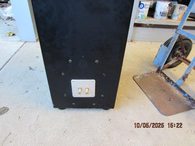

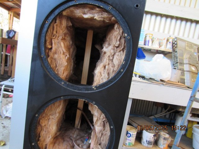

I recently purchased a couple of well made boxes thinking that I had suitable drivers in the stash based on the sellers description.
I do but only 2 of them and they are old model Tandy drivers more suitable as midrange not as woofers or subwoofers.
Anybody know of a driver that has a cut out of 240mm and an external driver size of 270mm?
I'd like to be able to use these well made boxes if affordable drivers are around. Asking here while I search though sites.
Australia so my options are limited

Any pics of the boxes?
The volume of each of the cabinets is 70 liters and you can install two drivers in each cabinet?

@zman01 the recommended box size for the drivers https://www.theloudspeakerkit.com/dayton-audio-sd270a-88-10-dvc-subwoofer
Is that volume so my WAG is that these were the original drivers in these boxes.
Boxes cost me $50- and fuel but it was a nice day for a drive
