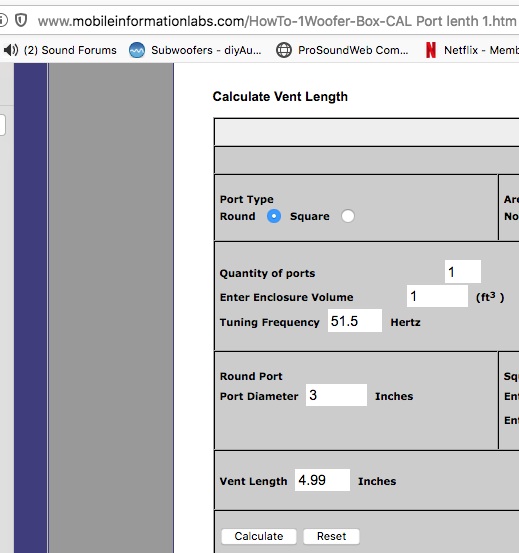

If the mounting opening matches, I'd look at a GRS 10SW-4 driver. Anything more than that, you can be spending more on a replacement driver than the subwoofer is worth.
The box is tuned (Fb) to around 52 Hz, regardless of the speaker used.My question is could anyone suggest a replacement driver that would work in this small of a cabinet that would go lower?
In general, response drops at 24 dB per octave below Fb for "standard" box tunings, which have adequate box size and Fb around Fs.
Probably better to sell the cabinets "as is" and design for what you want, rather than swapping speakers in to a too-small box that will require a longer port which will reduce box size even more.

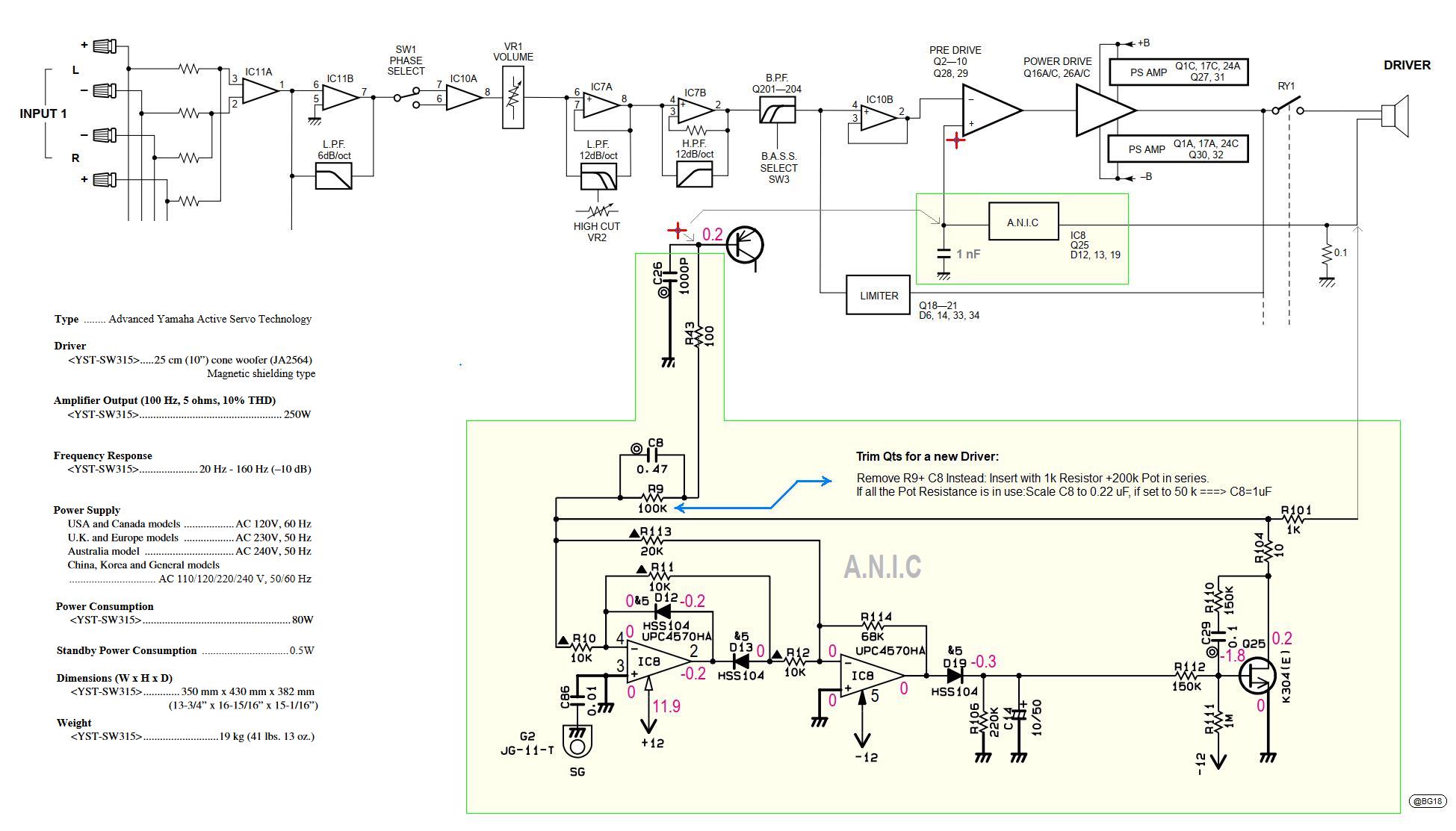

Hi All,
FYI,
Finding a replacement Driver for this simple Sub and tweaking the eventual differences of the TS-Parameters should be a No-Brainer for a true DIYer.
https://tw.yamaha.com/files/download/other_assets/1/326761/YST-SW315_SW215_RT.pdf
b 🙂
FYI,

If this subwoofer uses some sort of feedback loop to modify its output, plugging the ports is likely not going to produce good results.
I must do some more reading about this YST tech. Looks interesting...
this yamaha uses the technique described by erik stahl , also discussed in this forum:
https://www.diyaudio.com/forums/multi-way/20037-simple-mfb-woofer-project.html#post360363
Karl Erik Stahl developed a technique where the amplifier is synthesizing some of the parameters of the driver used, most impotantly the moving mass AND the resistance of the voice-coil. With a negative output-impedance of the amplifier the eletrical Q of the driver is reduced, and the synthezised mass-increase is lowering the Fs without decreasing the efficiency.
The bottom line is that even with a new driver the amp will dominate the driver-parameters, which means that a new driver probably not will improve the performance, even if the circuit is calibrated to fit the new driver the best possible way.
Steen
Steen
