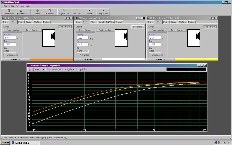

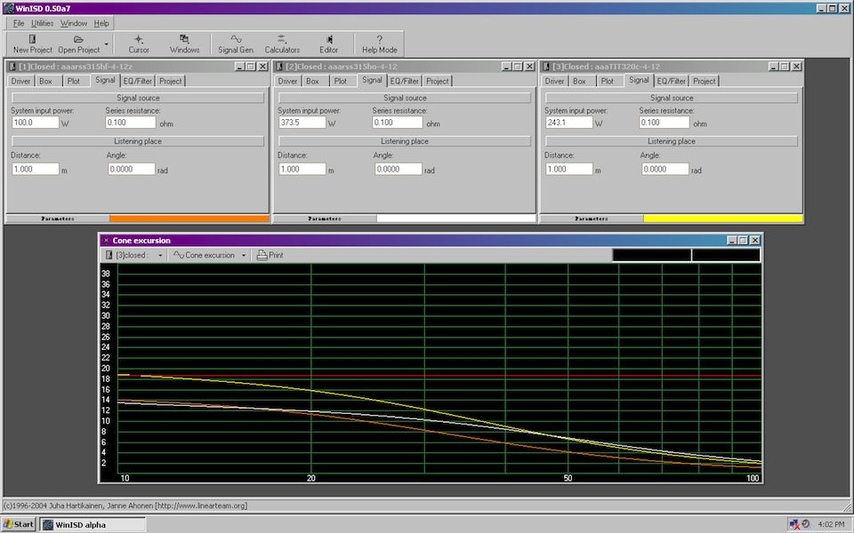

The pics tell the tale 🙂

Rev, I've yet to get acquainted with software modeling (in fact I'm going to start looking into it tonight... loooong past due). Can you interpret those graphs for me a little?
I'll try... They are a general comparison of the three drivers in sealed boxes that yield a Qtc of ~.57, that is a box volume that is critically damped (read this: Q factor and damping Q factor - Wikipedia, the free encyclopedia )
The first chart (on the left) tells you how much power you can use in this alignment with each driver to reach Xmax.
The second chart shows SPL at Xmax or maximum output for each frequency.
The third is Transfer Function, which shows each drivers efficiency at producing sound at each frequency relative to the other drivers. It's much like the SPL chart in shape but has -3db lines on the graph.
