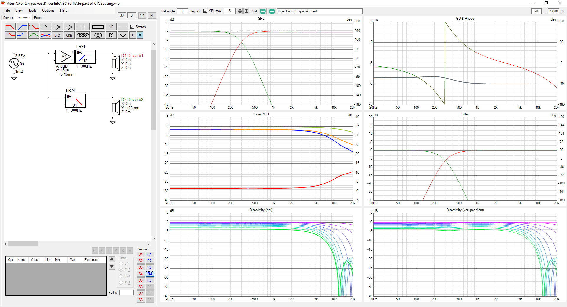

Here's my attempt to show the different CTC impact on Directivity index which is also impacted by vertical off axis. Please critique

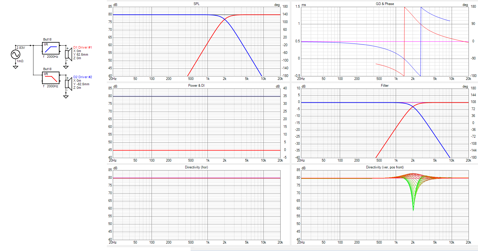

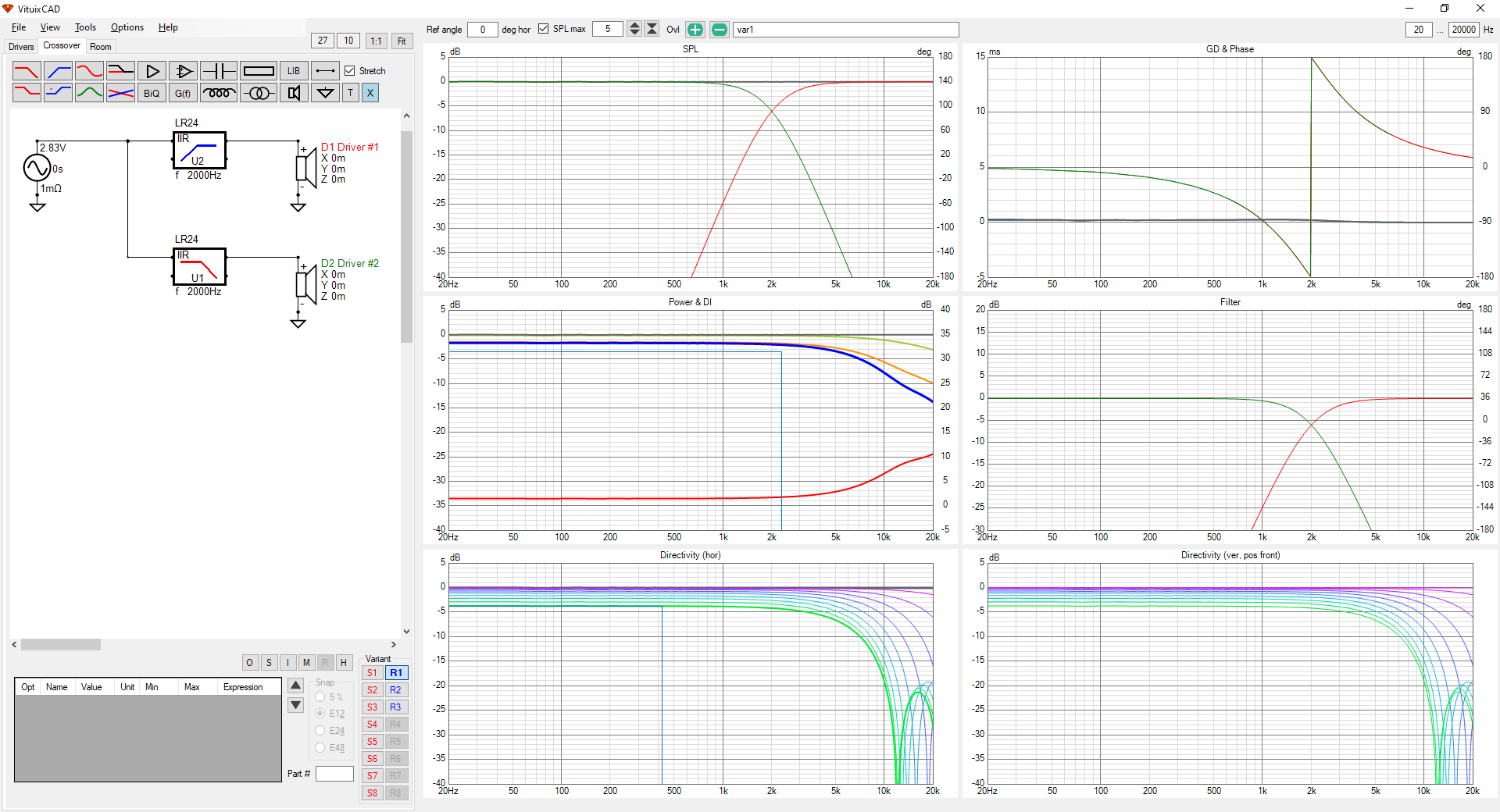

The first graph takes an ideal flat frequency response driver pair that are co-incident (that is radiating from the same point in space). To make it simple, I'm using active filters. We have chosen a LR4 topology at 2,000 Hz.
The drivers are 1" diameter (i.e. tweeters). Yes I understand you wouldn't use 2 tweeters like this, but I wanted to push the natural horizontal off axis drop in SPL to above the XO point (which I would have contended with if a larger piston driver), so we only factor the lobing behaviour from CTC spacing changes.

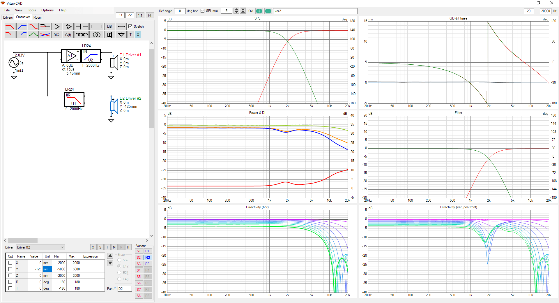

Next we'll move Driver #2 resulting in a 125mm CTC spacing. We now have a CTC ratio of 0.73 (being target 2,000Hz / 2,752 Hz representing 1 wavelength between drivers). Because I have moved the 2nd driver away from the 1st, I have added delay on the 1st to re-align the relative phase so we maintain a perfect 6dB LR sum at the crossover.
Note though the directivty index. We get a -2.3dB drop in the power response just under the XO point (~1,868 Hz).
Also keep an eye on the vertical directivity - see we get a peak null around -25dB from reference..... remember this when looking at the next screenshot

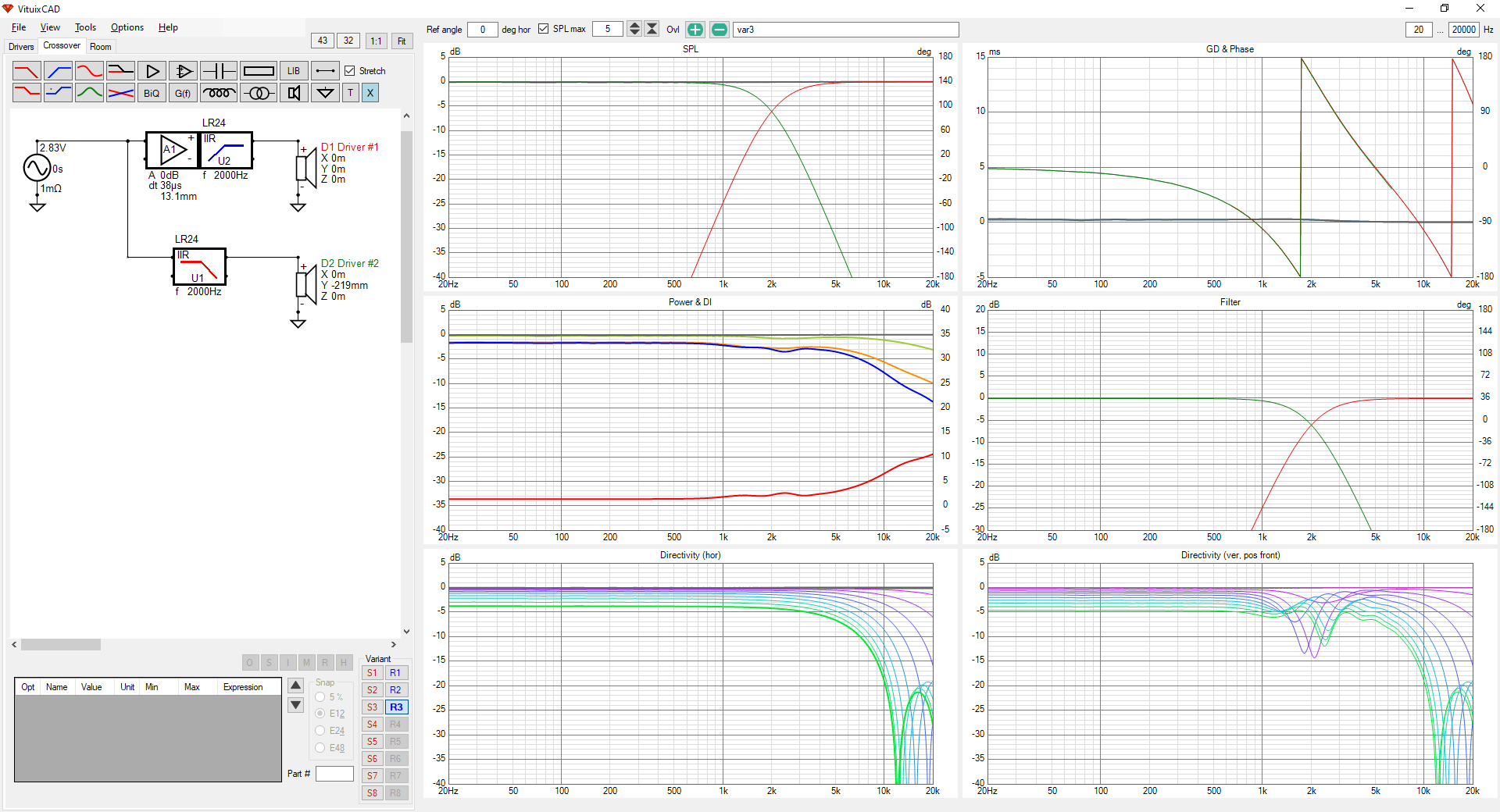

Finally - let's increase the CtC spacing of our drivers so that our XO is 1.4x the wavelength of the CTC spacing (2,000 / 1,410 Hz).
We increase the delay to maintain LR in phase response. As you can see the DI is smoother and vertical directivity has also improved:
Now this is an extreme example, I may have got something wrong and real driver on and off-axis behaviour needs to be factored, along with real world filters.

Yeah thats right.
I see you have used some data as the tweeter beams, but what about the woofer? You can take this bit closer to reality by making ideal spinorama data with the diffraction tool to make the woofer beam as well, and include effects of baffle edge Now you'd see that also the crossover point is important to ulitize woofer beaming, which the baffle also affects some by increasing directivity around wl of baffle width.
Peak in DI is due to lobing, strong side nulls and a lot of sound cancelling out. Intensity of the lobing is maximal when both sounds are equally loud to a direction. In general, when two sounds interfere the resulting comb filter has maximal peaks and dips when they are equally loud, and less when either is louder than the other.
So, utilizing baffle size and shape and driver sizes so that tweeter directivity collapses while woofer has it high also affects the DI. Together with c-c you can tailor the DI. Just remember the main lobe reduces some in size so now listening height is more critical. Also sound toward ceiling and floor specular first reflection change, so you might want to weight all these effects with your situation and make sure the drivers are fine doing what ever the xo needs be and so on 🙂
I have no idea which sounds better. I would like to think that since listening height rarely changes smoothest DI wins, especially if you listen far away like other side of the room like many people do. But if you sit very close, then the listening height easily changes if you lean back or forward, and closer c-c would possibly win having less variation in sound. Also audible effect of early reflections are somewhat less with small stereo triangle, so strong side lobes/nulls have less impact.
What is close and what is far listening then, do you hear any of it, and do you care?
Have fun listening! please report if you do find either setup better sounding (small/big c-c), don't forget to include information about the positioning and room 🙂

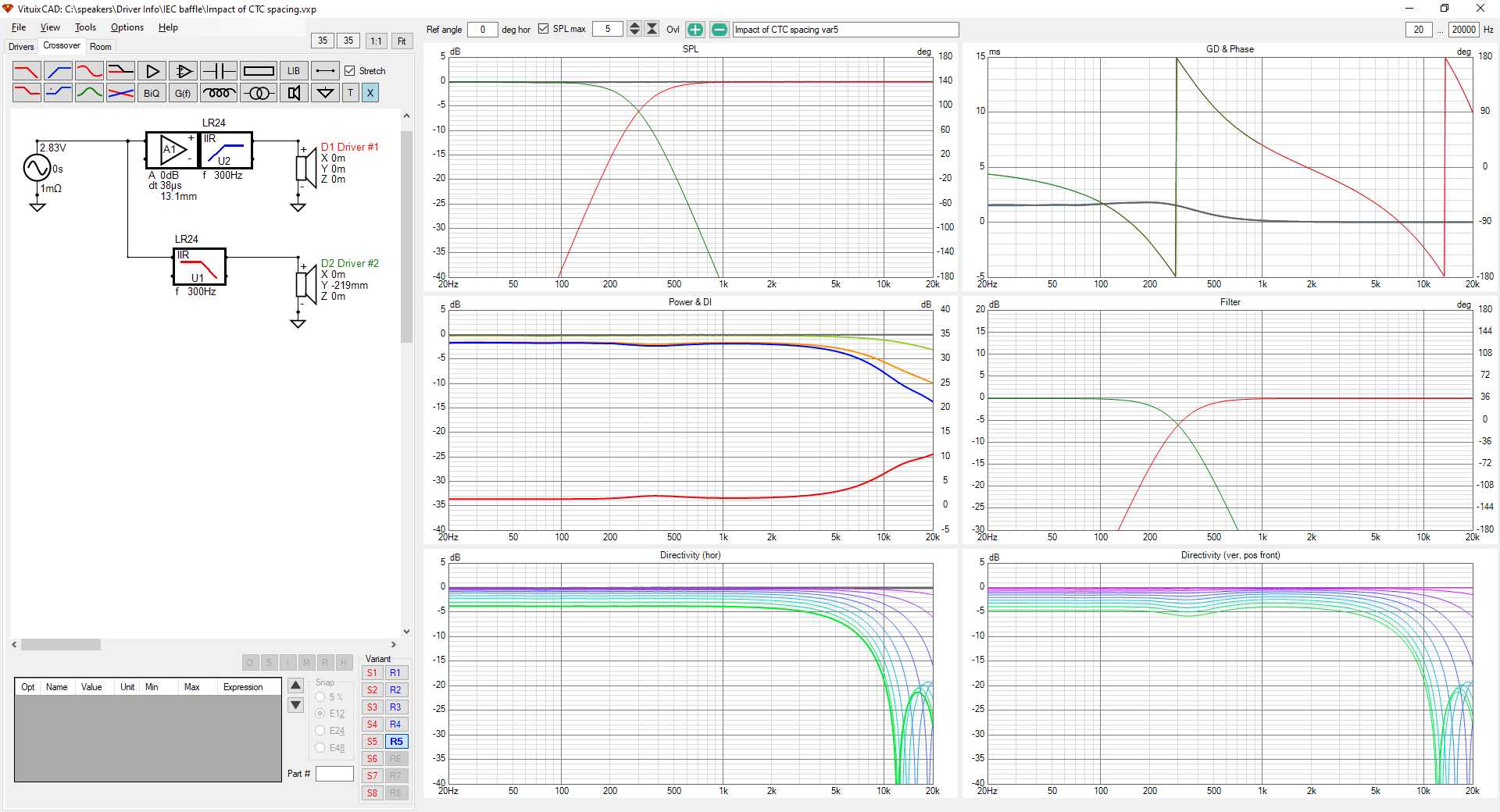

Out of interest what happens if the XO moves down to 300-400 Hz (assume teh tweeter goes that low)?
dave
It should have said
Finally - let's increase the CtC spacing of our drivers so that our XO is 1.27x the wavelength of the CTC spacing (2,000 / 1,571 Hz) - being a 219 CtC spacing.
Moving the XO point alone - same spacing, yields a negligible difference. Larger spacing shows a slight bump in DI
A good demonstration of what you set out to show.
I like another method. It works with different and even closer spacings and in this example, using your worst case 125mm spacing, it shows perfect DI.
Allen, why did you centre the mic between the drivers? Wouldn't it be better to put all the Y offset on a single driver being the usual case that one or other is the measuring or design axis?
