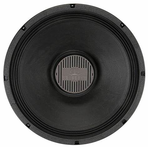

Eminence locate a heatsink in the dust cap position of their Kilomax Pro-18A driver.

The centre pole gets hotter than the rear plate/magnet assembly, so it is from the centre pole that we require to remove heat.
Eminence talks of a "cooling plug" being pressed into the centre pole in order to conduct the heat out and transfer it to a heat sink.

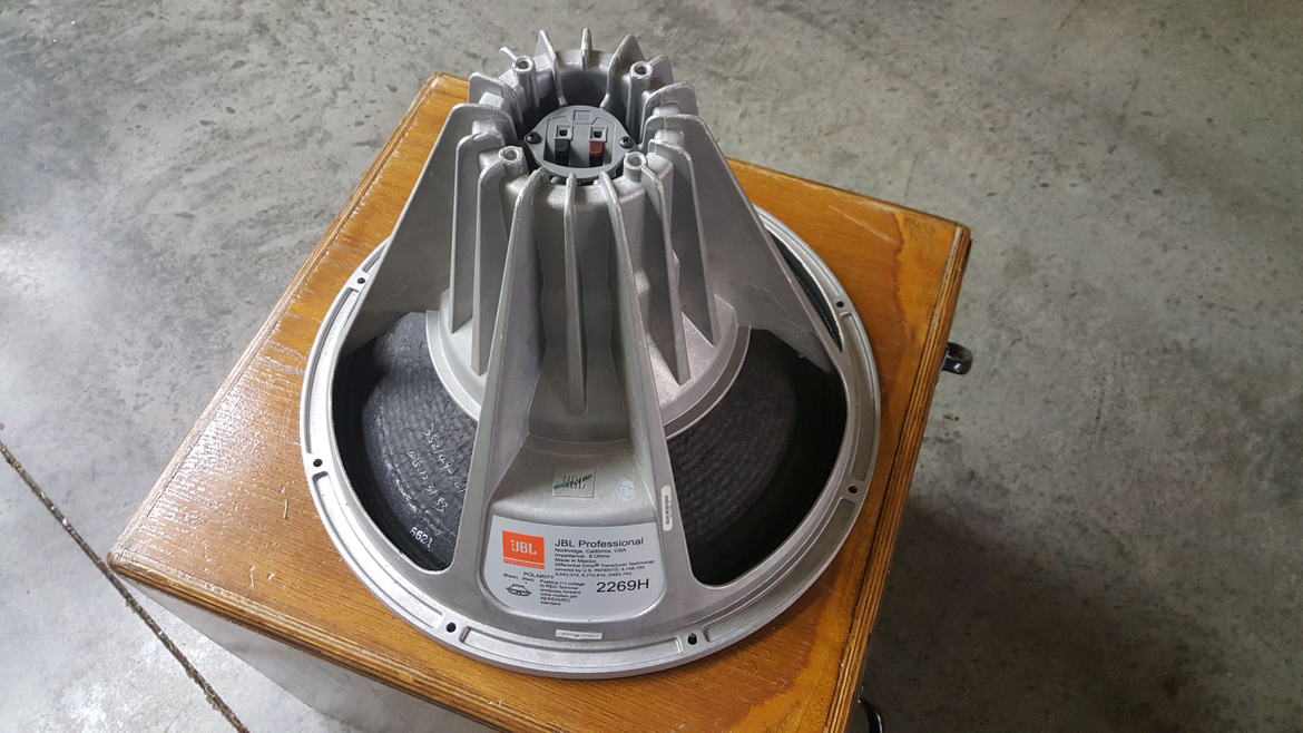

That heat it creates wicks into the surrounding motor (metal plates and magnet). Adding cooling fins to the entire outside of the motor may help reduce temperatures during sustained heavy use like would be seen at a concert. An example can be seen with this JBL driver.

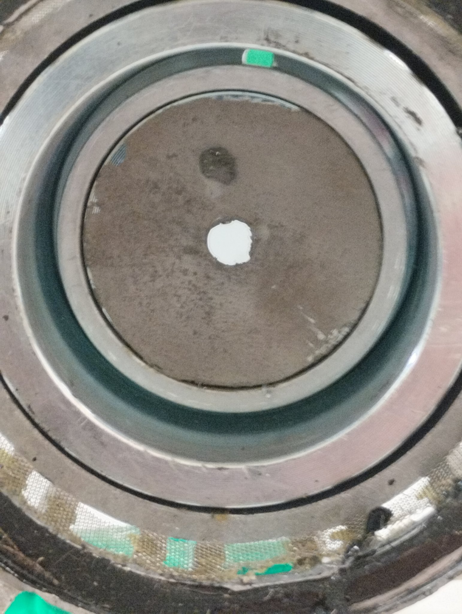

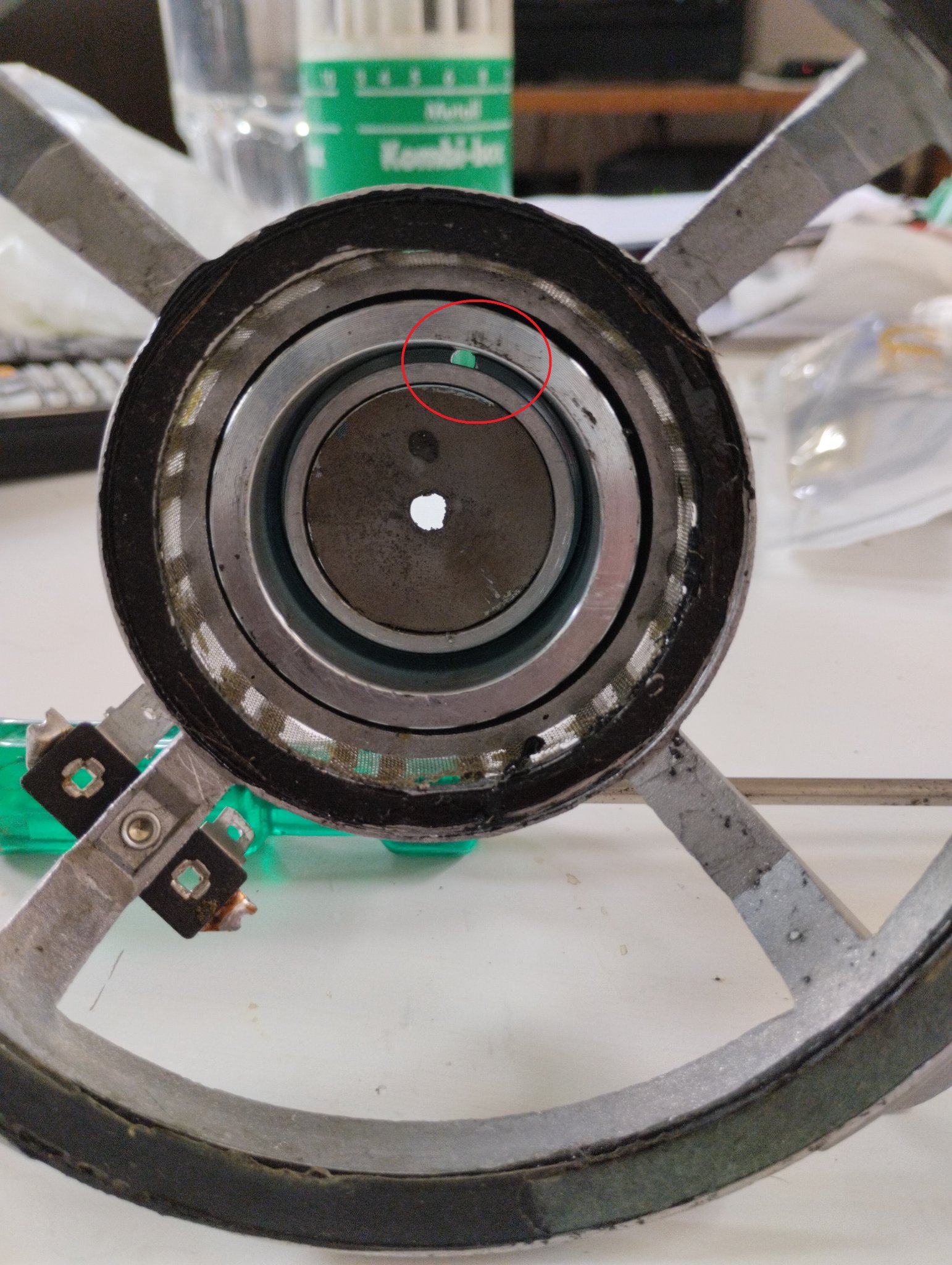

I did a 3 mm drillinghole from behind, in the center of the coils gap. (when investigating a problemdriver)
Maby with 2 hole¨s (one low and one high), you can get small convection movements inside the gap.
Also test if 2 thin copper-pipes mounted in the holes, and leads out of the box (easy to get airtight), make convection stronger.
Otherwise force air carefully through.
Just a theory!
