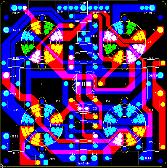

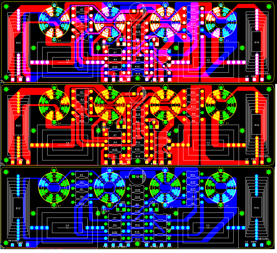

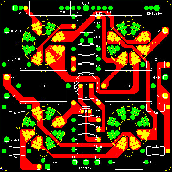

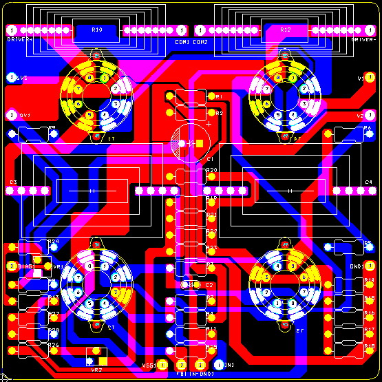

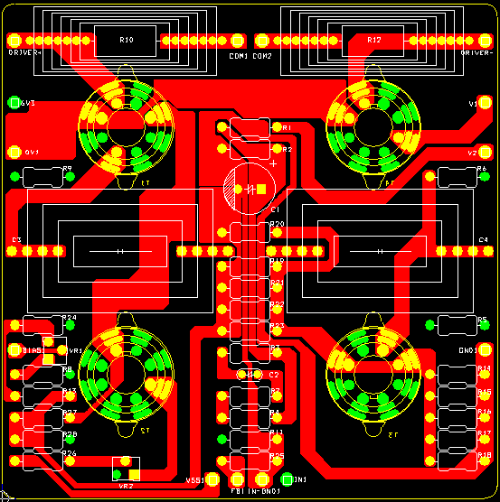

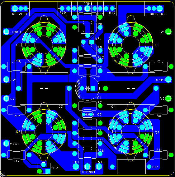

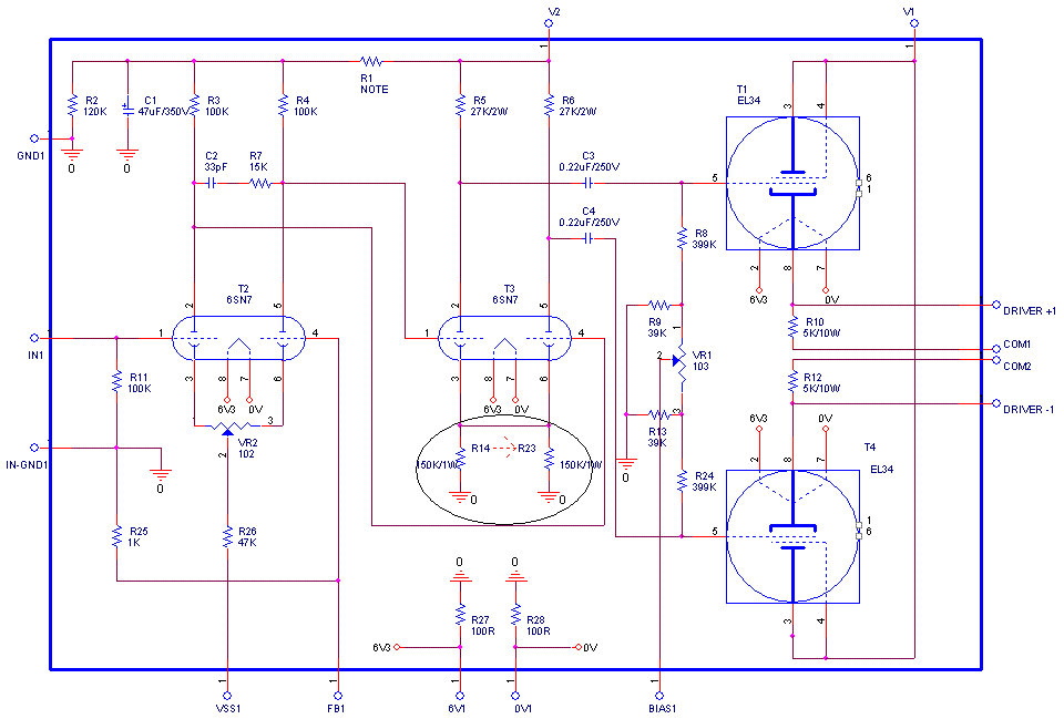

Hi all.
I have project driver of sumo Tubes for anybody.
I used a 6SN7 for pre amplifier,the second 6SN7 for phase inverter,2 EL34 for the driver output katot.
This is schematic.
