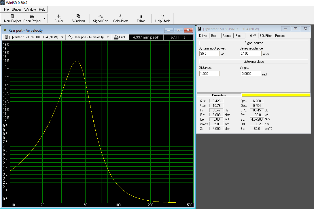

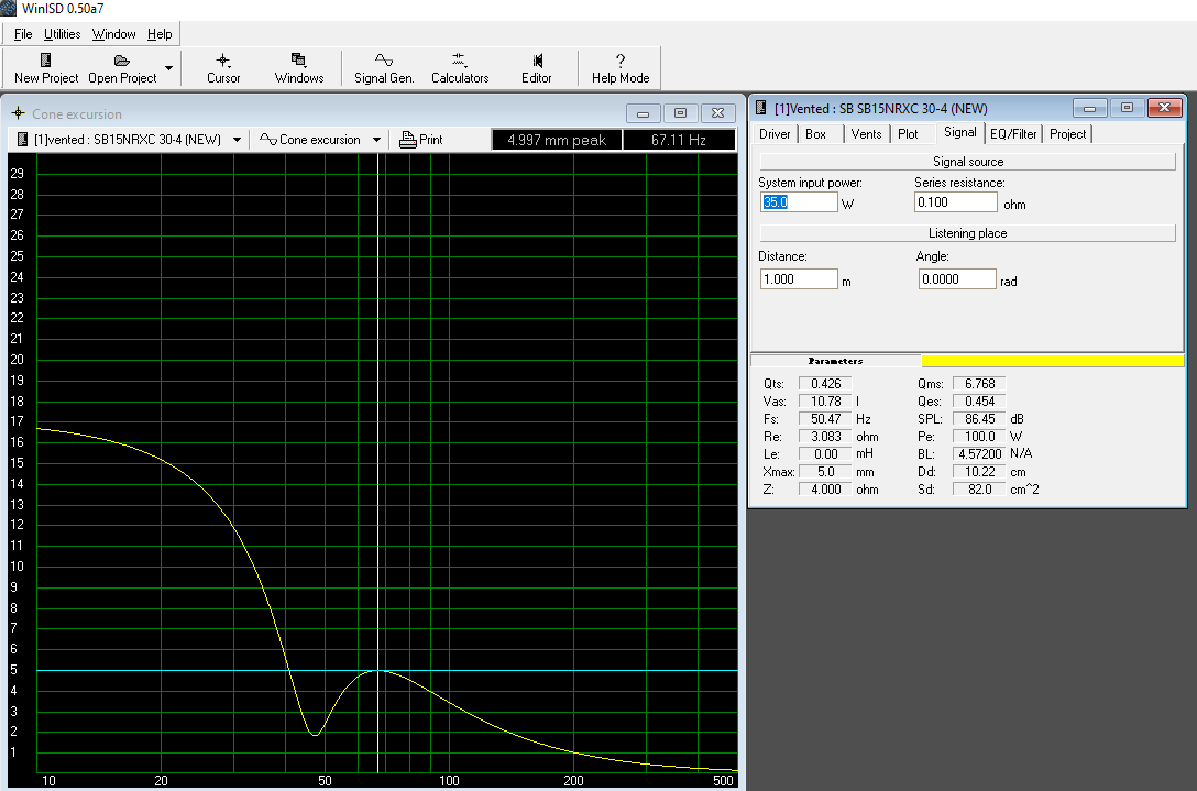

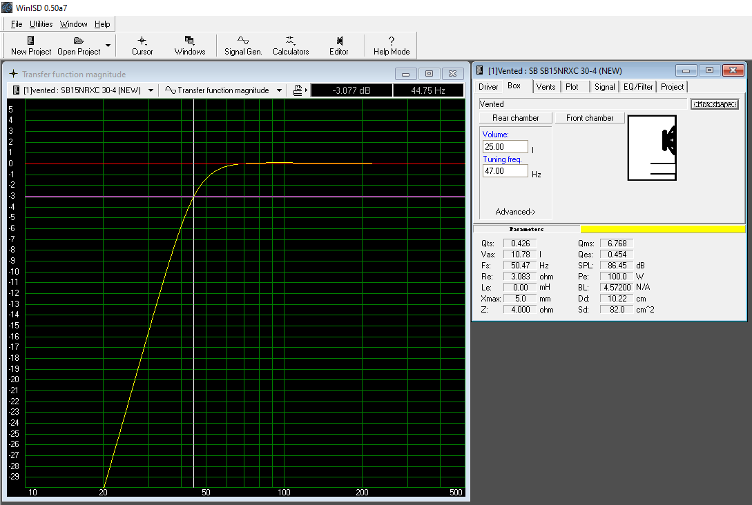

Looking for help with modelling enclosures for the SB Acoustics SB15NRXC30-4. This is a five inch woofer which I will be paring with the SB29RDC-4 tweeter. I have two woofers per enclosure so a 2.5 way is the plan in a 25 litre enclosure according to WINISD. WINISD suggests a 3"x7.5" port which seems big for such small woofers. This will fit in the box but does this seem right?
I have used DATS V2 and the measurements are different from manufacturer specs.. SB give the VAS as 16.7L but DATS says around 10.78L. Fs is also 41hz according to SB but DATS gives me around 50hz for three of the drivers and 57hz for one of them!
I am just a bit concerned to cut a three inch hole in a box but if its normal to be so far off manufacturer specs then I will go ahead.
WIN ISD plots below and any advice from someone who's used them would be appreciated.

I guess some break in using a low frequency signal to exercise the cone, suspension, and voice coil wouldn't go amiss. Does DATS have a low frequency signal generator that can be used to drive an amp to help exercise these new drivers? A couple of hours running should do it, be careful with the amps volume control you probably only want 3mm of excursion at 50Hz or so to help loosen them up

finally about the port, I think Winisd just spits out whatever values keeps the port velocity down below 13m/s at full blast (assuming you entered the max wattage of the woofer as the signal.). So I would treat this as a maximum size rather then the ideal size. especially if you can flair the ends you can get away with higher port velocity without audible chuffing. Secondly realistically how often are you driving the speaker to its max while critically listening. I would enter about half the actual rms rated value for the woofer and see what that spits out and use the nearest round number. In the end I don't think it matters that much as long as it fits in the box with enough clearance (1x the diameter of the port). I may be wrong but I don't think there is a downside to an oversized port.

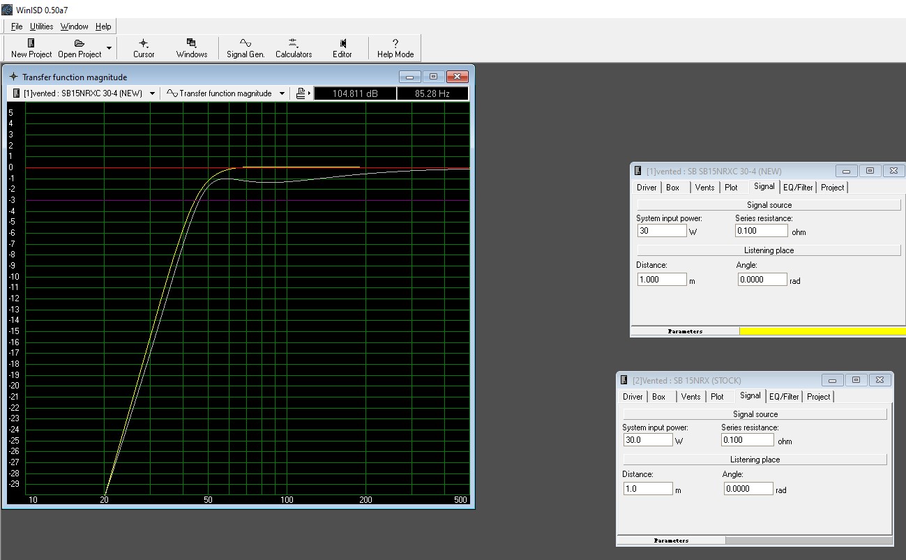

Thank you both for taking the time to reply to my post. I have done some running in but perhaps some more would be of benefit so I will try and test again to see if there is any difference. I think both DATS and REW have signal generators to help so will look into this as well. To this point I have played music through them only at moderate levels. The drivers will be run 2.5 rather than 2 way, that's the plan anyway. If I do end up going 2 way then a series connection to make then 8 ohms rather than 2.
I am also concerned about the 57hz driver and I have contacted the supplier so will try to get this replaced. For info all drivers including the 57hz one passed the rub and buzz test but it just seems to far out. I used the added mass method to test VAS with the smallest weight I could find (14g). The port will have 4" clearance so should be fine for depth. I have just modelled the manufacturer specs and overlayed them with mine and whilst its not exactly the same its not a whole lot different. Cone excursion, port velocity and response are all pretty close. I may be making more of this than I should.
I wouldn't worry about the specs being off if there's nothing obviously wrong with the driver. The cone assembly can't physically be any lighter, so the only thing that can raise Fs is a stiffer suspension. If there's nothing overtly wrong with the spider or surround, I'd say your grouping of 50-57Hz is a reasonable one and the difference from the quoted 41Hz can be chalked up to differences in measurement technique/equipment. I'll bet that the differences once mounted in an enclosure will be inaudible.
