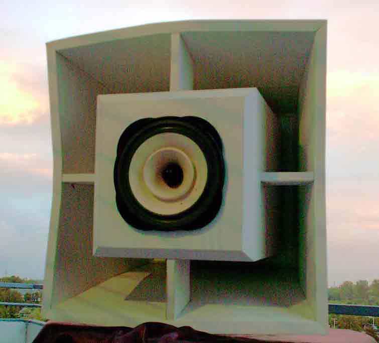

Hello,
this he had in mind.

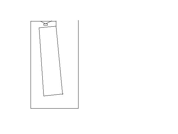

I once built ceiling firing speaker with driver directly beside the relatively small mouth. I wouldn´t say it satisfied me, but there was a clear difference in bass extension when I placed a board between mouth and driver.
Mr. hm, thanks for posting your plan.
I can see how you channel and diffuse the rear wave of the speaker and how the rear wave is horn loaded.
What were your goals in designing this enclosure?
More importantly, given the difficult build, how does it sound?
Hello,
backloaded low-mid horn
with coaxial horn throat and horn mouth
and extrem low mouth membran distance.
and small distance of the horn walls the second
part of the horn, free space in the bend,
sounds very direct, most 8" FR driver gets by softfibre
help below ~800 Hz, 98-103 dB, but only down to ~120 Hz
as an sat horn with active sub ~100 Hz 18 dB.
minimum listening distance 4 m, so more for a large
room, for normal room see my SCHALMEI.
today i prefer my SAXOPHON, no sub needed.
Thanks for the explanation.
I understand the application. The size of the mouth sets the cutoff @ 120Hz. And designed to be used with a sub and/or as part of a multi-way system. So, that is where the minimum listening distance of 4m comes from (?). Certainly, as part of a bigger system, a viable alternative to a large conventional front loaded horn like the Oris 150, since the highs would not be attenuated and less directional.
For a stand-alone enclosure, I suppose by enlarging the mouth I would be able to go lower. But, then it would be easier and less risky to simply go with a proven Fostex style rear loaded horn where the acoustic gain is over a lower bandwidth.
Still very intriguing...

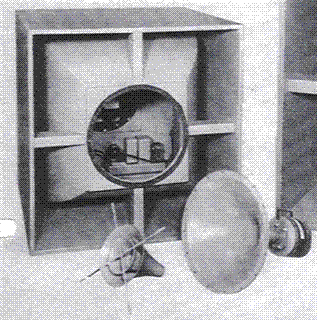

GM, thanks for the pic of the RCA twin power horn.

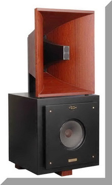

Have you heard this horn? Is there another driver that faces directly into the thoat or is the driver conventionally mounted in the rear of the large horn? I couldn't tell from the picture.
I did a search and read that it was created for an event in 1933(!). I suppose something similar, using "modern" drivers could be built. Perhaps, even scaled down as the original was a 3-foot cube.
Greets!
You're welcome!
Not that I'm aware of.
Yes, the mid-bass horn is a FLH and you can see part of the rear of the woofer in the upper left corner of the opening.
Oh really? Where did you read that? AFAIK it was developed for the '39 New York World's Fair.
Yes, no doubt someone with the skills/patience could make variations of it, though of course to scale it down is to raise its ~70 Hz useful LF BW.
