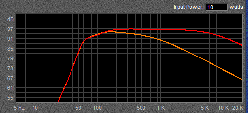

In BassBox Pro they look pretty similar to the Dayton ND90-4 at the bottom, given the same box 2L ported at 70 Hz. Much less inductance with CHN-50, but more excursion and significantly higher rms power rating on the ND90. Based on published parameters, anyway.
