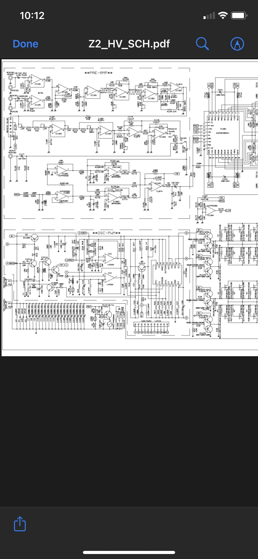

I noticed on this board that R10 has been changed not sure if it from the factory or someone tried repairing it themselfs .
right now it has a 5.1K resistor .
Does anyone know the correct value ?
Also does anyone know what the purpose of this resistor is ?
also should the pins have a jumper on them set to 9 volts ?
it came out of a 10 k amp

That diagram doesn't have the 3-pin header.
It's a typical 11-pin PS driver board. Other similar boards have R10 as high as 18k.
R10 works with the thermistors as well as the threshold voltage for the thermal comparator to tell the amp what the shutdown point will be.
