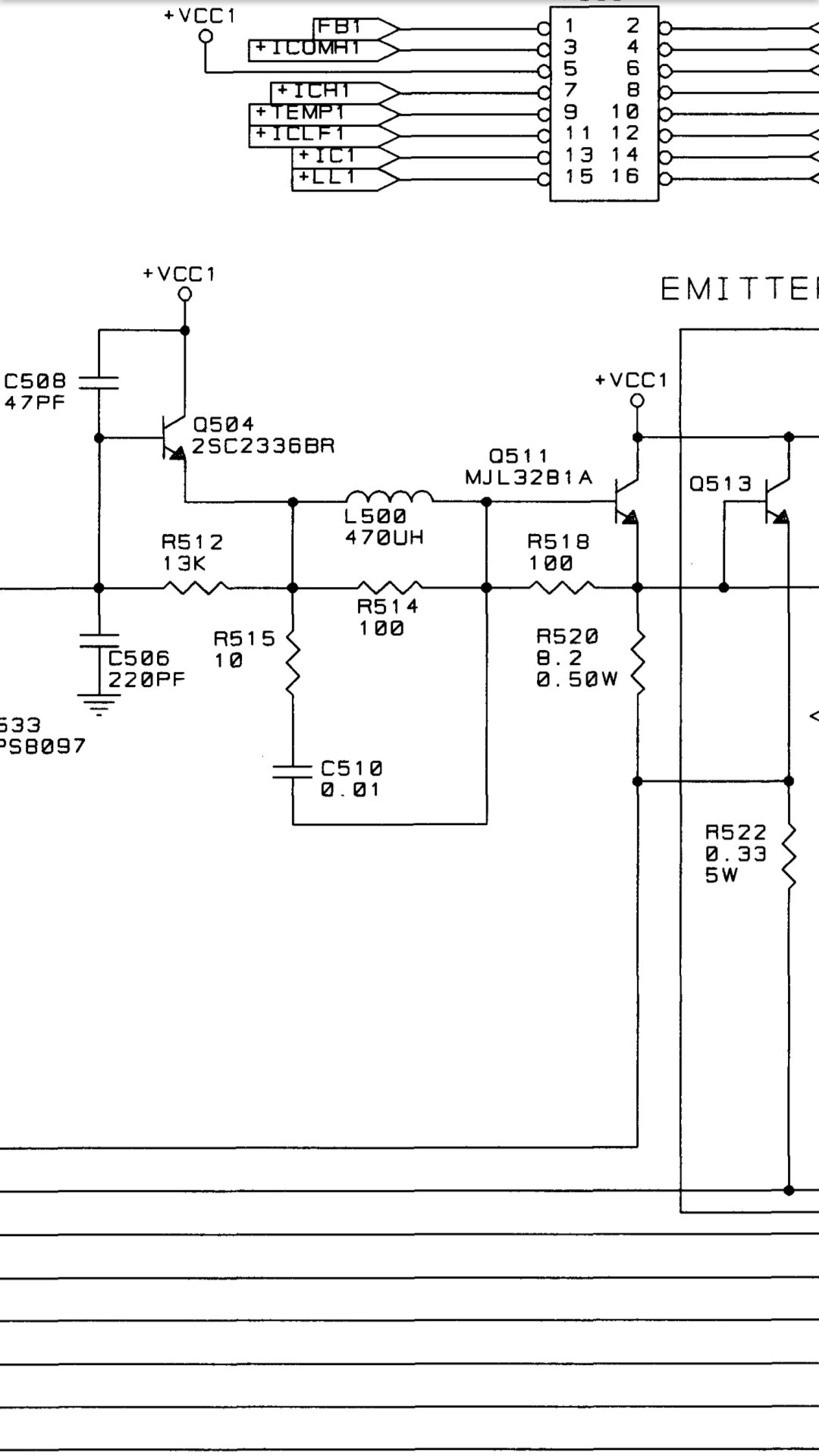

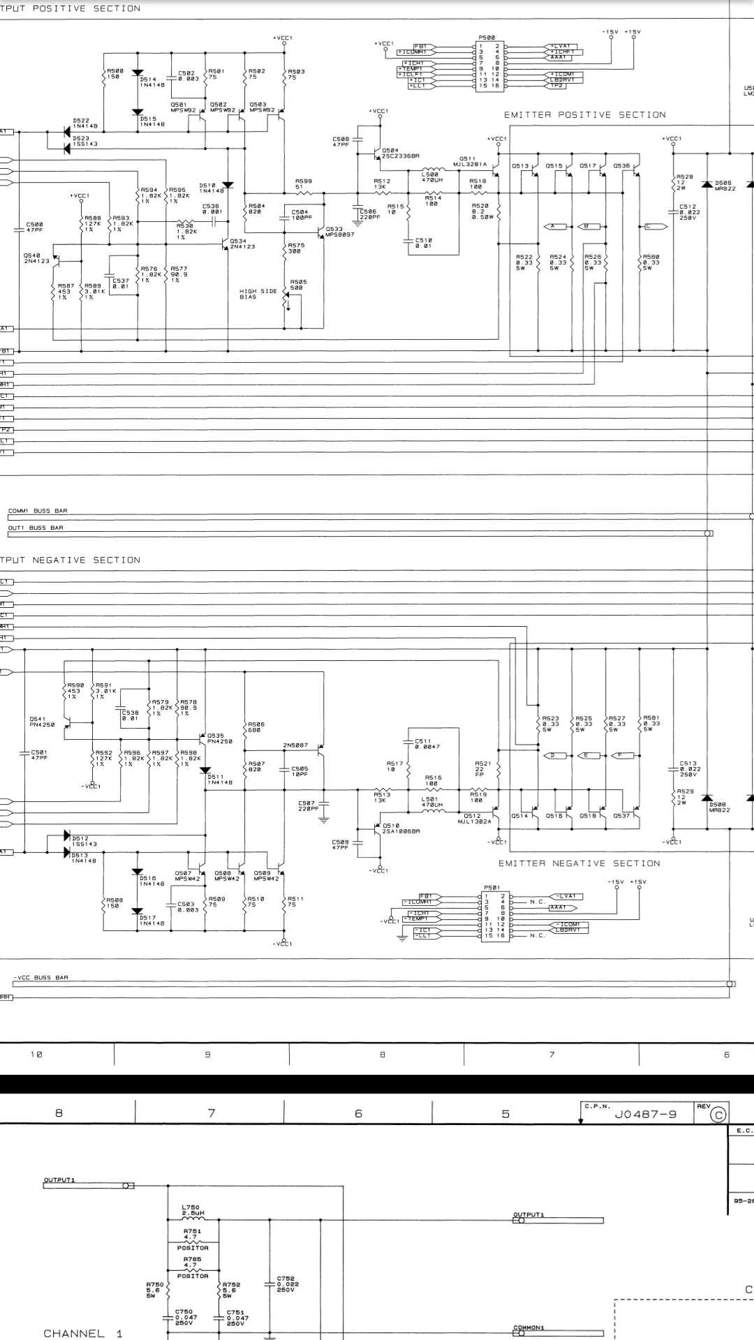

Driver base rlc question
Hi all this is crown macrotechma5000vz diagram
What is this rlc circuit for ?
Thx

That's between the pre-driver and driver, probably mainly for compensation, but it could be handling switching transients, stability control or for controlling clip-recovery or a combination of the above. Its a complicated amp with a lot of protection stuff, making the circuit harder to follow than most. Otherwise it might be instructive to simulate.
