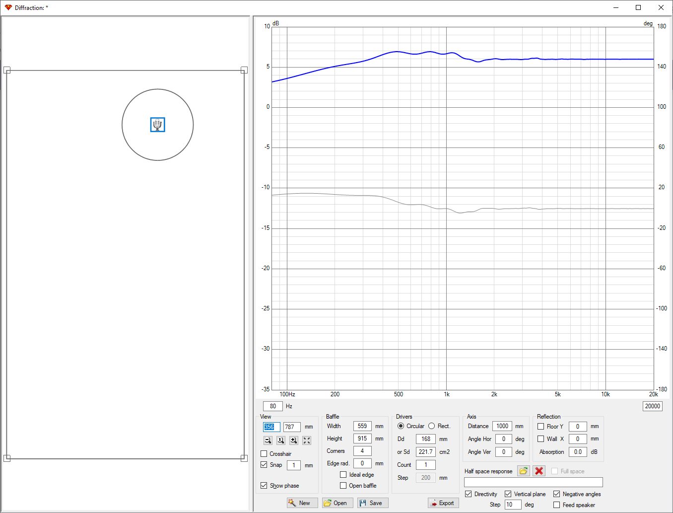

driver at top of box vs lower (on a big sealed)?
I'm curious about your opinions................
I'm going to get a big sealed stuffed box built (golden ratios), think 36" tall x 22" wide x 14" deep.
I would like to get the full range driver to be higher off the ground, as these will be used for low volume movies maybe 1/5 of the time.
I measured my ears @ around 42-43" off the floor and the middle of the TV is near 40".
I see the seas f8 exotic article on TNT had the (expensive) driver right at the top in a 40.8” tall x 9.96” wide x 11.22” deep sealed box (basically a sealed pipe to me) ................
"........Going back to my own Dynaudio Contour 1.8 mk2 speakers after a while was a shocking experience. Their bass sounds quite boxy and over the top compared to the SEAS............"
https://www.tnt-audio.com/casse/seas_exotic_e.html
Whatcha think ?

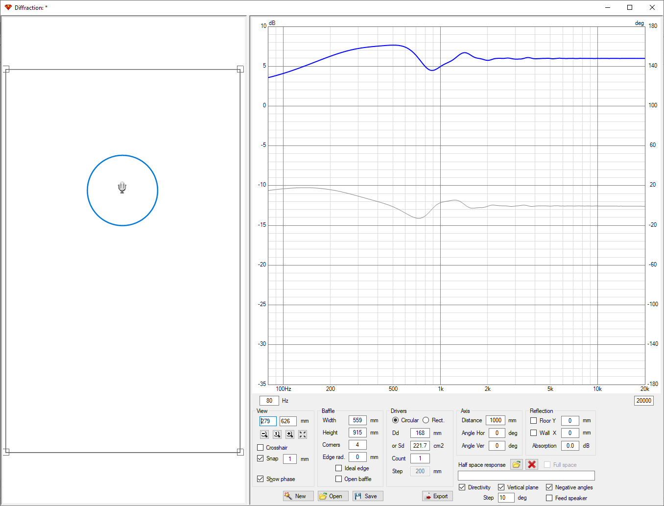

Flattest response would be to the top.
Although the driver has a rising response regardless.
Centered on the baffle would create 2 equal edges and not be considered flat
would require additional offset. Almost non issue with wider baffle in this case.
Reducing fractional data makes things easy and 3 decimal points for 1.618
Doesn't make things easy for quick examples.
Golden ratio for nice even numbers is related to Fibonacci sequence
Ironically 22 and 36 not in the sequence would produce numerous errors.

Not all the numbers will create a flat response for offset, so not all numbers
related to the ratio means " pure magic"
But following the behavior of diffraction and even testing a golden ratio baffle.
The flattest response will ironically fall to the ratio. But not all positions related to the ratio will.
This case simplified with errors 22 x 36 baffle
36
22
14
8
5
3
Thumbnails click to enlarge
Flattest diffraction response on that baffle driver center simple falls 8 inches over 5 inches down
As opposed to the lower option
And simplified sequence with less error
