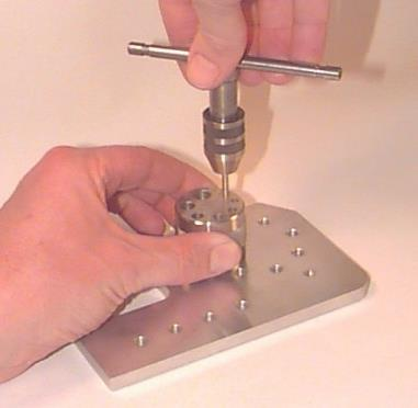

What's a through-hole tap and a blind hole tap? I only use one tap, M3 bit, like the smaller one in the picture.
What's a tapping block?
A tapping block is nothing more than a block of steel or even aluminum with holes drilled into it that your tap just passes through. It guides the tap as you hold it down on the material. Tapping blocks should at a minimum be made on a decent drill press, best made on a Bridgeport type machine. I usually make them out of 1" thick stock, for tiny taps 1/2" would be fine.

I use the OMW tapping block shown below. By using taps with different taper you can make threads all the way to the bottom of the hole (and still start the threads easily) so you get ALL that critical thread depth for good holding power when you later tighten down the bolt onto the device (and into soft aluminum!).

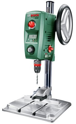

That's another high speed (5000+ RPM) 'jewellery and model-making' drill press. Something like that might be OK for drilling holes in PCBs, but for drilling metal heatsinks and general shop use, you need something like this 22" high drill press as a minimum:
I have one just like that ($50 on sale, new, a few years ago, still under $100 on sale) and it works well on the bench-top when I don't want to go out to my garage where I have a larger floor-standing drill press.
