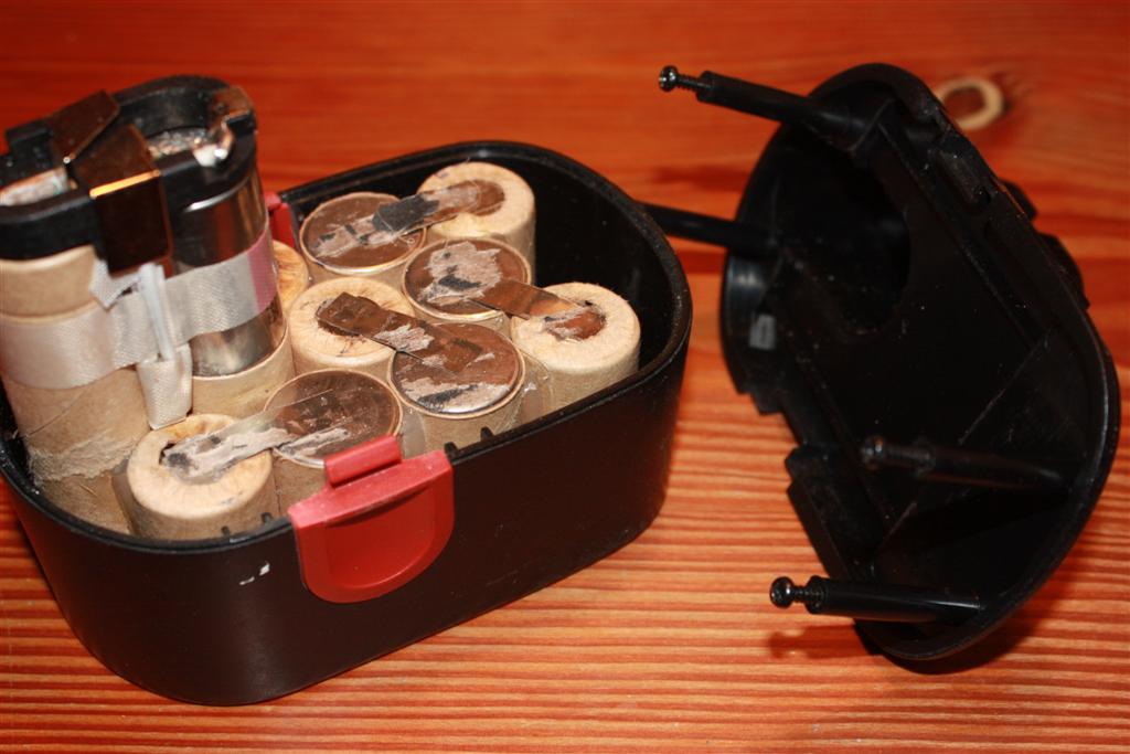

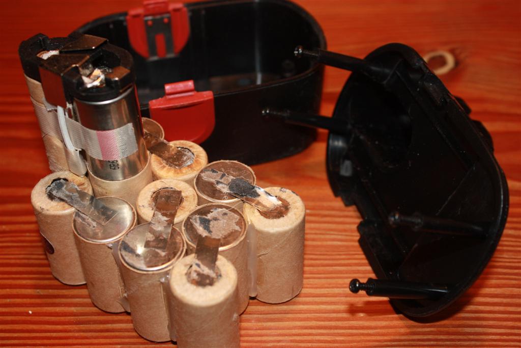

Tinitus, why not rebuild the pack yourself? They usually contain standard size ni-cad cells that can be bought individually.

So, the battery casing is just an "empty shell", with a "standard" battery inside
The cells are usually of a different size than standard and they are connected together with strips of metal that are spot welded on. It's a big deal to re-cell a battery pack for a drill and you'll want to make absolutely sure the cells are in excellent shape. One bad cell kills the battery.

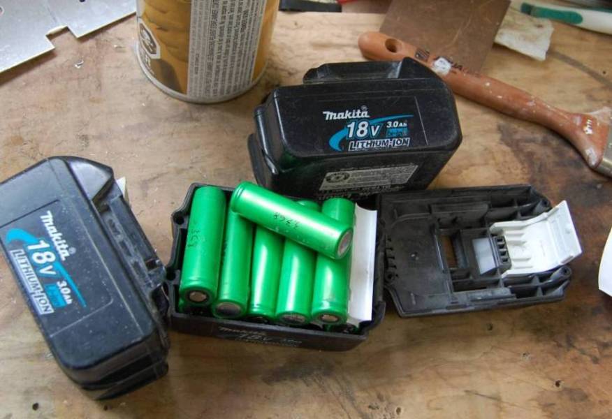

Lithium ion batteries have a relatively short lifespan and will conk regardless of whether they have been used or not. Keeping them cool will greatly increase their lifespan.
I've taken apart a few different packs - DeWalt NiCad has cells that are close in size to C-cells. Makita LiIon look like AA but are much longer and thicker:
Yes of course the 'casing' is an empty shell...Didn't know? Oh well.
The "batteries" are standard size type, D,C, AA.
The batteries usually have the polarities soldered with a small metal tab, in a pack, sometimes taped up. You can tell as the dimensions & voltages give it away as to what size batteries are contained inside.
