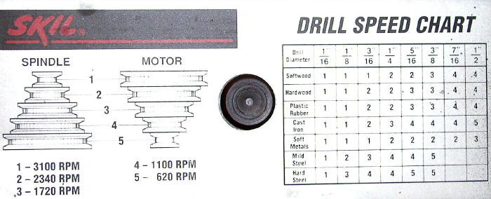

Those numbers are taken directly from the cover of my drill press😉 but I have to agree that holes like 1/2", I prefer to drill at 600 rpm.
However anything like 5mm you can drill at any speed you feel comfortable, even 3200 rpm😉

vpharris said:Here's another chart that you can print out:
http://www.woodmagazine.com/compstor/speedchart.pdf
