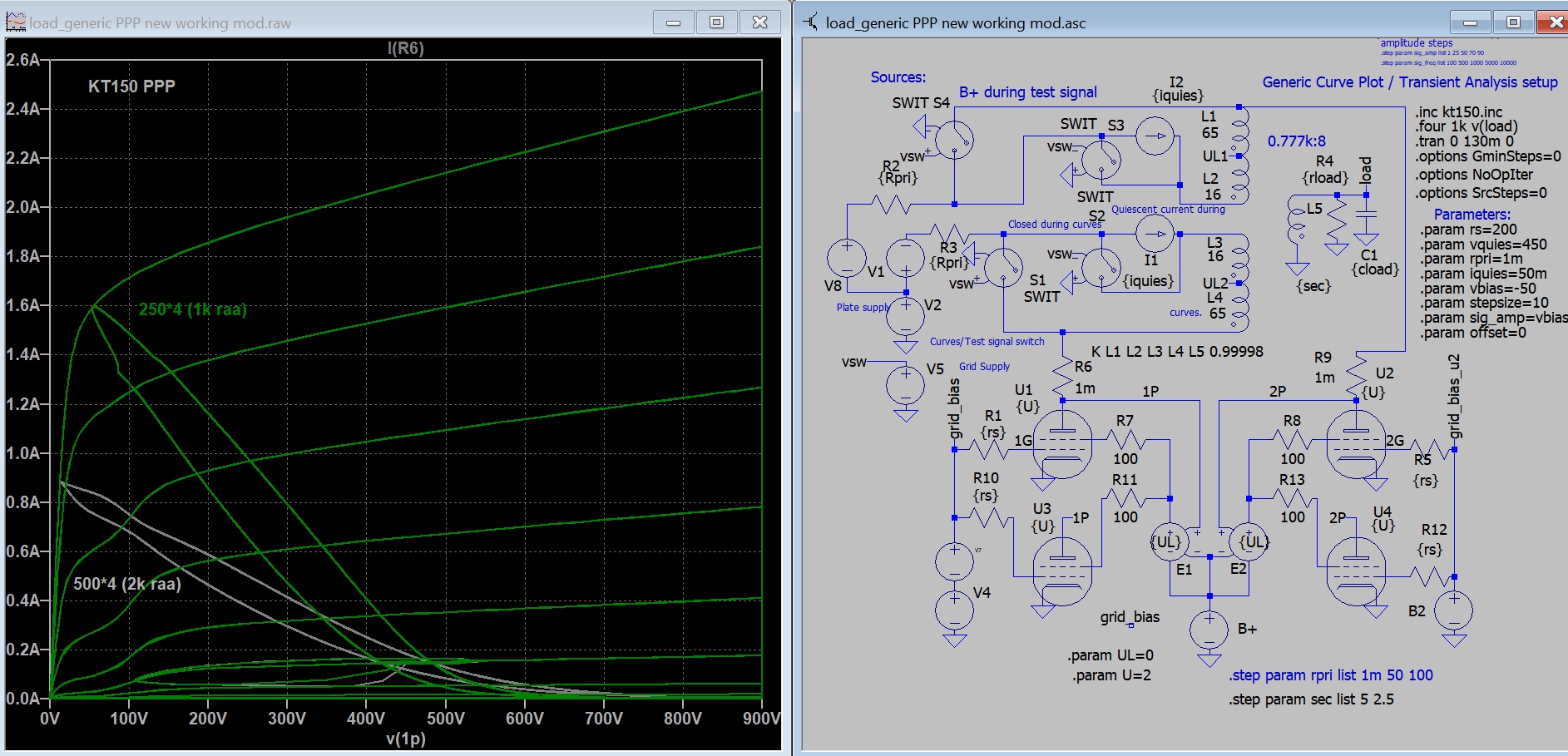

I know this has been covered before, but not in great detail in terms of Zpri. For bog standard PP with two valves we 1/2 the OPT Zpri for class A,1/4 it for class B. So for two valves in parallel does that mean we divide that by 2, EG 1/4 for Class A & 1/8 for Class B?
I feel i should have this straight in my head but for some simple calculations my brain starts going into meltdown,going around in circles.

Each pair of a quad will see twice the impedance of the full quad.
So if you have a quad of EL84, that usually have an Raa of 8 kOhm per pair, the transformer will need to have a Raa of 4 kOhm.
When paralleling tubes, each one/each pair sees a load that's double/three times etc. the OT's nominal primary impedance. The load line has to be drawn accordingly.

Ok,but not by much though, roughly 100 ohms ish.My sim agreed with you, but should take DCR into calculation as it increases output Z, exp for high power output.
Thanks for clarifying.... in which case though that means that anode current is double yes?When paralleling tubes, each one/each pair sees a load that's double/three times etc

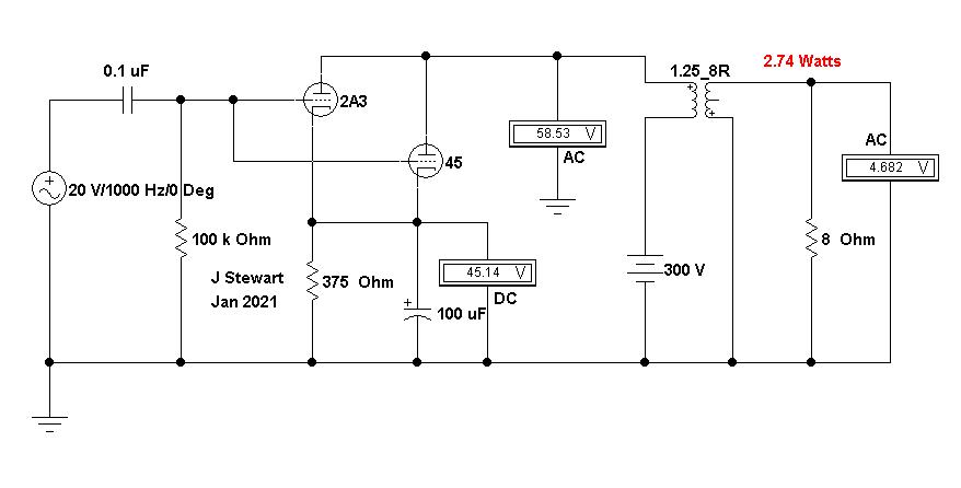

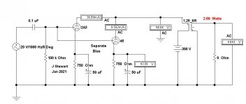

Subbing in a backup tube
What happens if we need to stuff in an alternative to cover for a failure? A 45 does reasonably well in a 2A3 socket. On a temporary basis only.🙂
Not the answer on loadlines asked for but an interesting sideline.
Thanks.That's right, given you keep biasing the tubes the same.
Not sure where your coming from there me old duck, I make all my amps with adjustable bias, adjustable CCS's and what have you = more leeway to make changes.What happens if we need to stuff in an alternative to cover for a failure?

Yes, the 2A3 does almost all of the work.
The 45 is only there to fill the socket.
2A3 rp = 800 Ohms, u = 4.2 (Lowest impedance and highest gain). The Ox
45 rp = 1700 Ohms, u = 3.5 The young Calf.

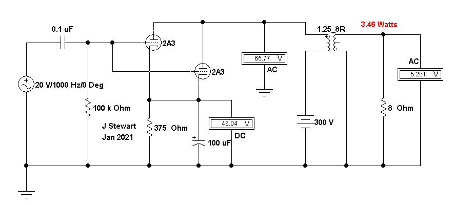

The Sim is not a recommendation for either tube. But easy to shew a comparative result. I could just as easily piked for example PP 6V6s & stuff in a 6F6 as a standby. You appear to have missed the intention of this exercise.🙄
Yep. Using N tubes in parellel is like using a single tube that passes N times the current. Just use the curves of a single tube and multiply the current labels on the y-axis by N.
And divide the load impedance by N times.
And divide the DCR of the primary by N times.

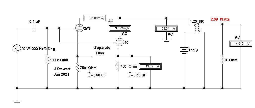

So, according to Kirchhoff the 2A3 is swinging 58,04 - 43,09 = 14,95V? Or should the secondary voltage be included? [forgetting that energy is lost and power dissipated when a capacitor is repeatedly charged and discharged in an AC circuit, power dissipation is reported to be C*V*V*f]. What lessons could be derived?
Double impedance gives 1/4 the current involved;
Half impedance gives 1/4 output voltage.
There is a relation 🙂
