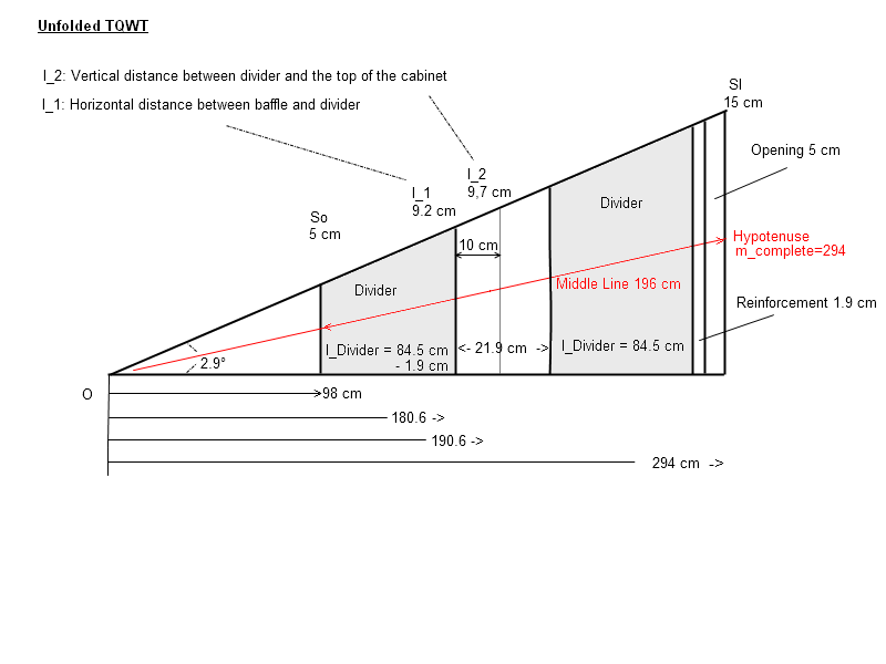

6. Calculation of the Geometry of the TQWT
I will use the Intercept Theorem (Strahlensatz) for the calculation of internal measurements. The included drawing should explain the calculation. First I calculate the length of the hypotenuse (m_complete) of the unfolded TQWT, as that simplifies further calculations:
7.5/2.5 = m_complete /(m_complete - 196)
m_complete= 294[cm]
The angle of the triangle is small (2.9°) so it is not neccesary to seperately calculate the cathetus (for the baffle).
15/294 = l(x) /x
l(x)=15 * x /294 where x is the point on the middle line measured from O.
l(x) is the distance between the divider and the baffle (or the other outside walls)
A(x)= 18 * 15*x /294 A(x) is the Area of the TQWT depending from the position on the middle line
I apply that formular to So (the measurement is already known)
l(x)=15*x /294
x=294 - 196= 98[cm]
#Important: x= length of the hypotenuse - line length
l(x) at So is 5 cm.
Horizontal distance between baffle and divider:
x=98[cm] + 84.5[cm]-1.9[cm]=180.6[cm]
l_1=15 * 180.6 /294= 9.2[cm]
Vertical distance between divider and the top of the cabinet:
x=98[cm] + 84.5[cm] -1.9[cm] + 10[cm] = 190.6 [cm] (simplified calculation)
l_2=15 * 190.6 /294= 9.7[cm]
Now I can calculate the total internal height of the box:
H = 9.7[cm] + 84.5[cm] + 1.9[cm] + 5[cm] = 101.1[cm]
The internal dimensions of the box are 101.1 x 18 x 21.9 cm

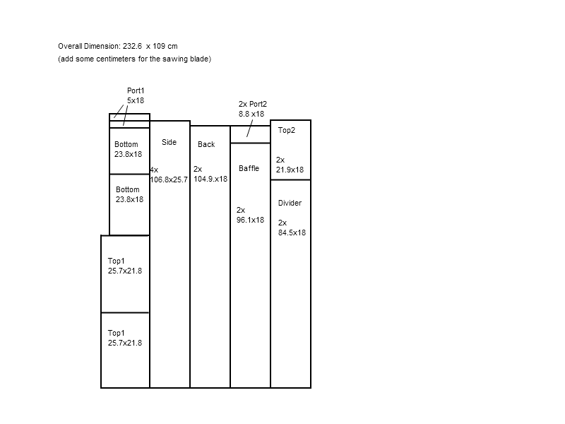

9. List of Parts
2 Back: 104.9 x 18
2 Baffle 96.1 x 18
2 Divider 84.5 x 18
2 Bottom 23.8 x 18
2 Top1 25.7 x 21.8
2 Top2 21.9 x 18
2 Port1 5.0 x 18
2 Port2 8.8 x 18
4 Side 106.8 x 25.7
Thickness of all parts: 1.9 cm
The list does not contain the wood for reducing the port.

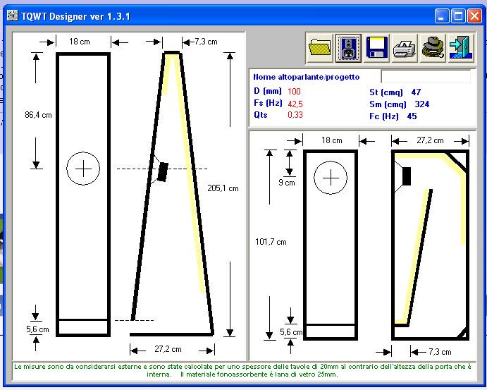

I always use ABMADE to design TQWT
This is a calculator from Italy? I tried it, producing pretty strange results:scratch:
Dave, results from the online calculator in the link I´ve posted base on the MK formulas. I saw a comparison between the calculator and the sheets, pretty much the same. It would be nice to have the alignment tables implemented in some sort of self-contained software in the future to make it easier to work with. I would gladly pay for something like that.😎
There is a construction picture in the calculator link on the right that looks like a ML-TQWT design.😕 Enclosure dimensions don´t change, only "internal setup"... maybe worth to experiment with.
