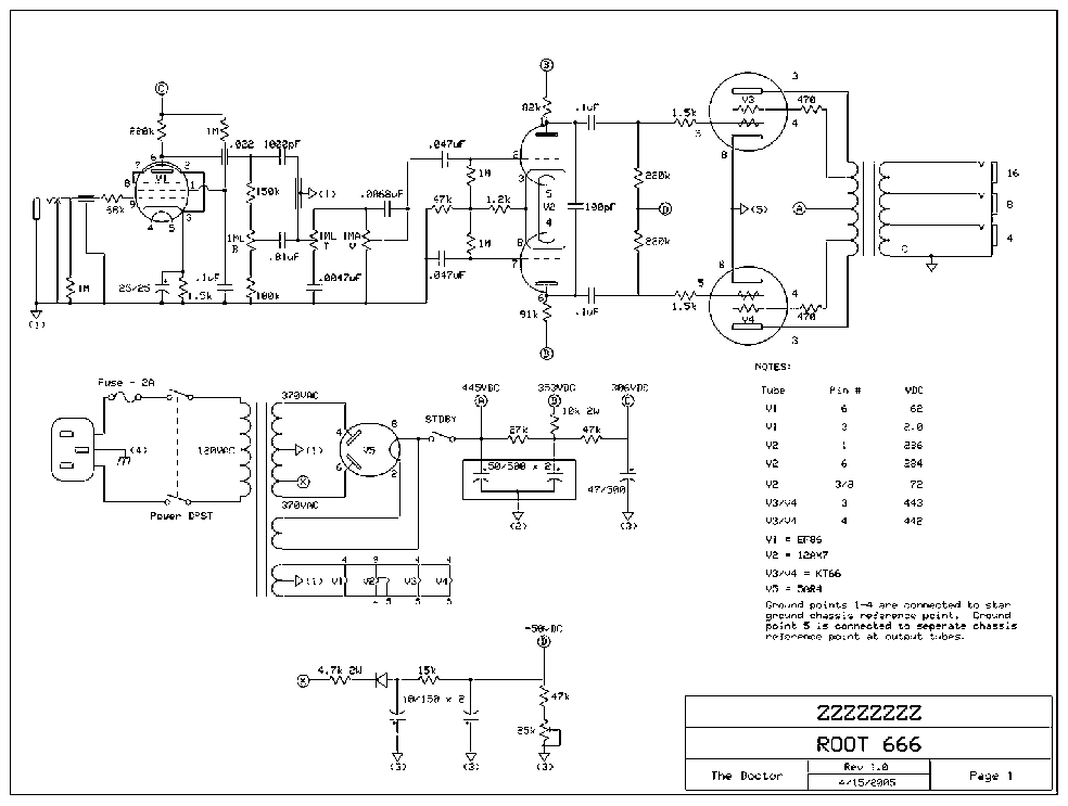

I think it unlikely, but does anyone have a schematic for this amp, ('cause it looks sweet)?

As for a diagram, I'd say it's probably a Mullard 5-20 circuit but with KT66 instead of EL34. Standard stuff.

Actually I don't think it is exactly like the Mullard 5-20, first of all having designed a few guitar amplifiers for a living I believe that the tone stack is interposed between the EF86 and the 12AX7, secondly it is clearly mentioned that the amplifier does not use feedback back to the phase inverter.
I would try running the EF86 in current starved mode for the most gain possible. In this application the volume pot on the guitar is probably going to determine whether or not you overdrive the EF86 and by how much. Place the master volume (1M ohm pot) after the tone stack. The master volume will determine by how much you overdrive the power amp when desired.
A very common guitar power amplifier topology is a long tailed pair driving a pair of tetrode/pentode connected output tubes. In this case because feedback is not used I would assume some extra care has been taken to assure good balance on the plates of the LTP. Plate resistors vaues would be chosen for highest possible gain, and might differ to assure approximate balance in the driver stage.
Not unlikely that fixed bias was used on the output stage. Bias resistors would be as high as allowed for this topology. I'd go for 220K resistors and limit dissipation to less than 25W.
Coupling caps should be sized to reduce the likelyhood of blocking distortion and might range from 0.015uF - 0.047uF max. Tetrode connection most probably and right off of the B+ at the point feeding the output transformer. (There are a few UL connected project guitar amps, but I have not heard one recently. UL might be better for damping in the context of an amplifier without overall feedback. I 'd try it both ways frankly.)
Power supply probably not very stiff using something like 32uF input filter cap max. (my guess commonly available JJ cap or similar would be used.) I'd aim for right around 400V under quiescent conditions
The tone stack would most likely be modelled after the Fender/Marshall stack (nee Western Electric)
The tone stack calculator software at Duncan Amps should help you to design an appropriate tone stack.
These are best quesses on my part, reading between the lines in the marketing copy. Small companies sometimes give things away in their marketing copy if you look closely enough.
As always YMMV, and good luck!

I'm pretty sure you don't want the 5-20 design, although there are hints in it of what you need to do.

I found this somewhere, but I'm not certain of its accuracy. It is similar to a Mullard circuit, but has no feedback, fixed bias and a tone stack between the input pentode and splitter. The treble control on the tone stack looks like it's wired backwards. It looks like a good starting point for a guitar amp, but I would experiment with the 6.8n bright cap on the volume control if it sounds too harsh
kiwiandy said:I found this somewhere, but I'm not certain of its accuracy. It is similar to a Mullard circuit, but has no feedback, fixed bias and a tone stack between the input pentode and splitter. The treble control on the tone stack looks like it's wired backwards. It looks like a good starting point for a guitar amp, but I would experiment with the 6.8n bright cap on the volume control if it sounds too harsh
Looks very similar to what I was thinking. The tone stack is a bit odd, but I believe the treble control provides cut against the 6.8nF cap in the volume control circuit. The effect of that cap is less as the volume control is turned up. A bit odd, but the guy is well respected in terms of amplifier design and may know a thing or two about voicing his designs that we don't ..
