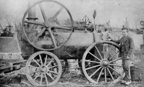

Unlikely story, where was the coal?
Wood yes, from the forests, as fuel, that is possible.
And water, they need lots of clean water.
And he lived in remote areas, steam engines are kind of difficult to haul around.
Heavy in weight compared to internal combustion engines....you would need rail tracks or a lorry.
He died in 1873.
If you look it up, the old steam engines went through lots of coal, the stoker on railway engines had to be strong, they needed to send hundreds of kilos every hour...
We had steam engines here when I was a child, a meter gauge loco would need many tons of coal to go for the 7 hour journey to Delhi from Jaipur.
And water does not freeze so easily in most of Africa.
This would have been a relatively small engine. The expanding exhaust of a steam engine is very cold.
Only if expanded to a vacuum. This is routine in BIG steam engines, factory size and larger. That's what the cooling towers, or ponds or rivers, are for, to cool the condensate. Holding a deep vacuum (no back pressure) is key to turbine efficiency.
Vacuum condensation does not make much engineering sense for smaller 'portable' engines. The condenser and its ancilaries are typically bigger than the engine and not cheap. It has been done occasionally to reduce the fog and conserve the water. Stanley Steamers in the UK were operated with condensers due to fog-law.
Without a vacuum condenser, steam into atmosphere will cool to 100/212 degrees and go to water, which cools more slowly (dense per surface area).
I do see the resemblance to compressed gas release. CO2 will expand to dry ice. But it is cooled to ambient after compression, lots of time for energy to be released before expansion.
Compressed air engines do have trouble with ice in the exhaust. (Is that maybe what you read? Compressed air was used for drilling in the diamond fields but that was distant in time and space from Livingston.) I never heard of a cold steam exhaust.
It seems we are getting confused between steam turbines and steam engines...in engines steam pushed pistons, and the exhaust gases were spent steam.
The pistons worked crankshafts among othere things...
I never heard of freezing cold exhaust from a steam engine either...
"..the exhaust of the steam engine was used to air condition the house to great effect."
Unbelievable.
A thermal engine whatever fuel or piston or turbine cannot give a temperature below ambient.
It makes mechanical energy from a heat source and a cold sink. Here comes, CARNOT and the second thermodynamics principle.
The cold sink is the condenser cooled by the ambient some with the trick of water evaporating.
The evaporating gives some cold, the thermal engine does not.

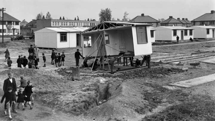

My first family home when a child was a prefab (prefabricated building), erected after WW2 to alleviate the housing shortage.
It came with all the mod cons, including a gas powered fridge.
