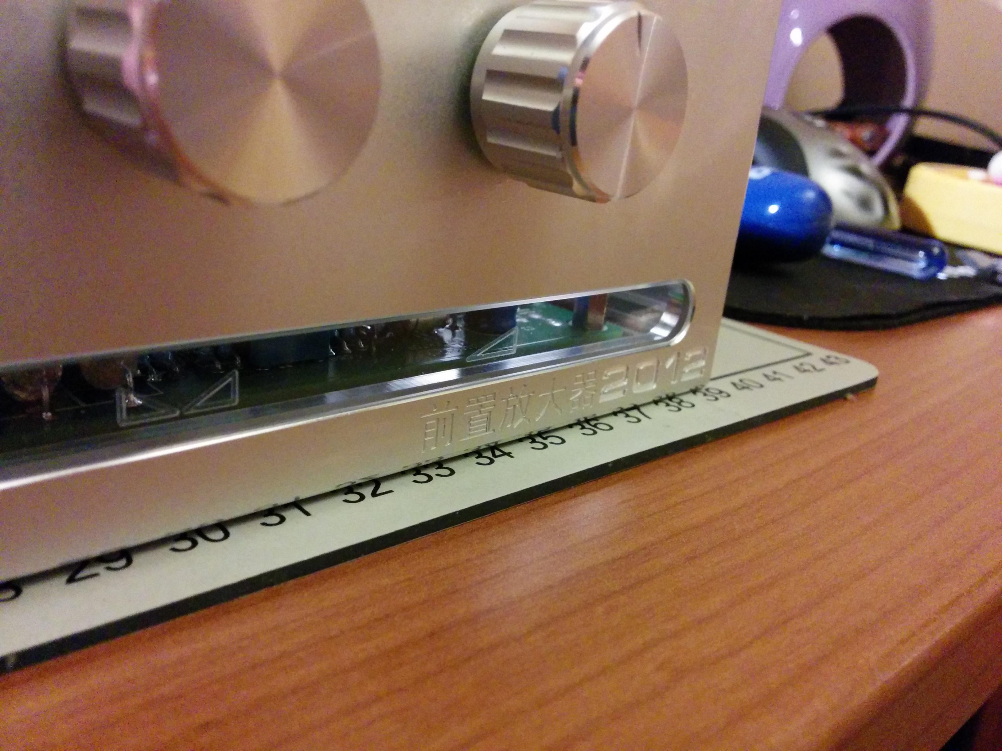

More info...

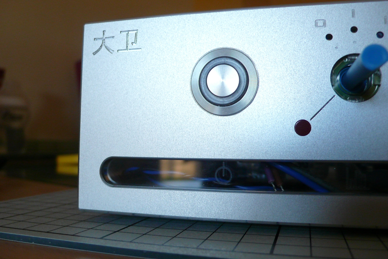

Forgot to mention: I'm building this preamp for my father-in-law who is Chinese, so all the engravings have to be in Chinese. I am using Front Panel Designer to do the panels and I am trying to achieve a screwless look. The tiny toggle switch on the front panel is the tone defeat and I re-made the rotary switch PCB to introduce some cool lighting effects. The long acrylic panel show the control ledgends. The knobs will have illumination around them. The red LLLL LED is not lit - it's just the desk light illuminating it from behind 😀
Dave.
Dave.

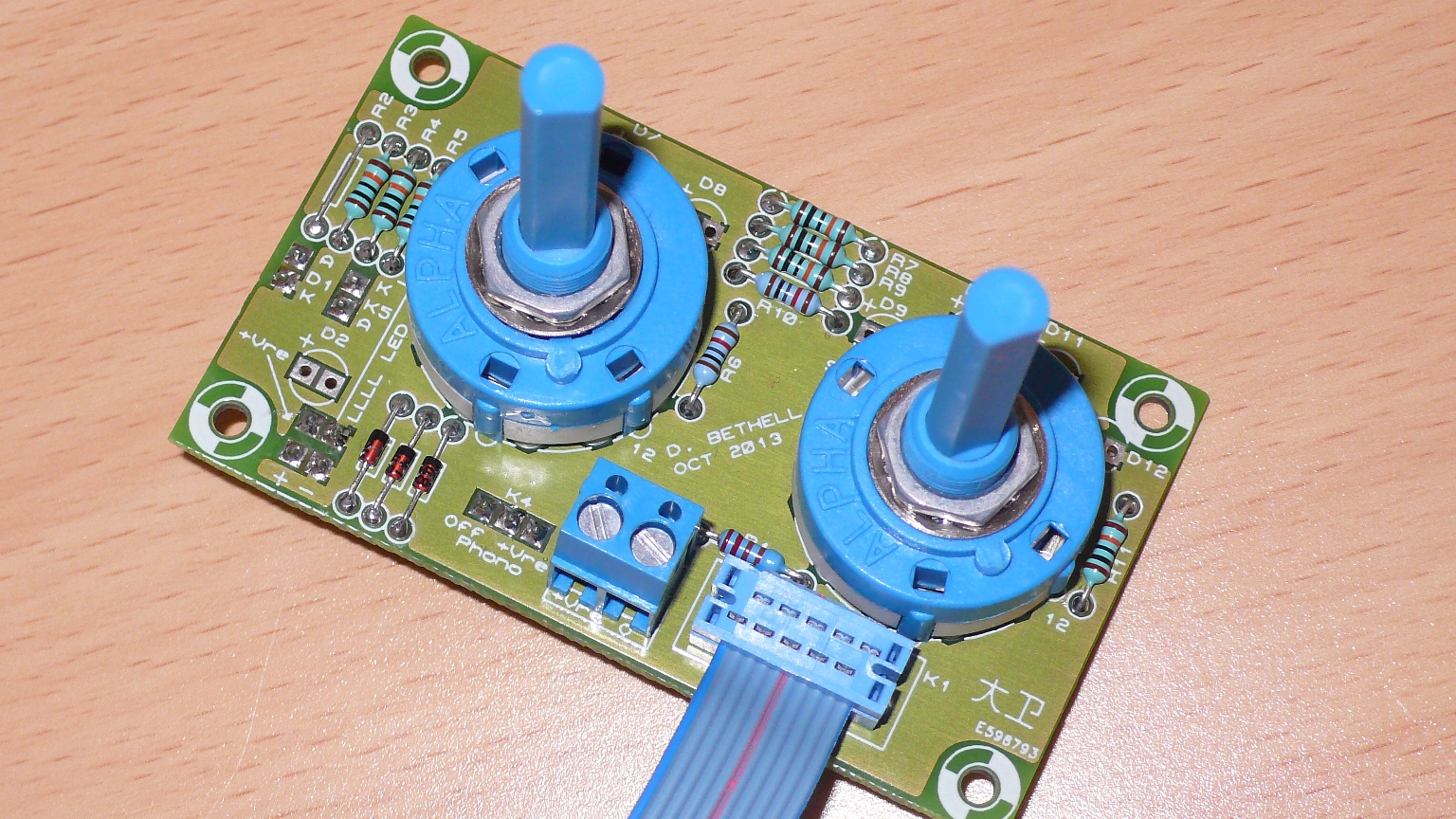

If you'd like, I have made the rotary switch PCB better - the switch alingment now makes sense and I added provision for LED illumination for each selection. All selections will light, but the selected one will be brighter. (Tried it out on breadboard, I haven't powered the real thing yet 😉). I have the gerber files for the new PCB...

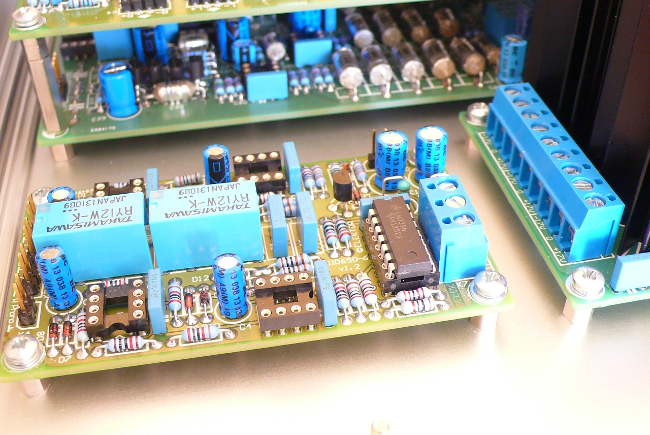

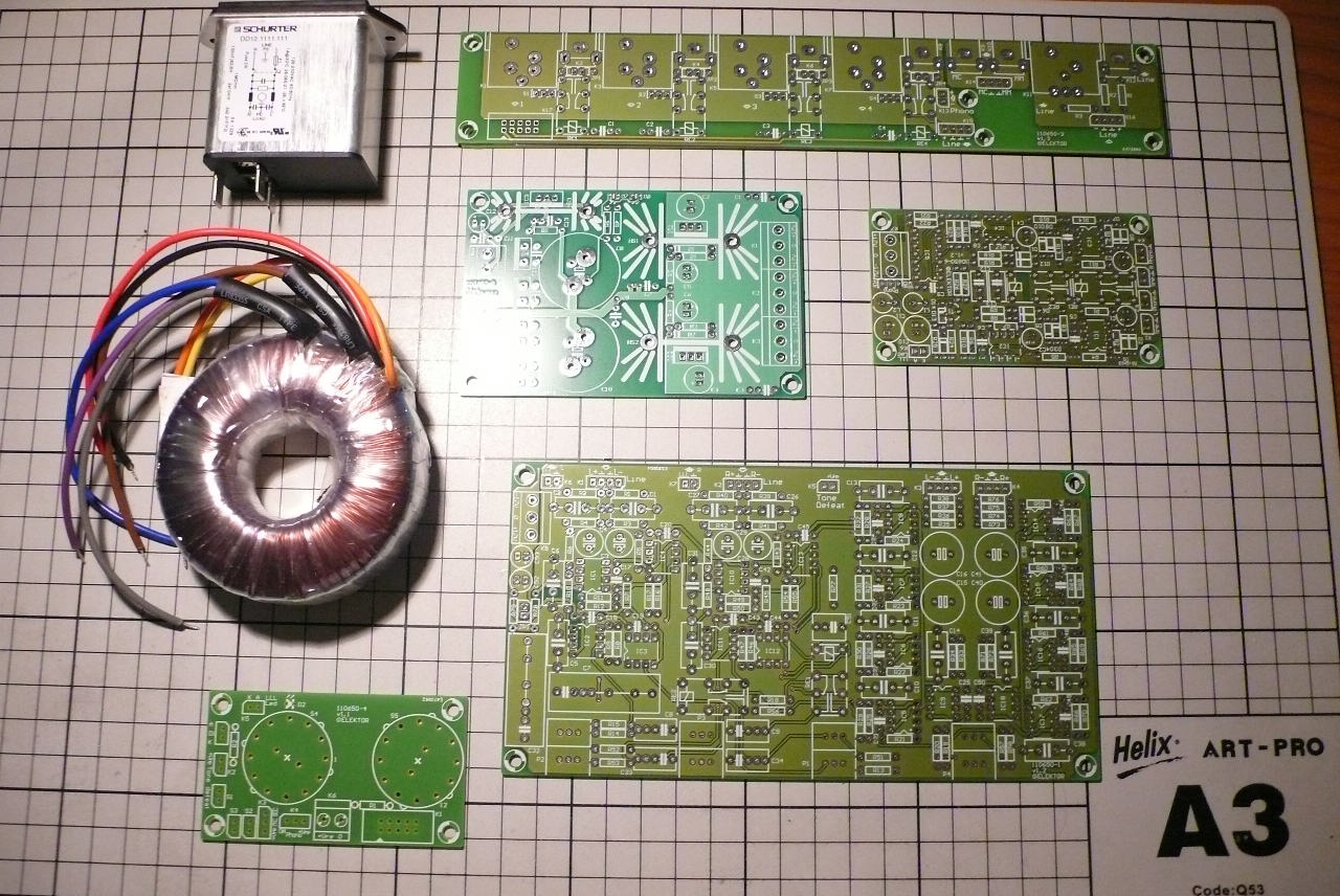

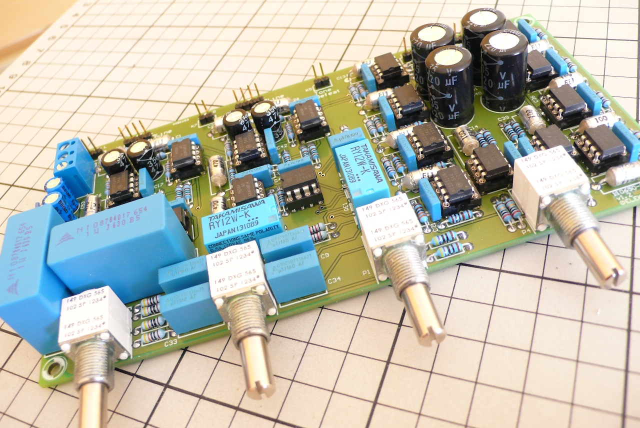

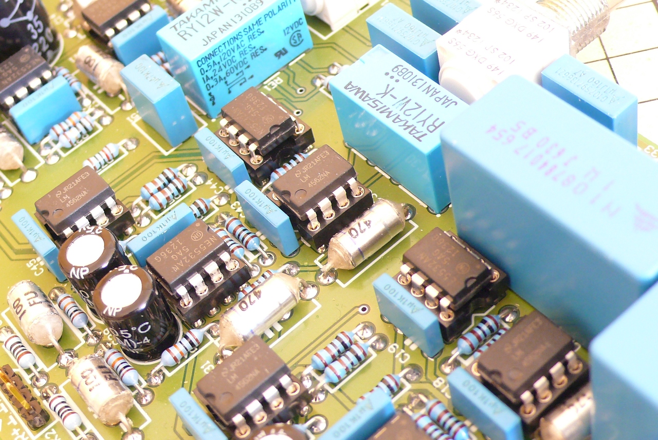

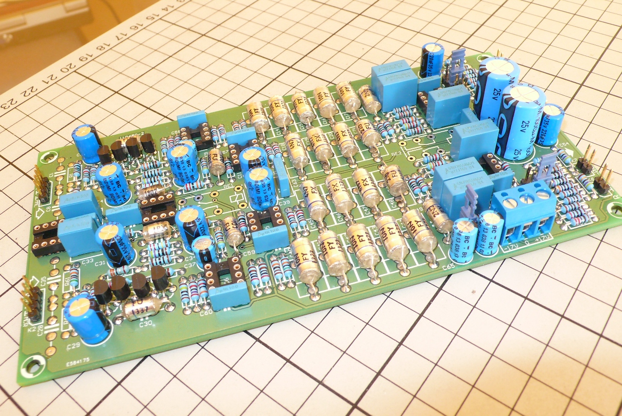

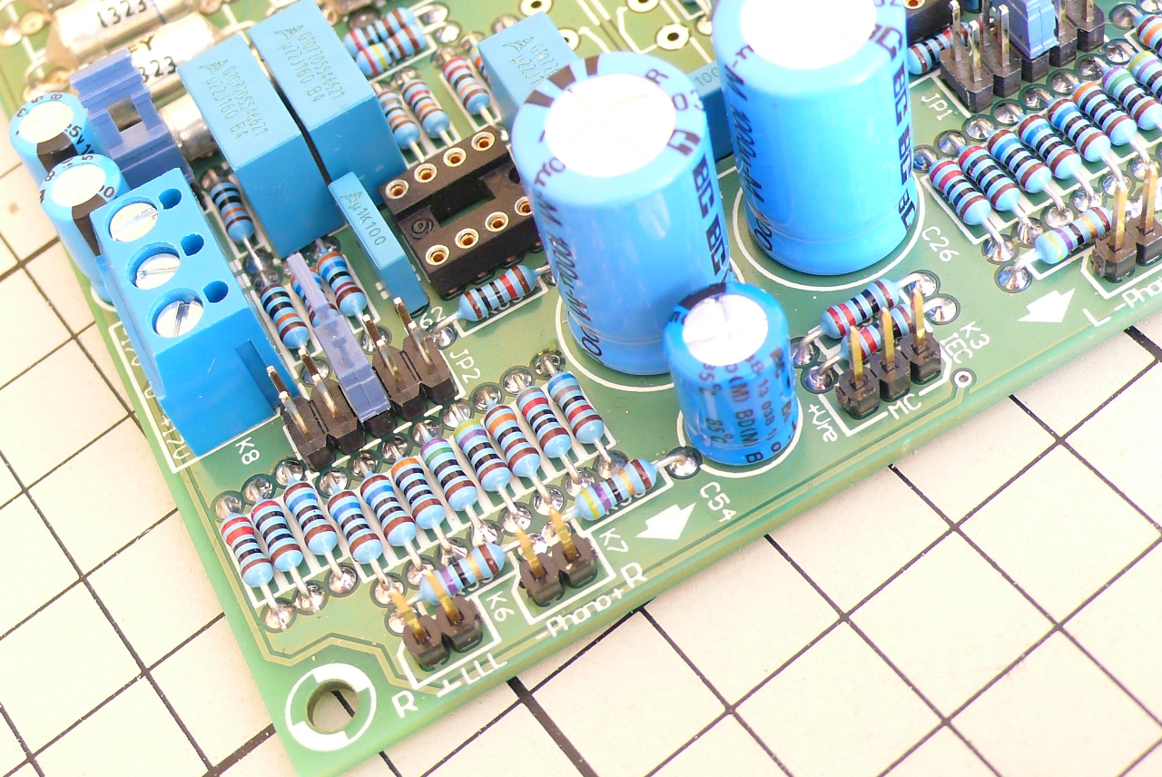

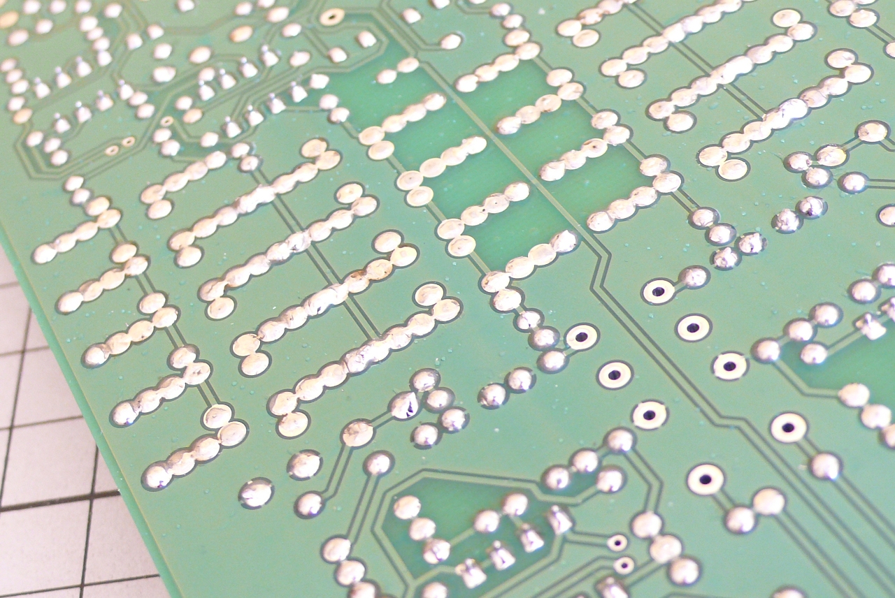

PCBs
Here are the photos I promised (I will have to load them slowly across more posts)...

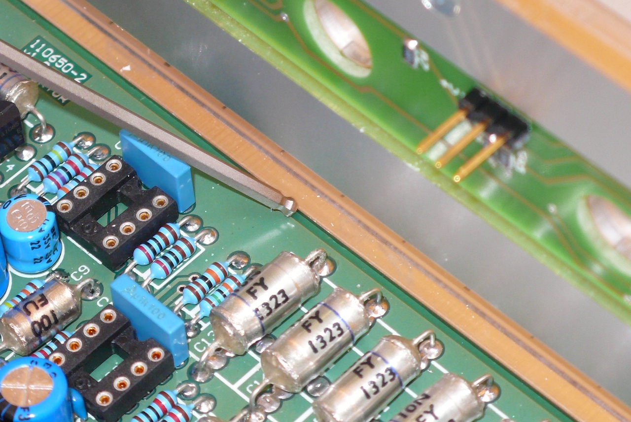

I started the build back in September last year with the boards from Elektor and decided on a layout. It took some time to populate the boards and design the panels.
More to come...
More to come...

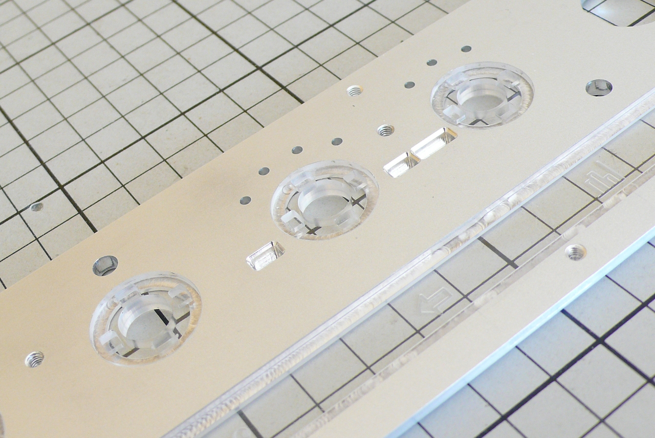

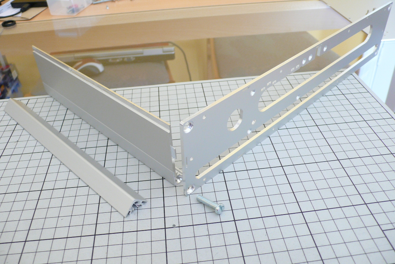

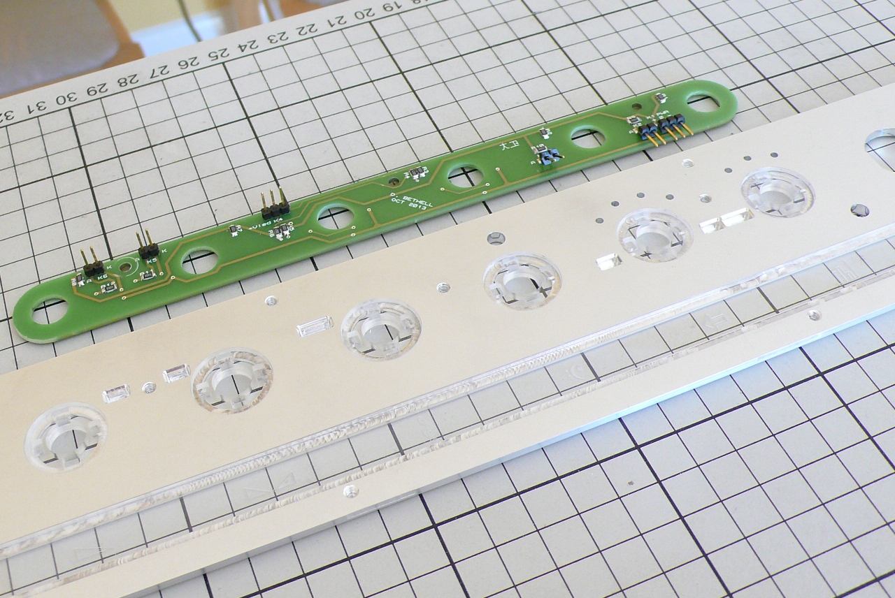

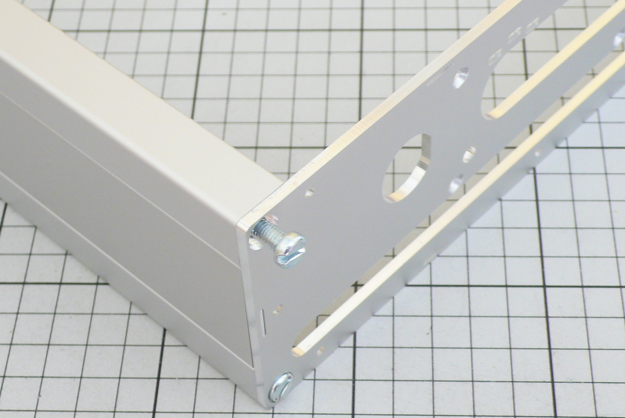

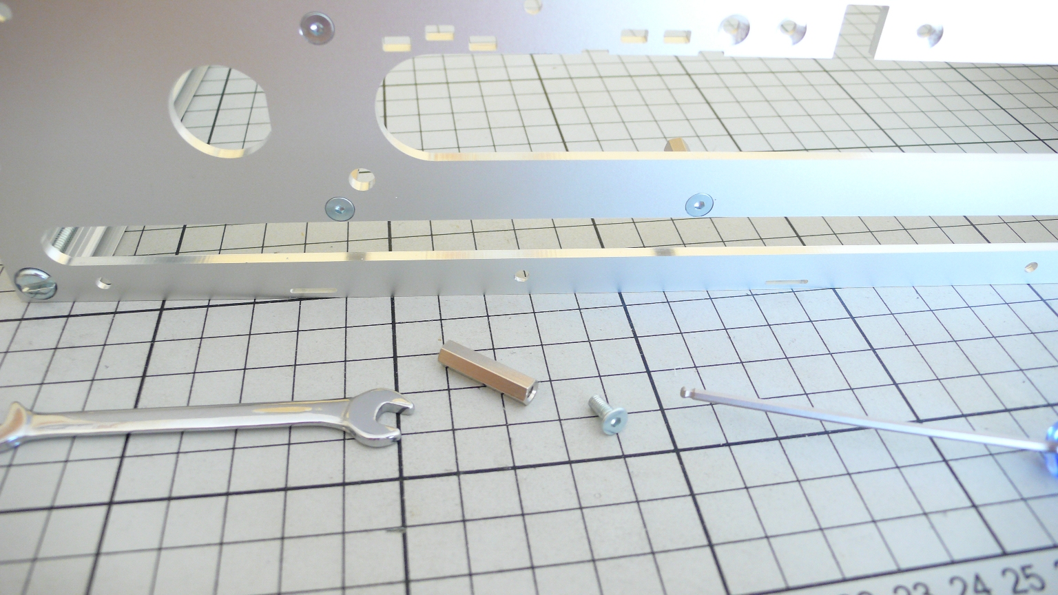

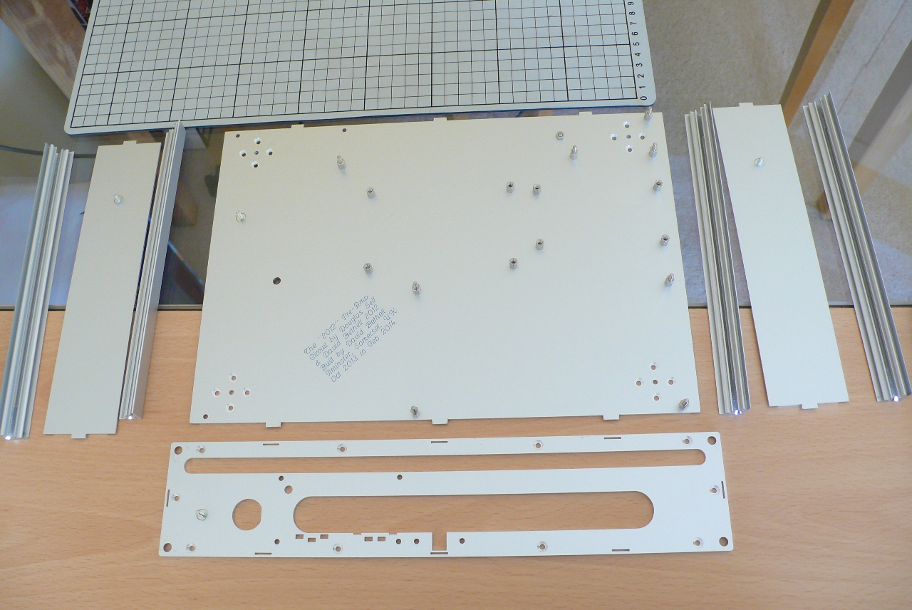

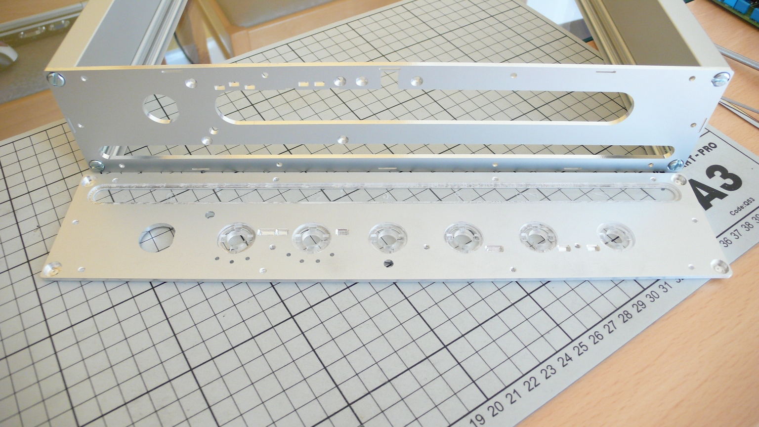

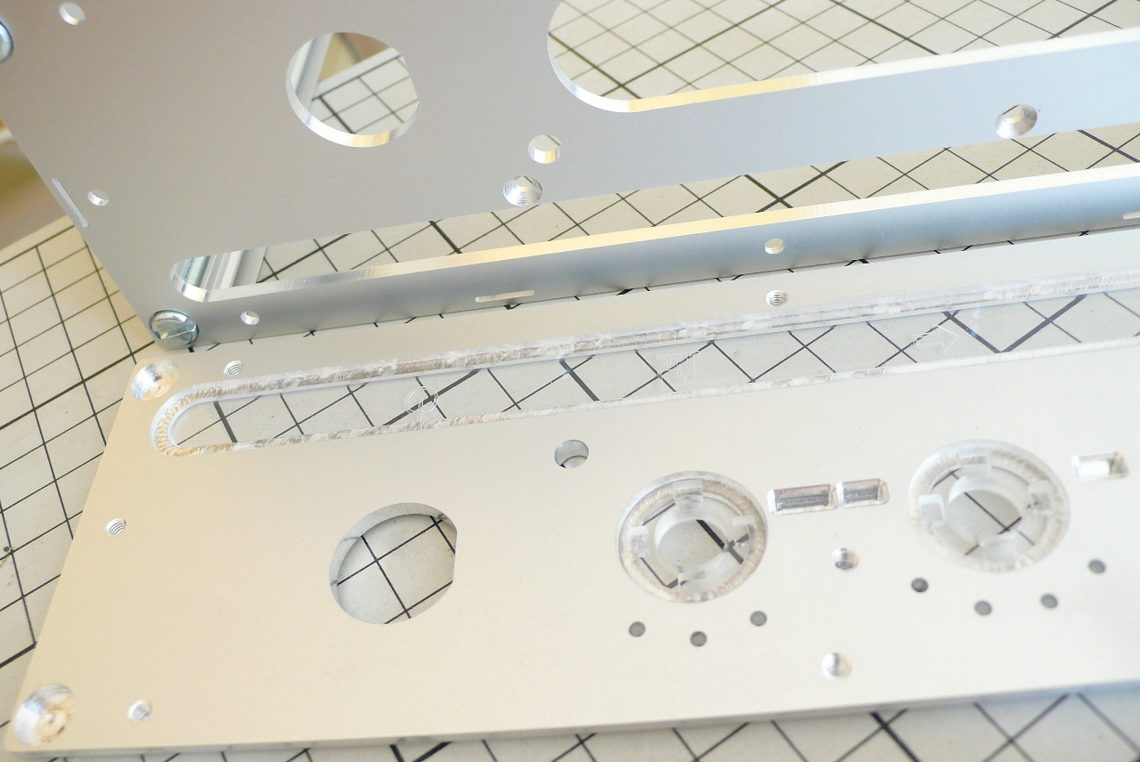

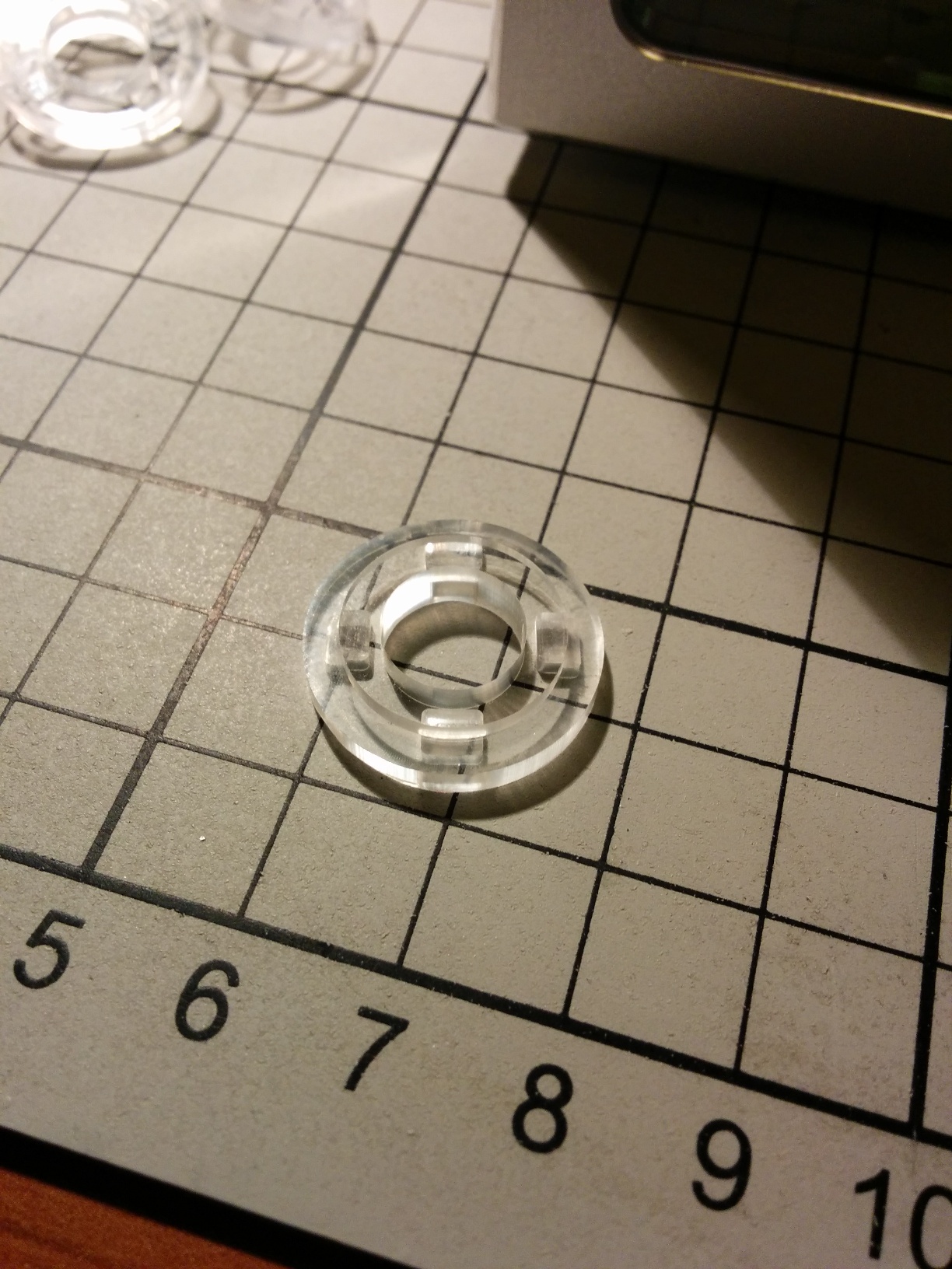

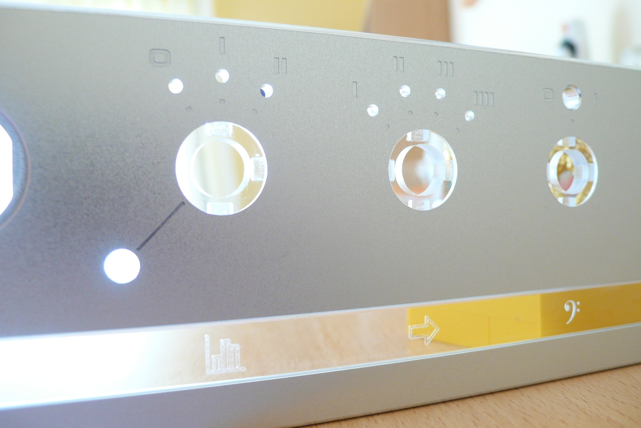

Mechanical Assembly 1

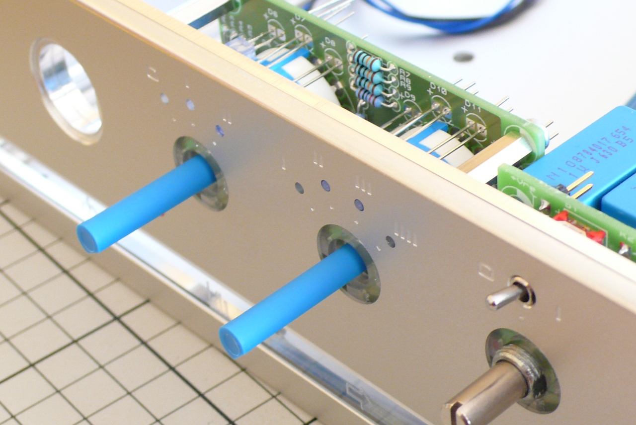

Here you can see the special light conduits I designed for the pots (made by Schaeffer) and how the plastic parts fit into the front panel. the front panel actually consists of 2 panels in order to produce the 'no visible screws' look. I also designed an illumination PCB to fit behind the light conduits. the Bass and Treble pots will glow bue unless they're switched to 'Tone Defeat', in which case they'll glow red to show they're not in use. I remembered to mill cut-outs where the PCB conatcts meet the front panel.
More construction photos to follow...
Dave.
Dave.
034 Base, Sides, Corner Extrusions and Front Inner Panels.JPG541.2 KB · Views: 944

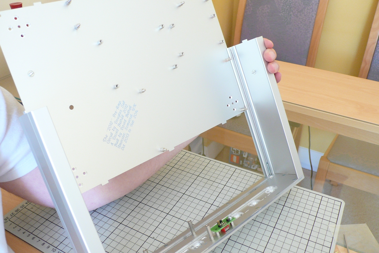

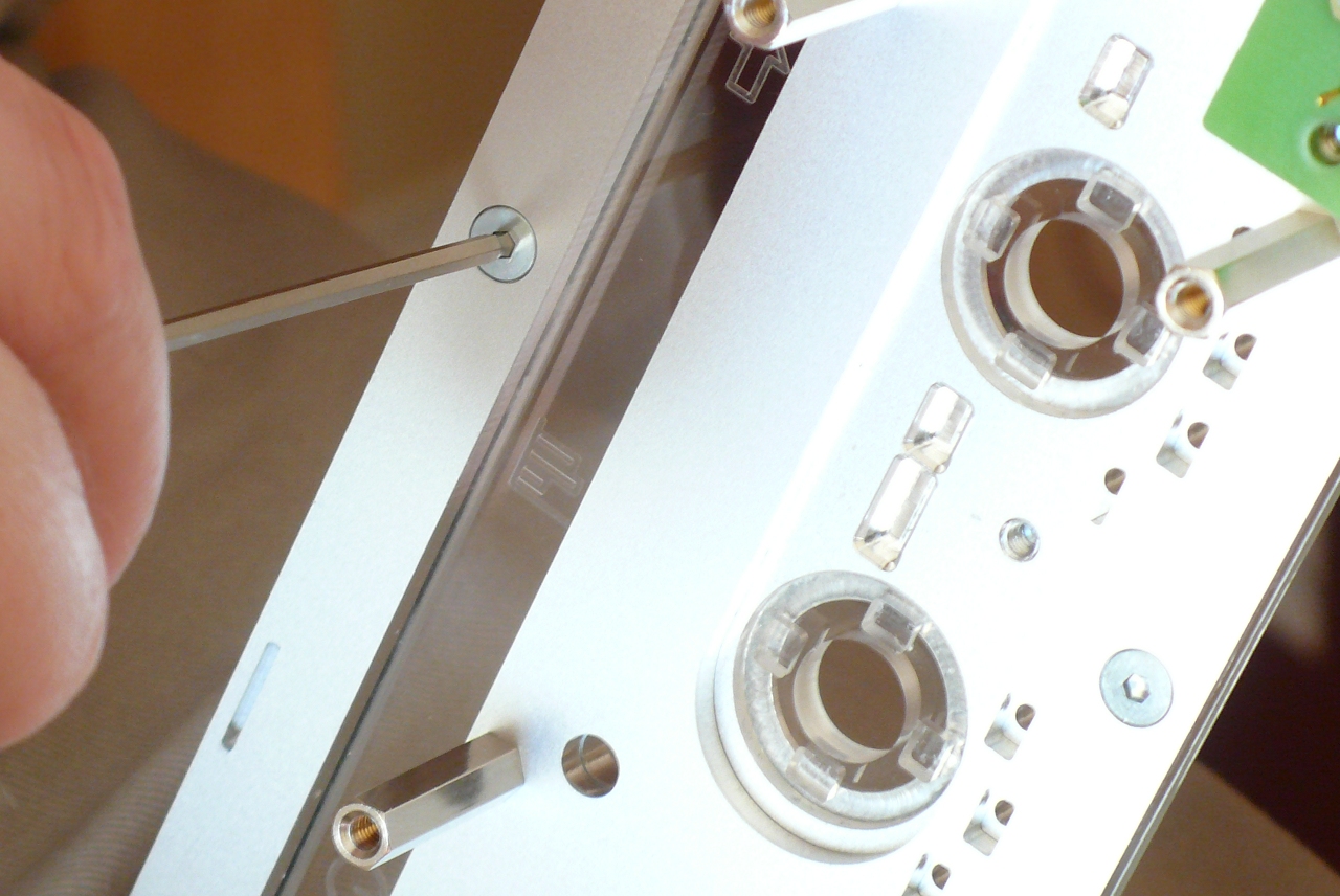

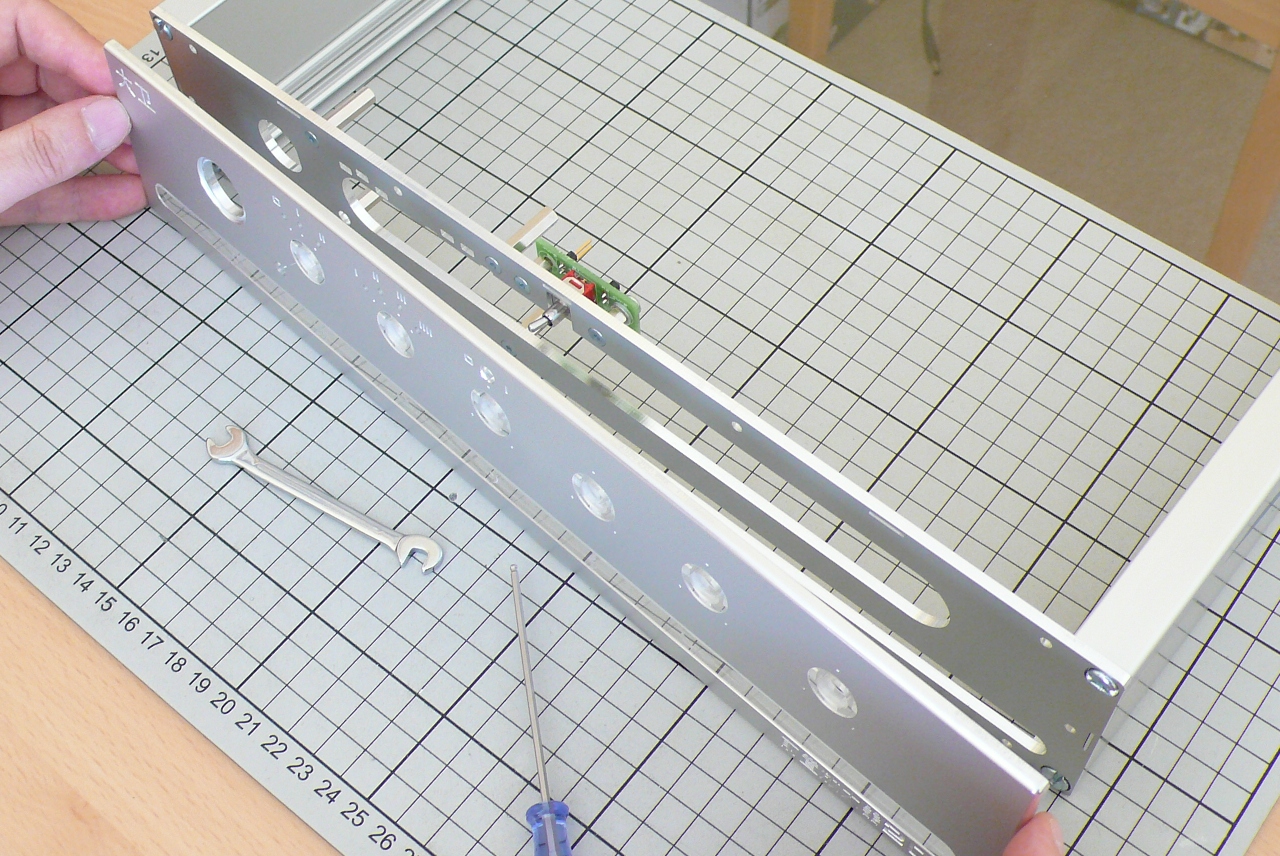

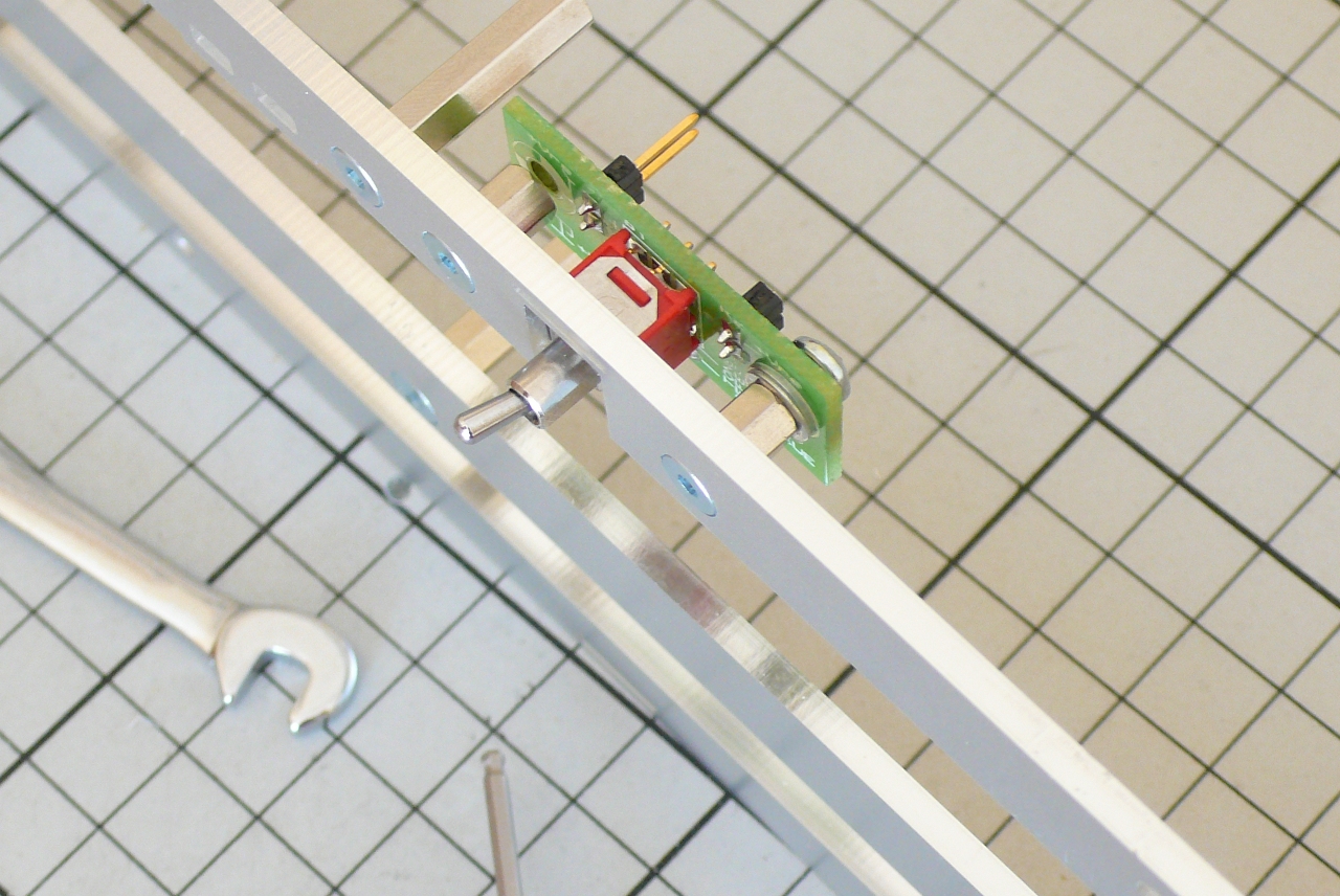

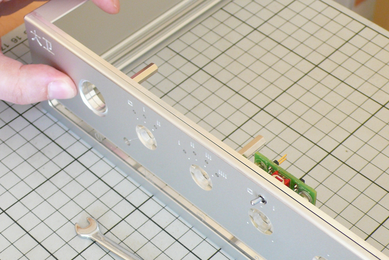

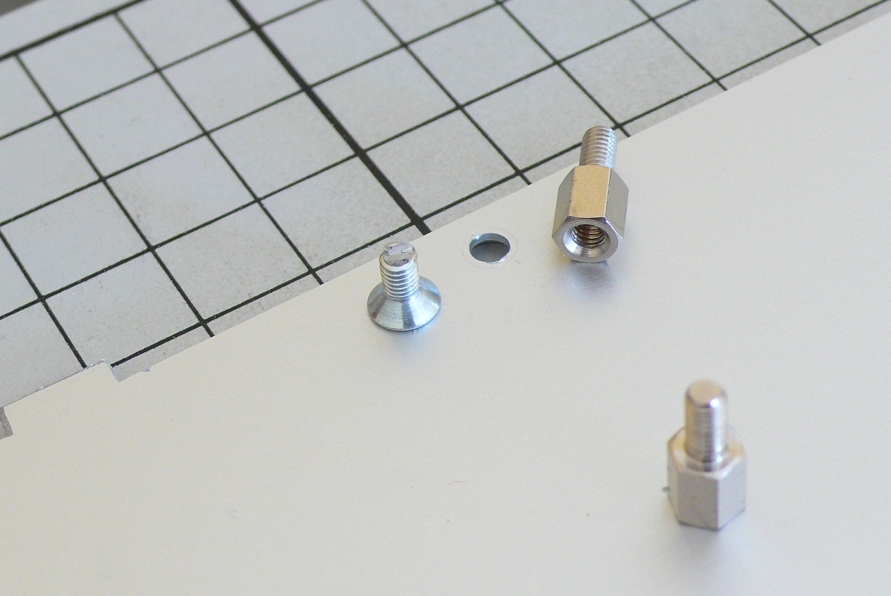

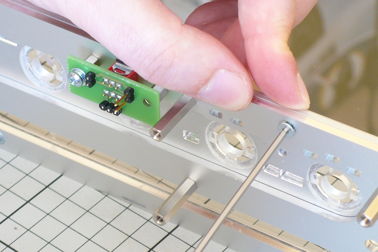

Mechanical Assembly 2

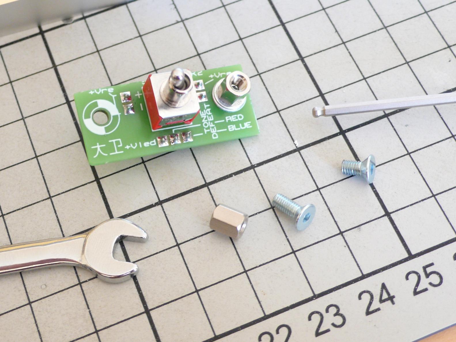

These photos show how the PCB pillars for the new rotary switch PCB and the tone defeat switch PCB are fixed to the inner front panel. The last few show how the two front panels are sandwiched together to hide the fixing screws. The screws used to fix the two panels together have been cut down to size.
Dave.
Dave.
051 Method of Assembly - 20mm PCB Pillars for Rotary Switch PCB.JPG798.1 KB · Views: 244
052 Method of Assembly - 20mm Pillar fitted to Front Inner Panel.JPG710.8 KB · Views: 163
054 Method of Assembly - Tone Defeat Switch PCB & Parts.jpg188.1 KB · Views: 227
056 Method of Assembly - Tone Defeat Switch Fitted to Front Inner Panel.JPG690.5 KB · Views: 228
057 Method of Assembly - Aligning Front Outer and Inner Panels.JPG718.7 KB · Views: 181
062 Method of Assembly - Fixing front Outer Panel with Cut-Down Screws.JPG663.9 KB · Views: 224

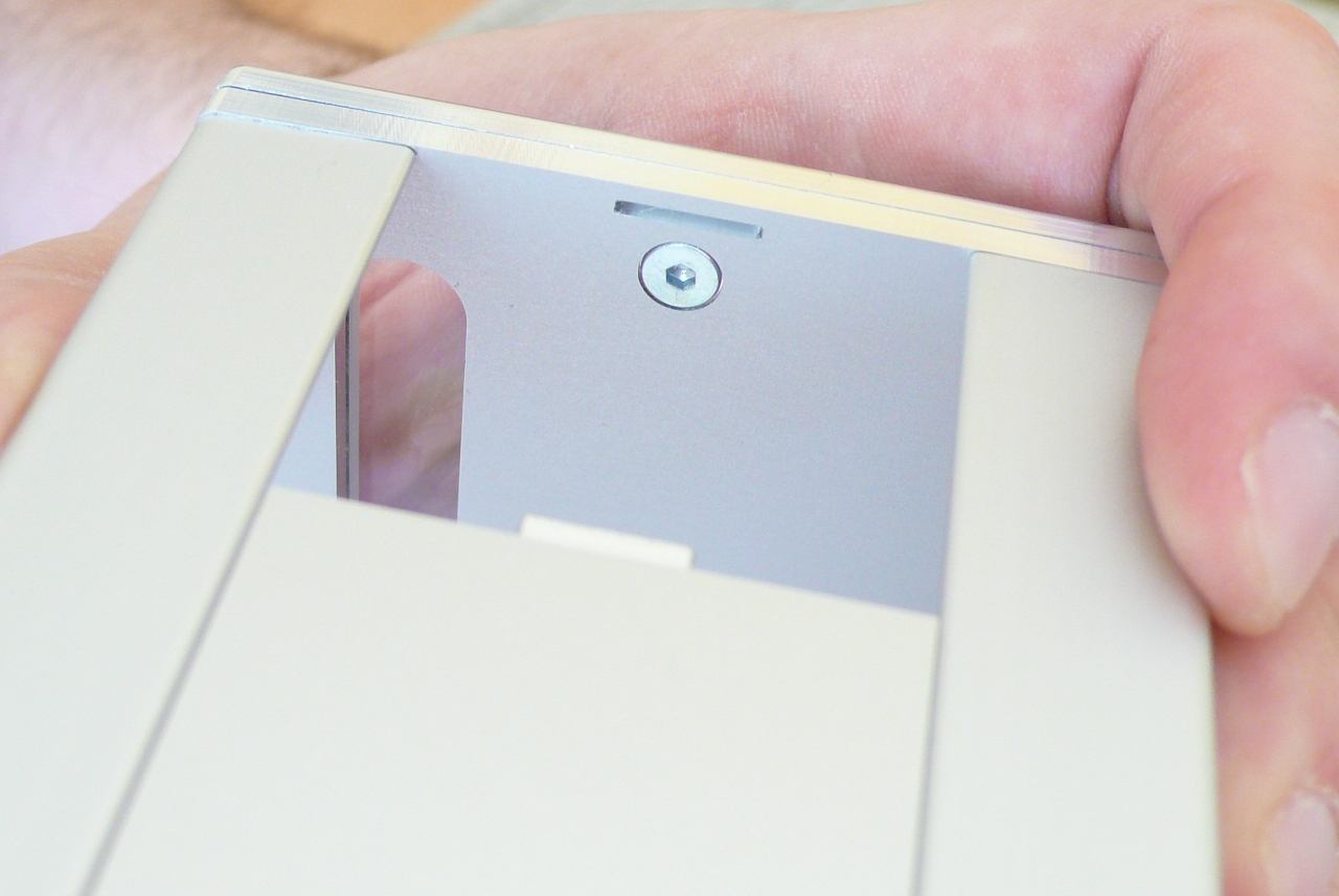

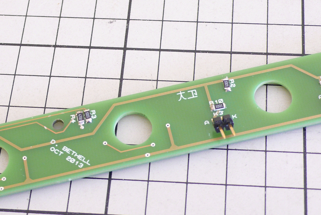

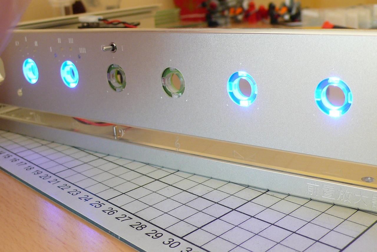

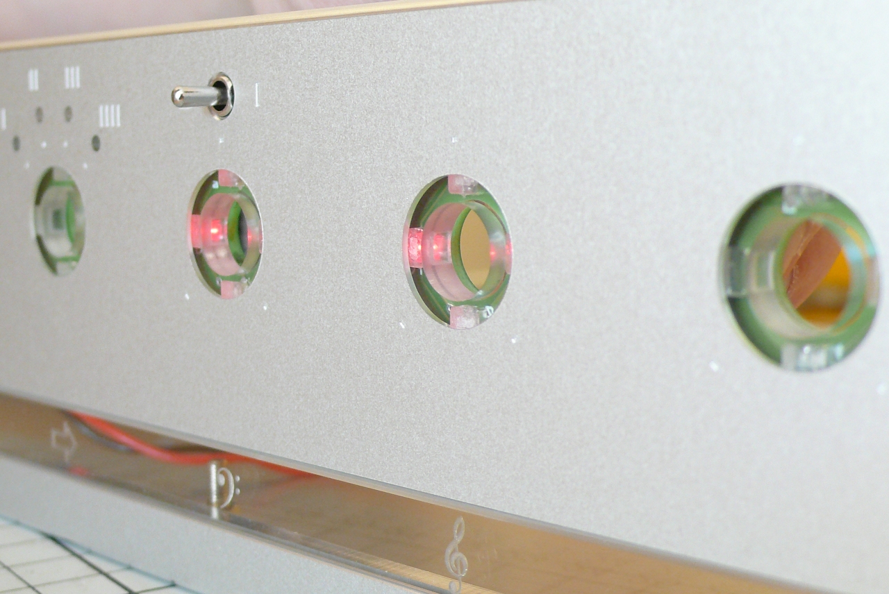

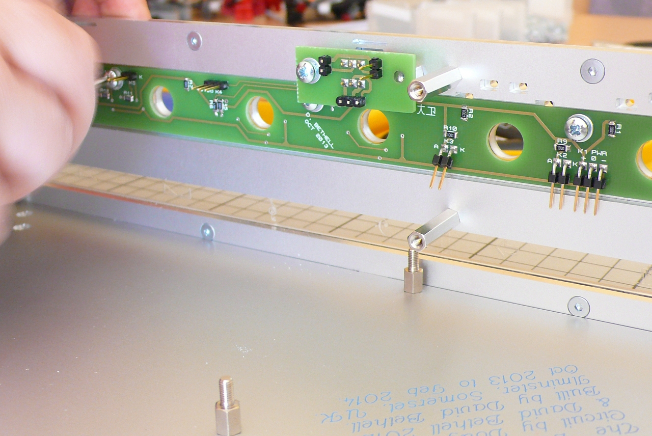

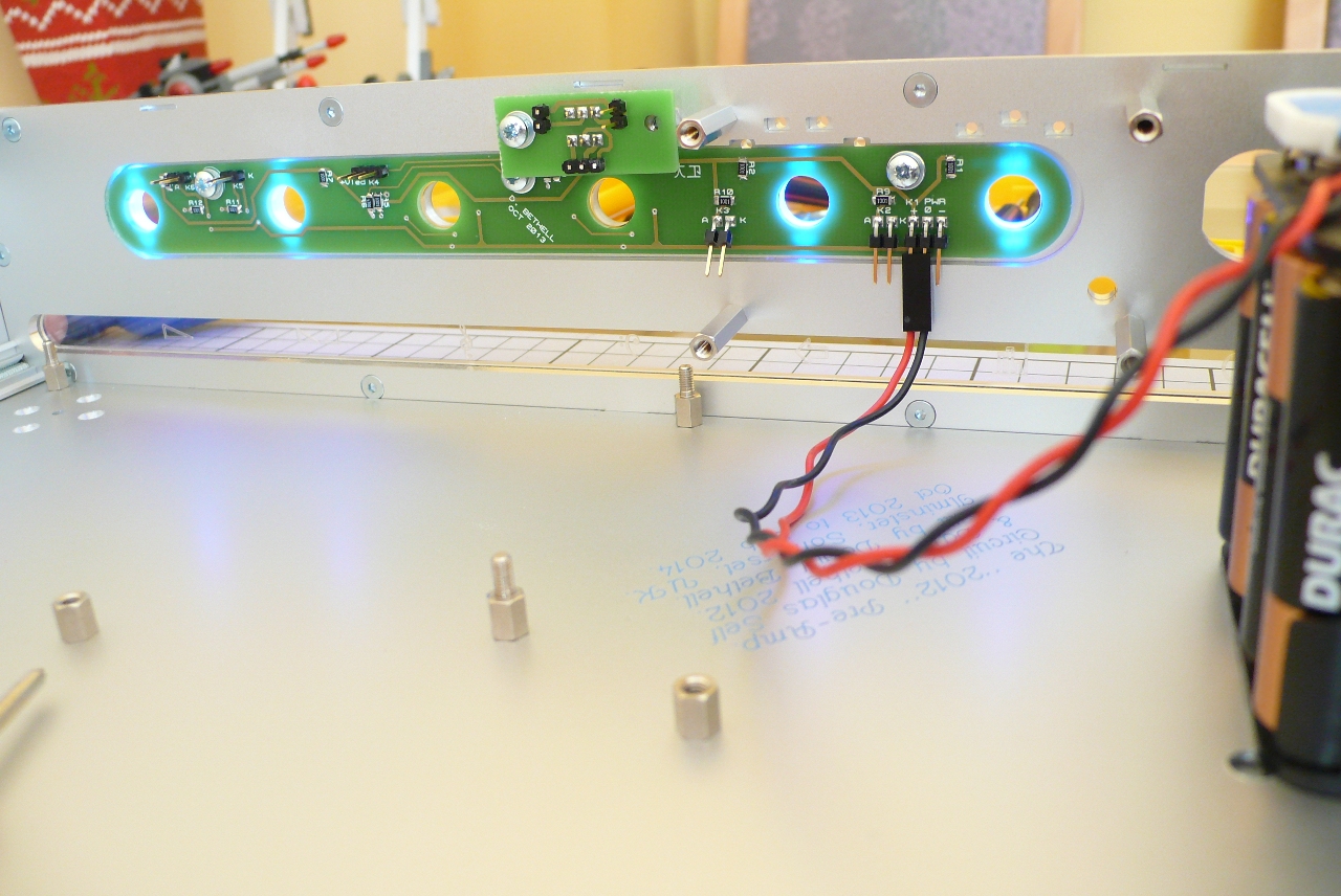

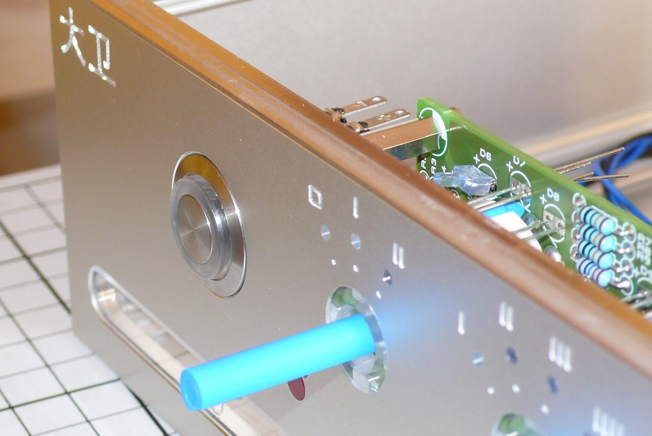

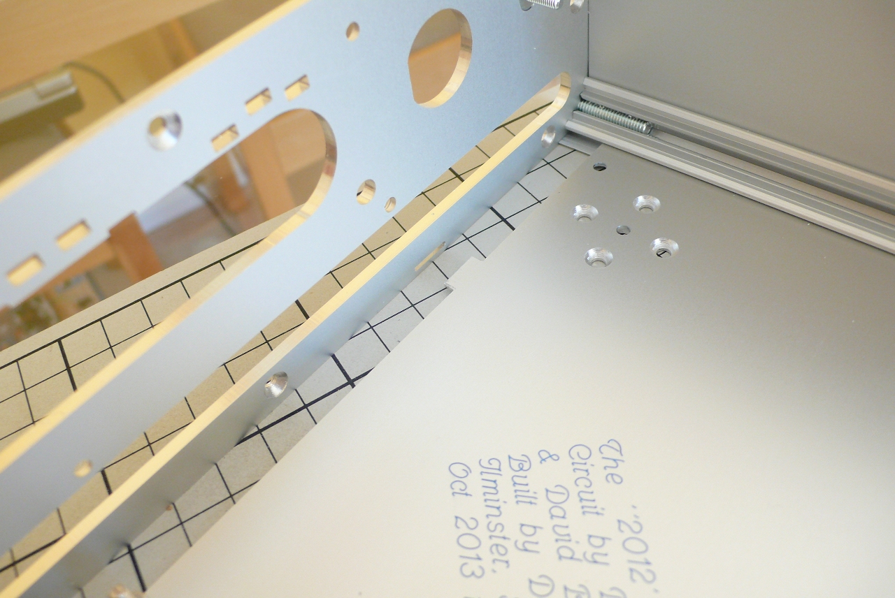

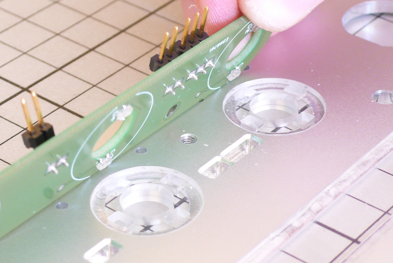

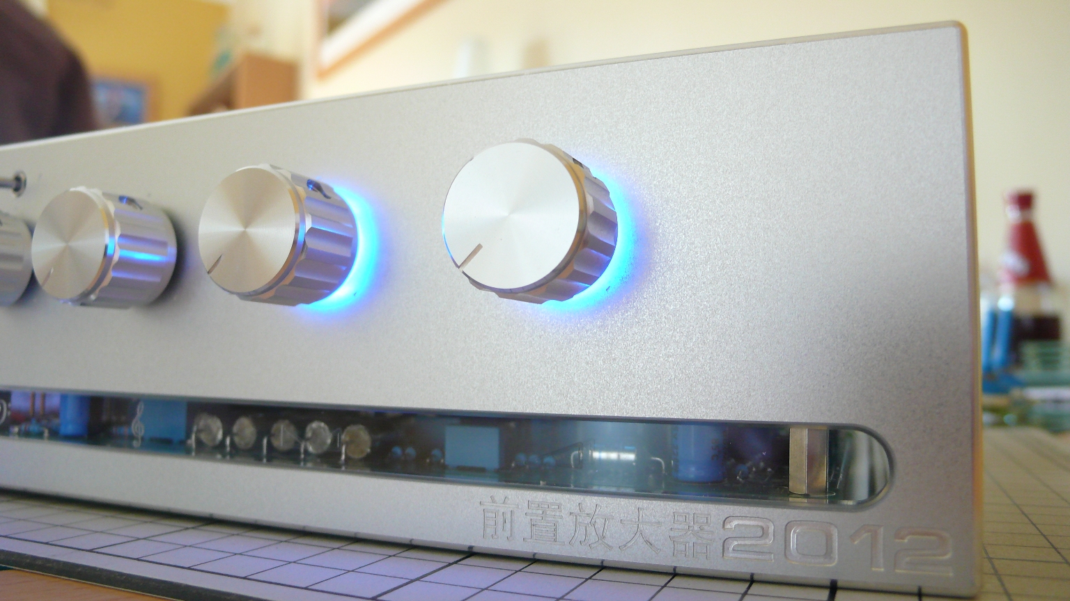

Mechanical Assembly 3

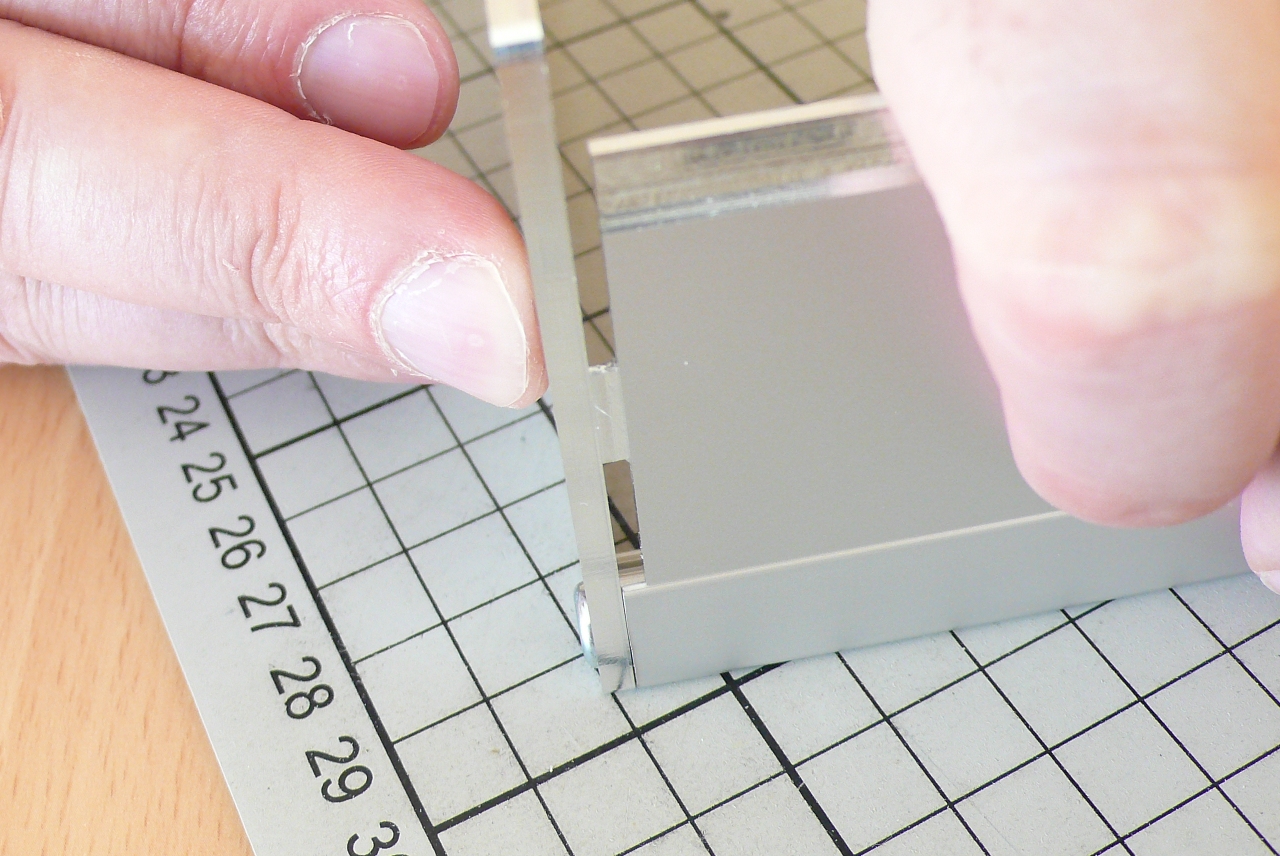

These photos show how the sides slot in with their 'tongue-and-slot' ends. I was going to use Schaeffer's corner brackets to stop the top and bottom of the case from flexing, but I didn't have enough room in the case. So I designed the panels with little tongues and slots to prevent any flexing of the panels.
Here you can also see how the illumination PCB fits and how it illuminates. Those red LEDs are a bit dim - they'll need replacing 🙄
Dave.
Dave.
071 Method of Assembly - Rotary Switch PCB Fixing Points.JPG707 KB · Views: 175
073 Method of Assembly - Base Panel PCB Pillars & Cut-Down Screws.JPG636.6 KB · Views: 162
081 Method of Assembly - Testing Illumination PCB with a Battery Pack.JPG648.8 KB · Views: 254
083 Method of Assembly - Tone Defeated Red LEDs a bit Dim!.JPG626.1 KB · Views: 207

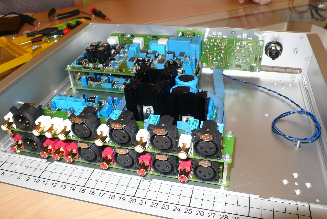

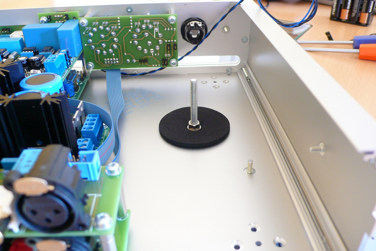

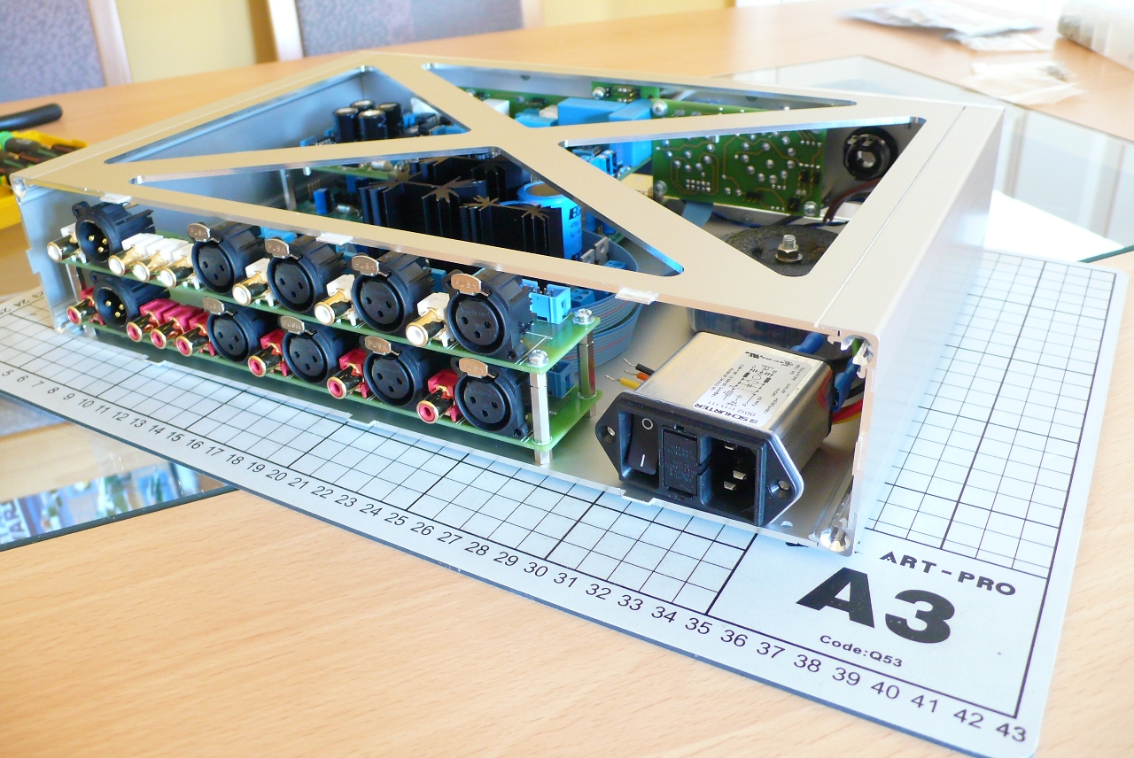

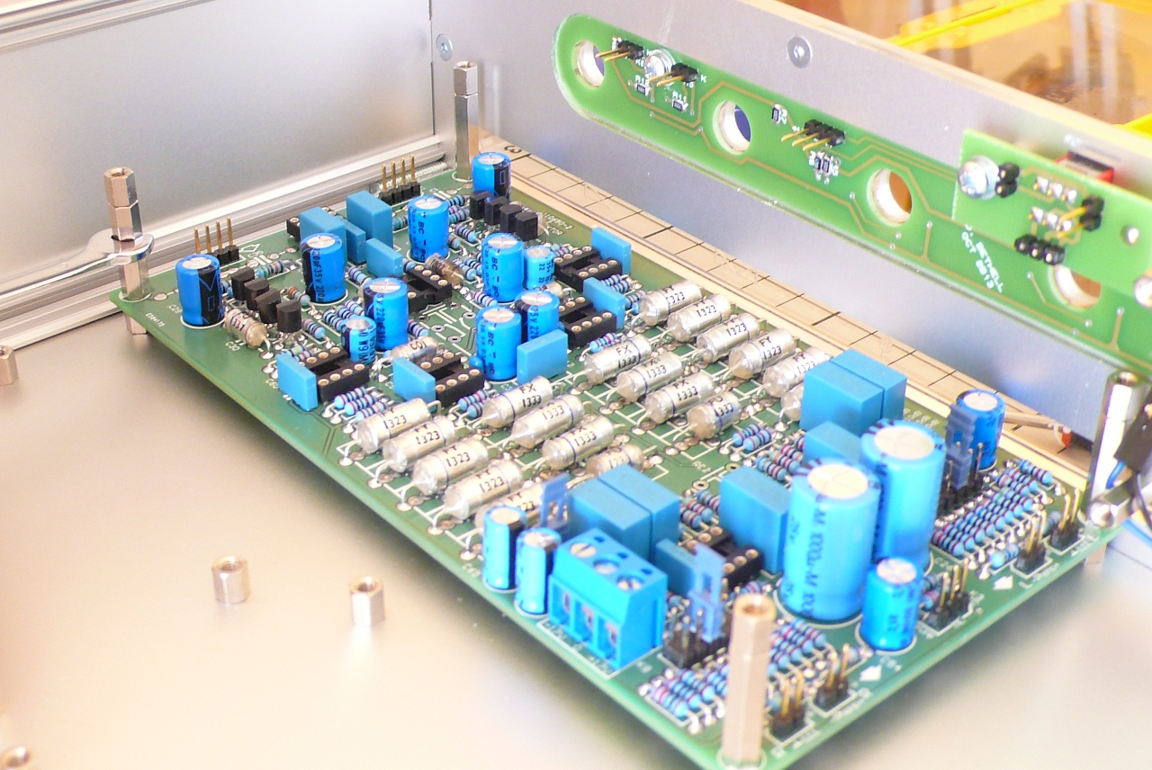

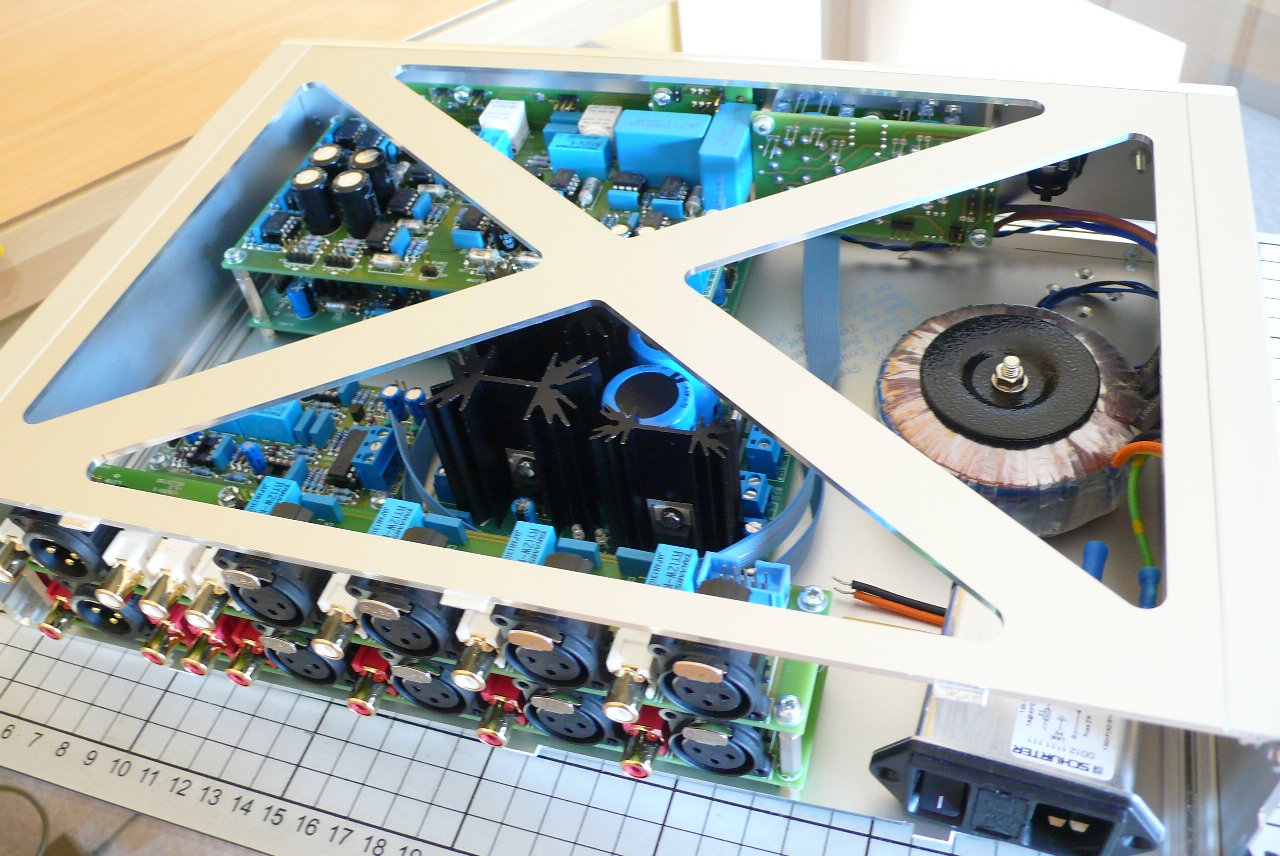

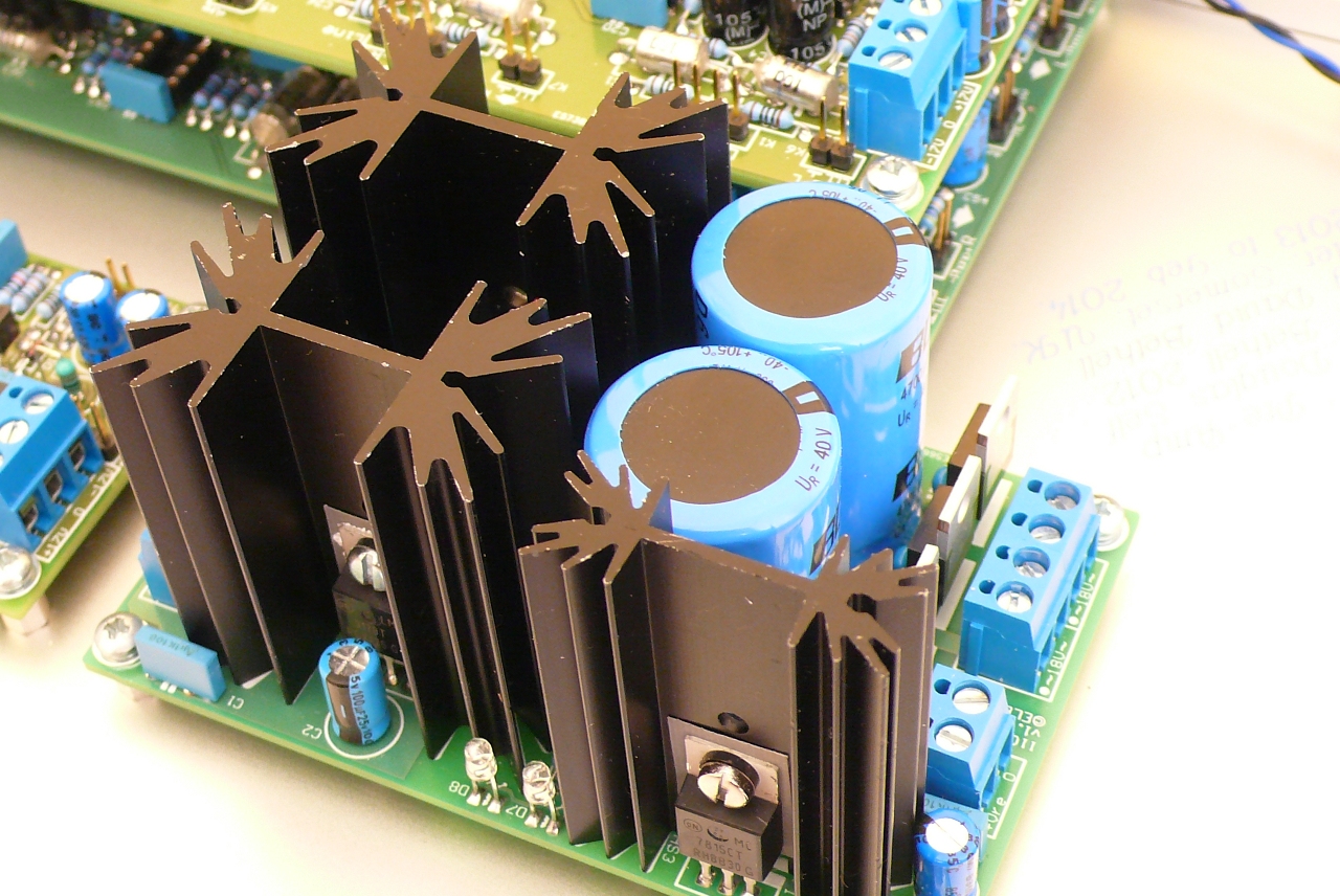

Mechanical Assembly 4

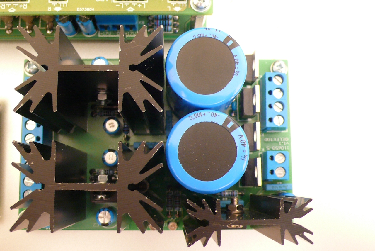

Here I am fitting the main PCBs into the case. There were some scary moments when I thought my maths had gone wrong - the pots didn't line up with the front panel holes until I realised that I still had the screws done up tight. There was enough play in the PCB holes to align everything 🙂 Remember that Front Panel Designer is a 2D tool and my brain had to think in 3D 😀 There is a screw missing on the tone Defeat PCB because the big capacitor on the line-in PCB got in the way - I didn't see that one in my 3D visualisation! 🙄
The Log-Law Level LED PCB seems like a lot to light one LED, but considering the amount I have spent on this project it didn't seem fair to leave it out.
Dave.
Dave.
084 Method of Assembly - Fitting Phono PCB and Home-Brew 26mm Pillars.JPG773.9 KB · Views: 317

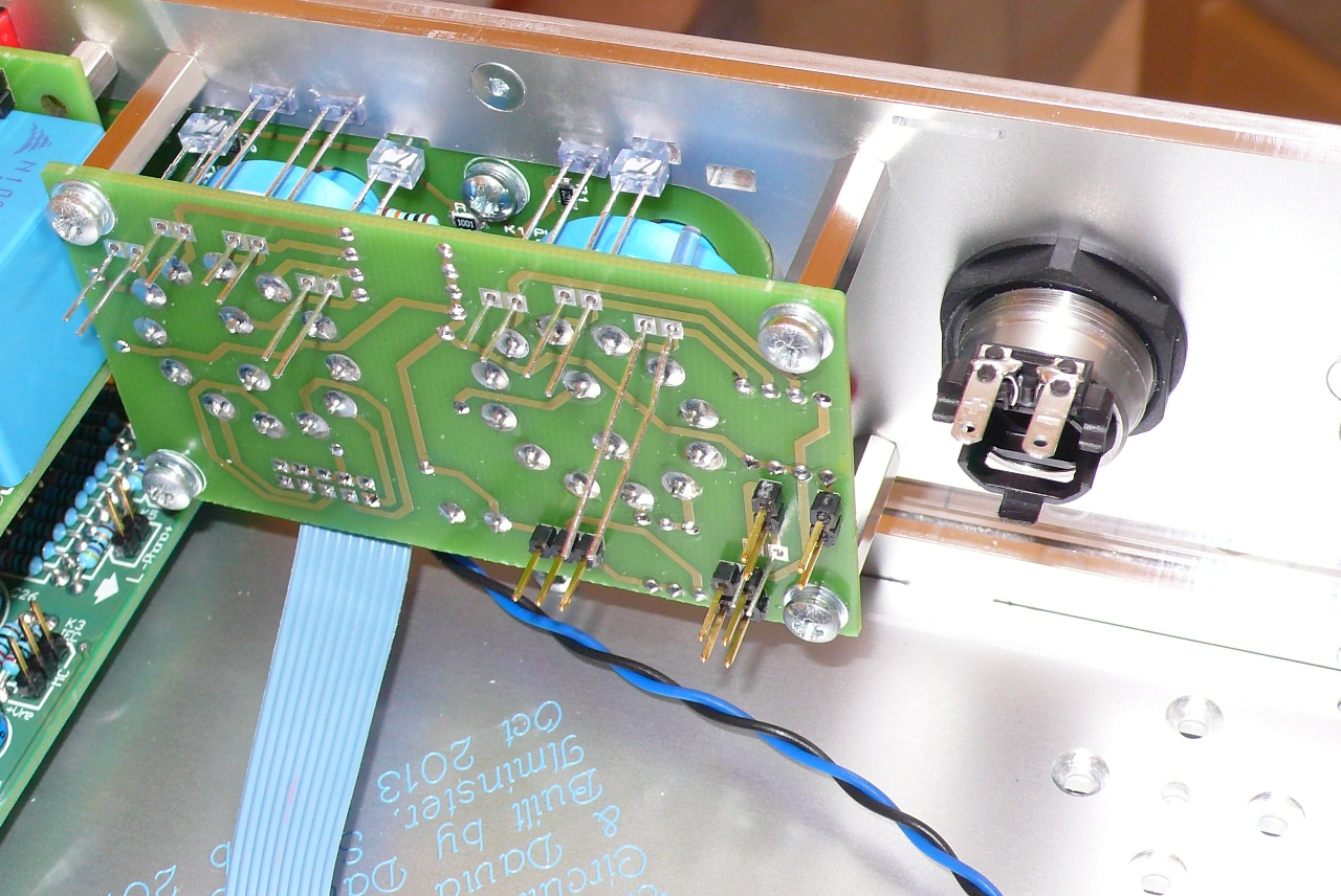

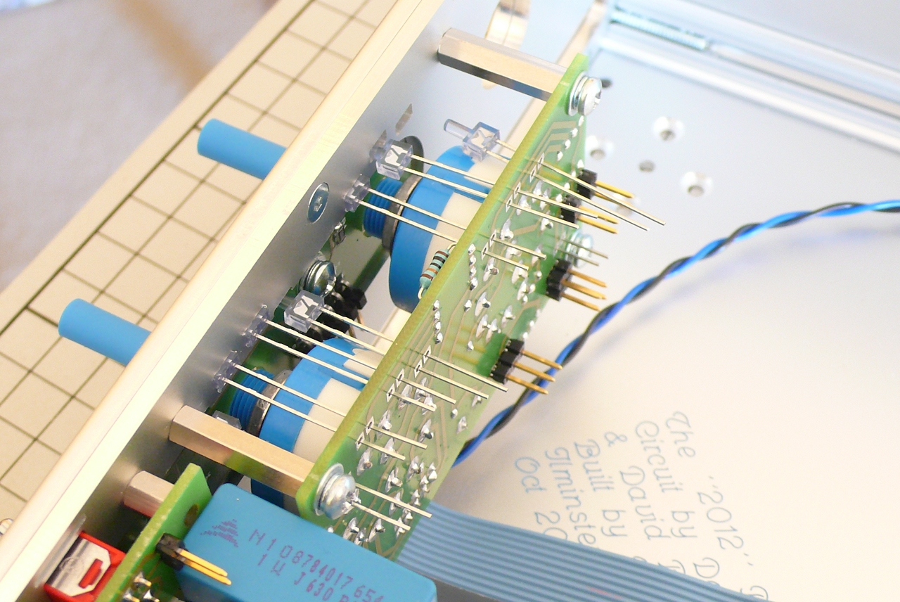

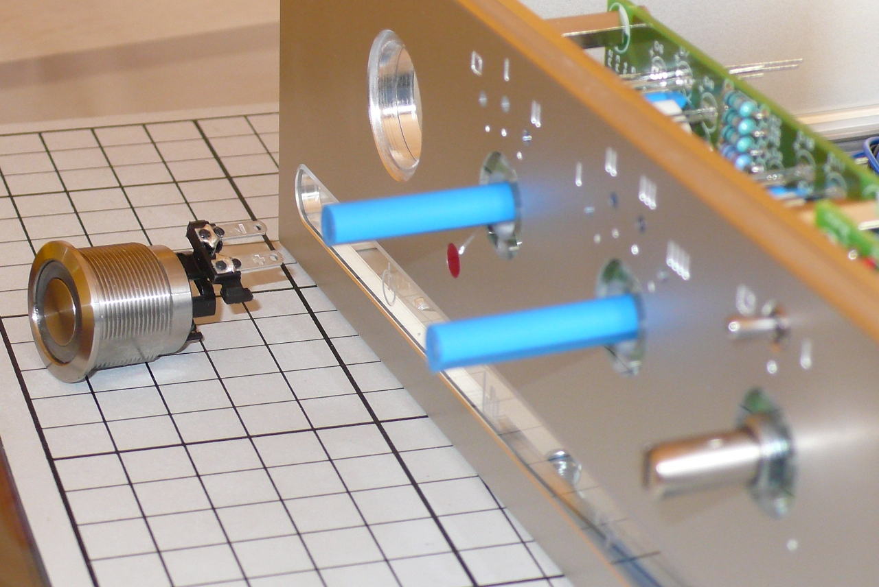

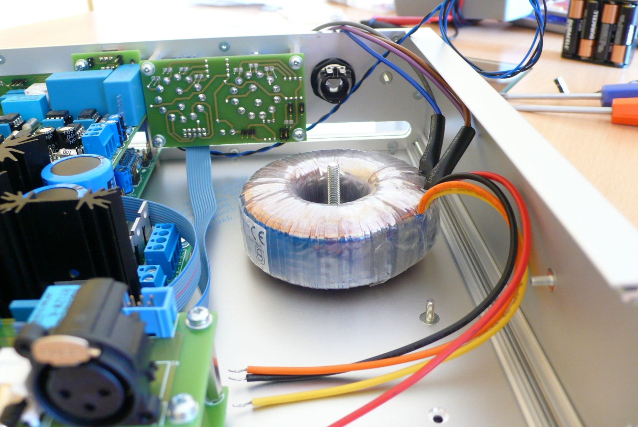

Mechanical Assembly 5

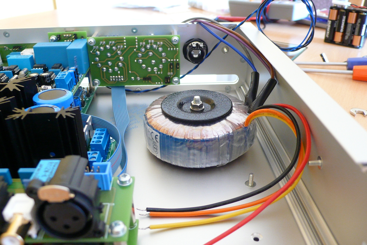

In these photos, you can see how the re-designed rotary switch PCB fits. The LEDs will be pushed into the front panel so that they are flush with the outer surface and then I will solder them inplace. You can also just make out the LLLL LED, also flush with the front panel. My re-designed PCB realigns the rotary switches - Elektor's original board made no sense! Also I have added the 2mm blue LEDs to show the selection made. The LLLL LED is a 5mm flat-top type.
My wife is the photographer - she captured the last 3 photos really well considering she moved while I assembled the transformer 😀 Run them in sequence and you can see the building in progress! 😉
Stay tuned for the top panel...
098 Method of Assembly - Fitting the Rotary Switch PCB.JPG678 KB · Views: 265
109 Method of Assembly - Fitting Left Channel Input PCB.JPG596.5 KB · Views: 294

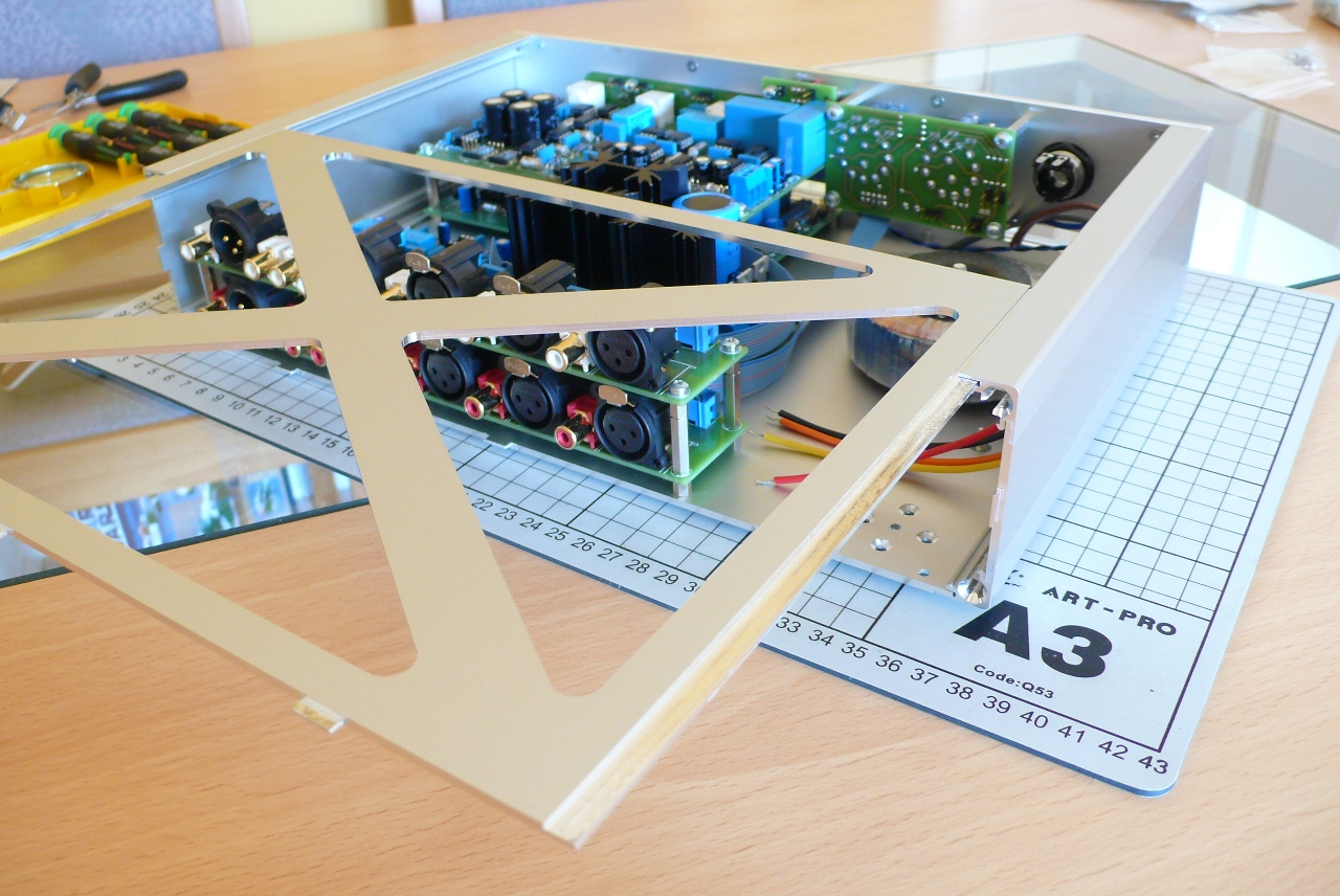

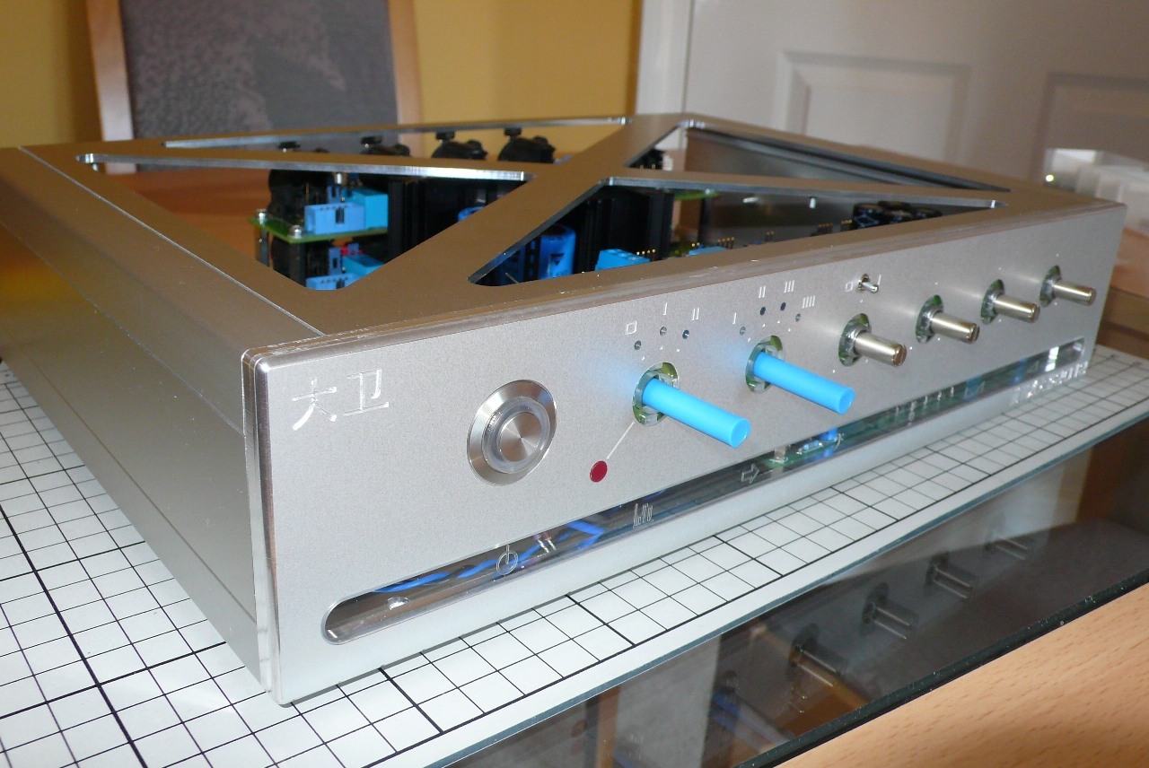

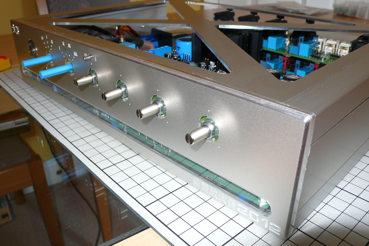

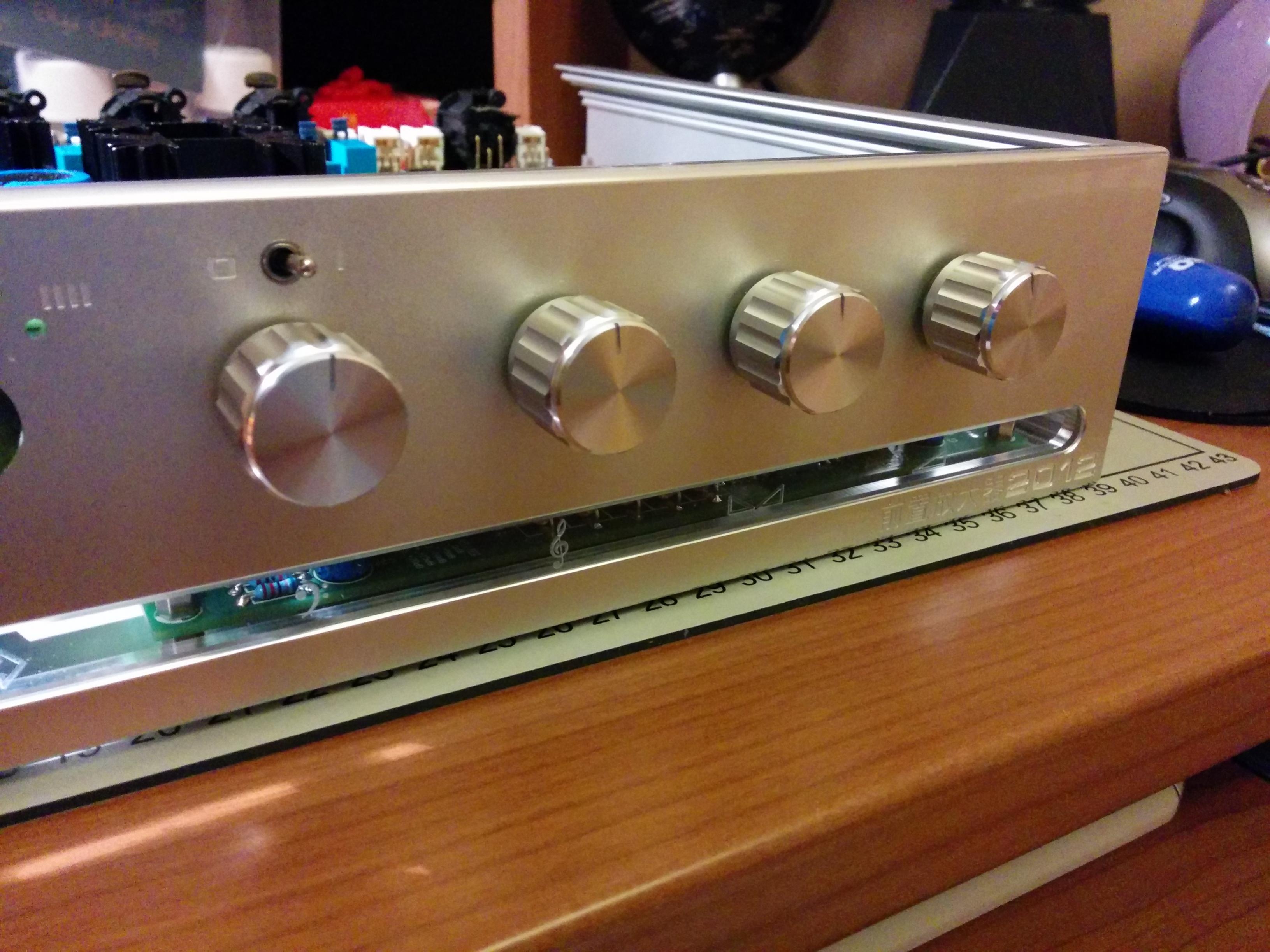

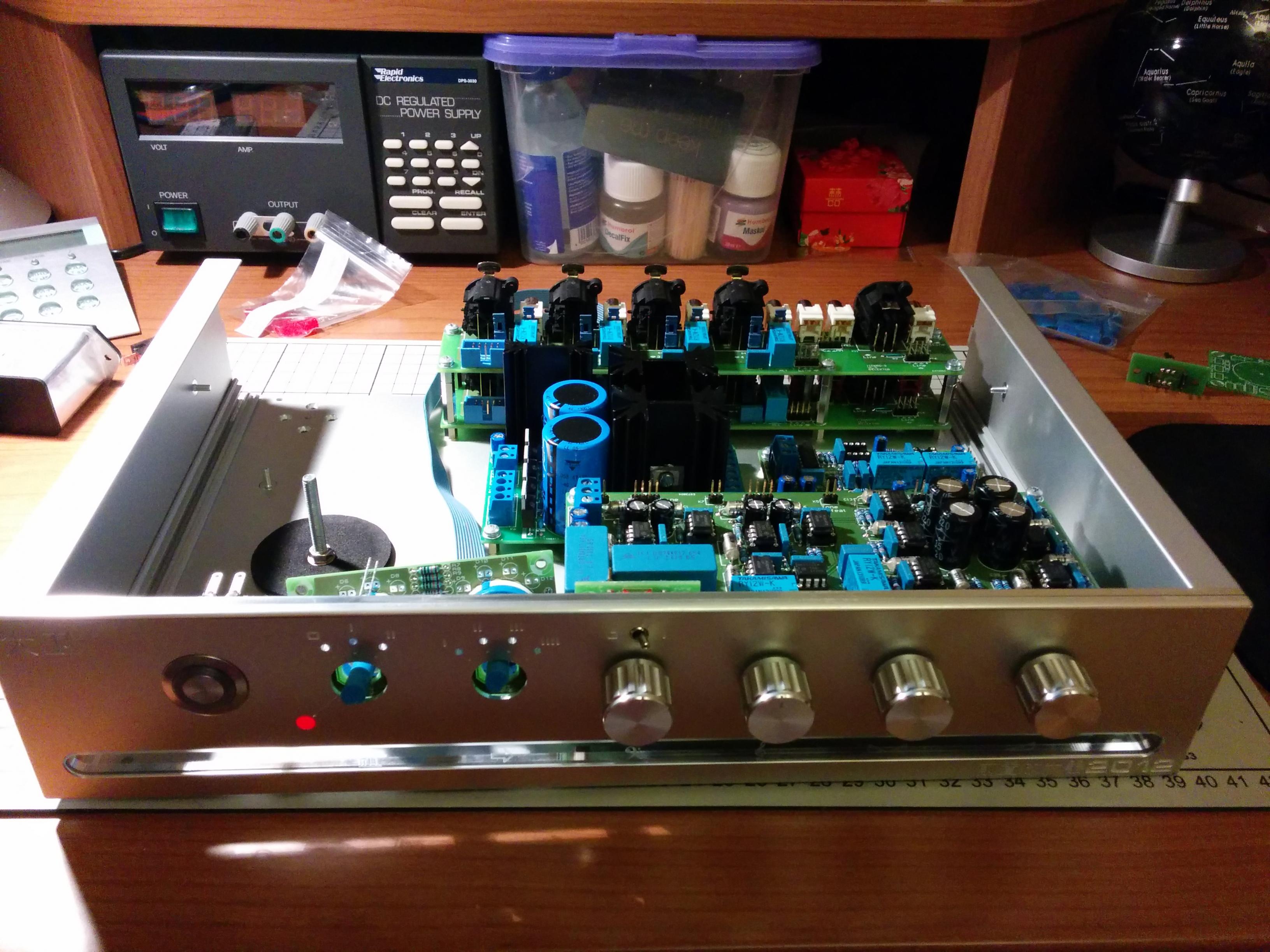

Mechanical Assembly 6 - The last one!
Here you can see the top panel. It has the same tongue and slot fixings as the side and bottom panels. It will eventually have perspex in the triangles. This panel was one of the most complicated to do in Front Panel Designer. The first version had slots for the triangular cutouts, but I found that if you insert a rectangular hole and set it to triangle, you can save money 😉! The perspex panel to go under it will have to have curved slots to match the radii of the triangles' corners. I will take photos of this when I finish designing it and it arrives.
Next up, some overview pics...

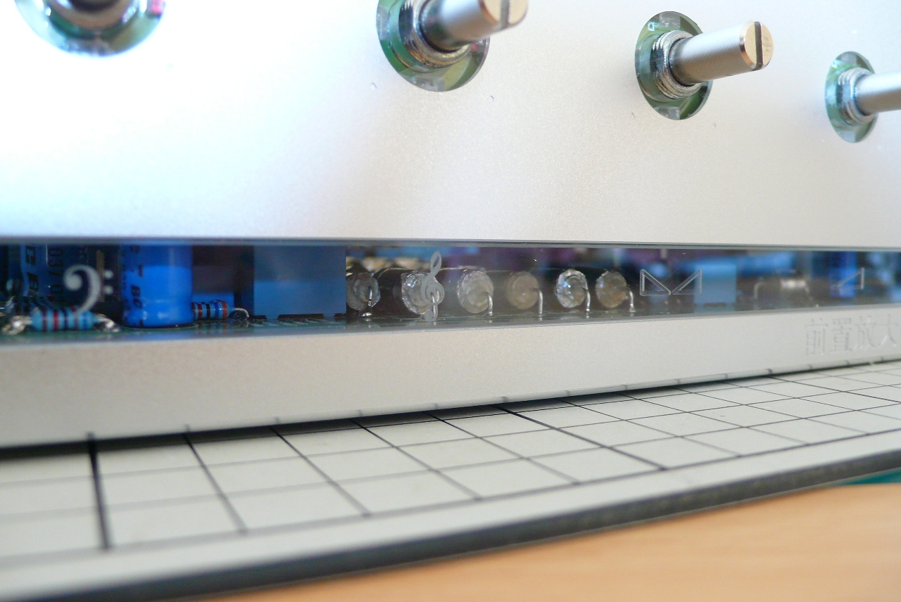

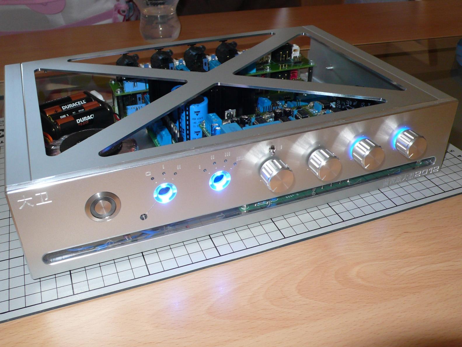

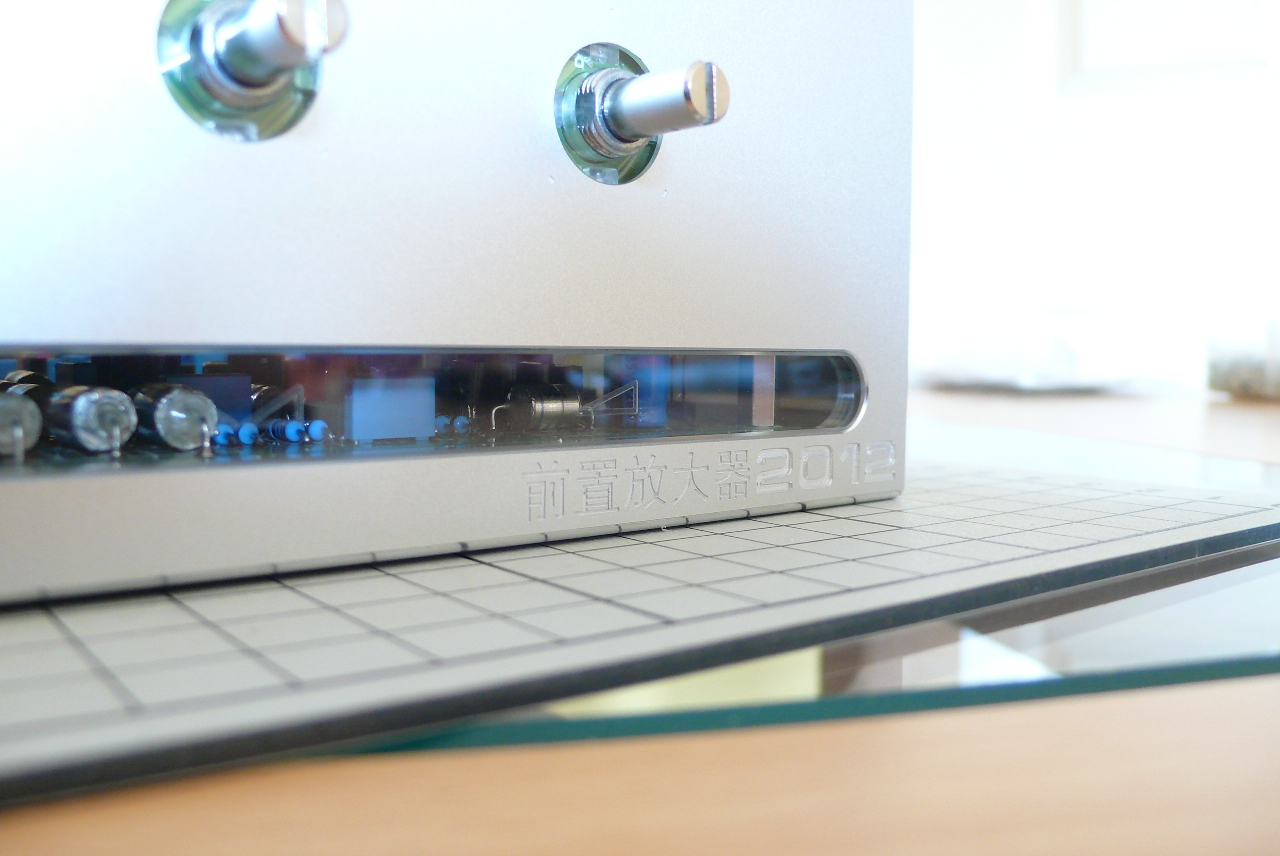

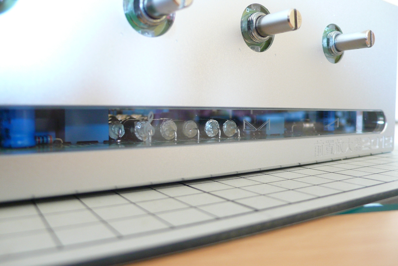

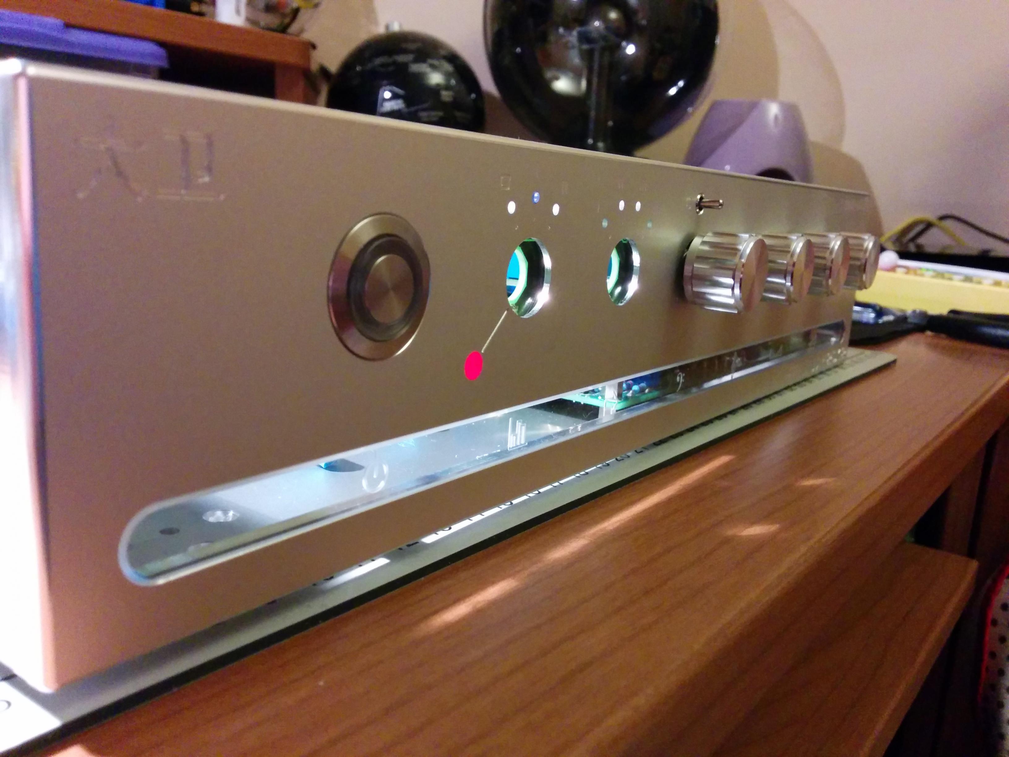

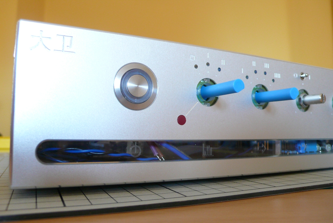

General Photos...
Just some general photos...
Now I have to remove the lid, wire-up, design the rear panel and top perspex panel and it will be completed! Whew!
I'm also building the Op-Amplifier for the same project. Watch out for those photos in the chip amp section soon...
Bye for now,
Dave.
Bye for now,
Dave.
