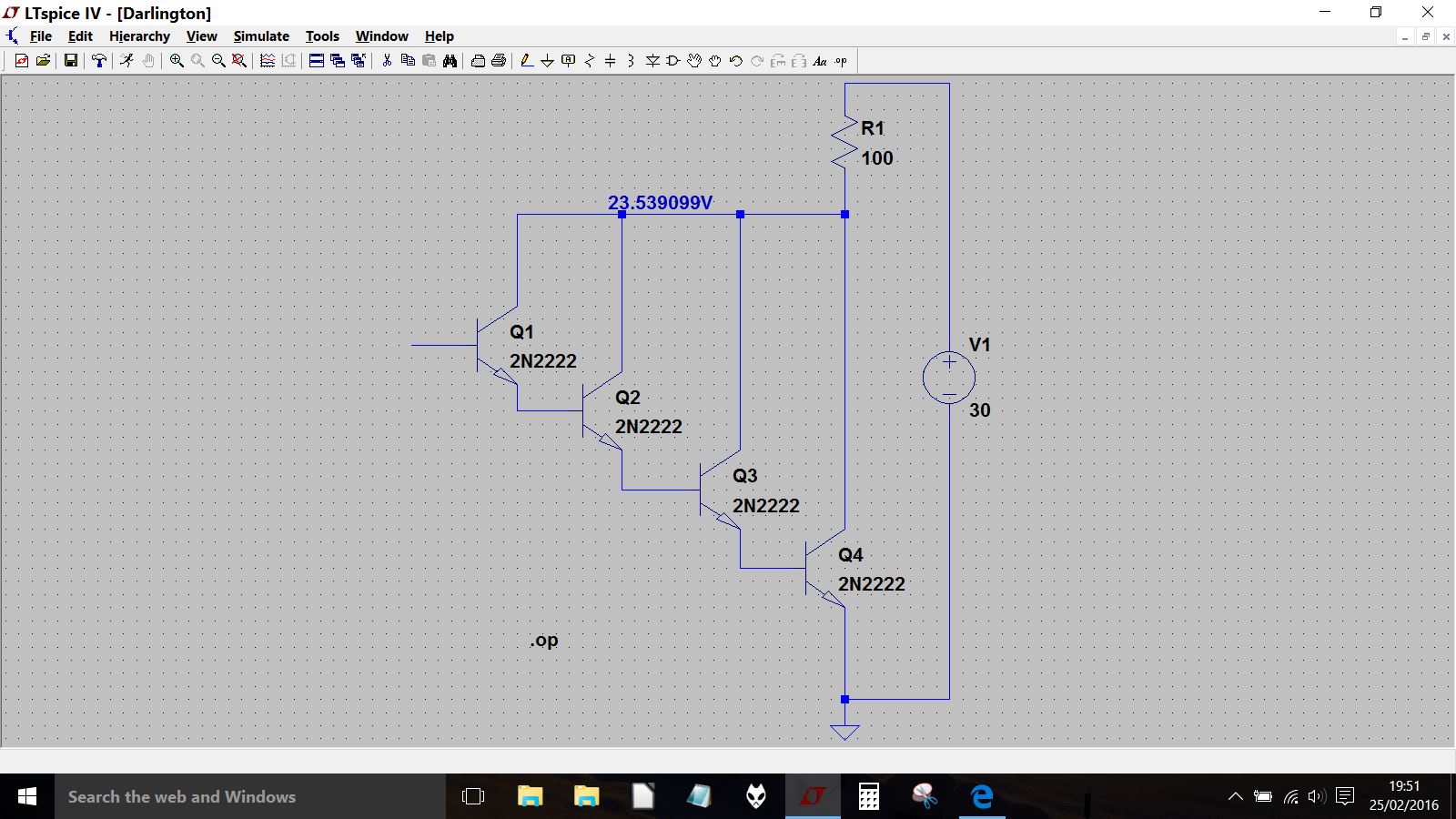

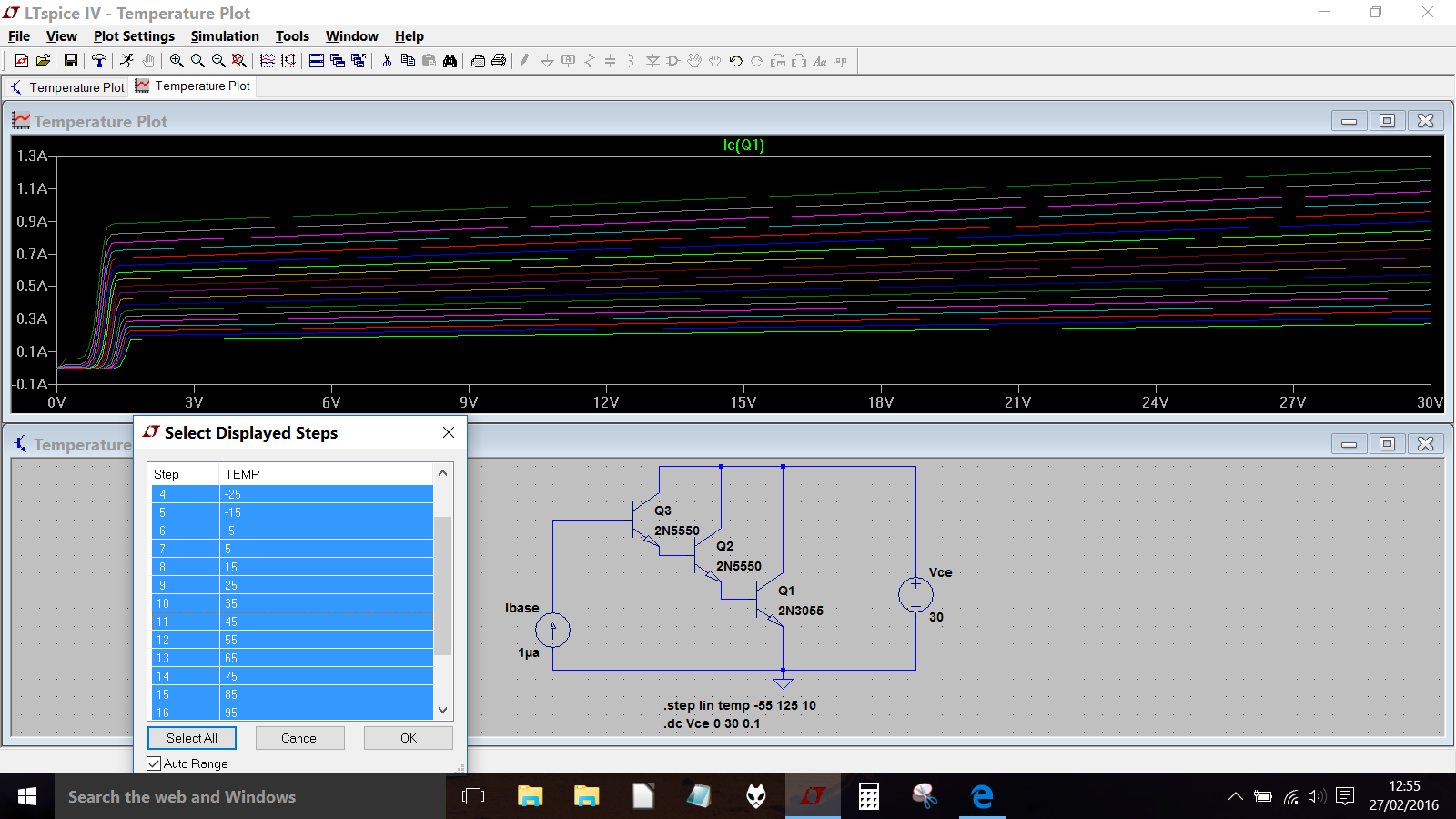

lets say if you had some darlington transistors. and you "darlingtoned" them together and attempted to repeat this pattern....
when would there be diminishing returns?
being so sensitive it conducts fully on just from the microscopic current/voltage existing in the atmosphere or something?

Darlingtoned them together, needs a diagram to show, if you mean parallel, or series,
and if connected in a single ended, or dual rail supply.
single ended power supply? just 0v and +v?
lets say you just repeated the pattern of making a darlington transistor.
Put two darlington transistors together. the way you'd put two transistors together to make a darlington.
If you repeated the pattern you would end up with an incredibly high gain 'transistor', but it would be unusable. You would need to overcome all the 0.6 volt base and emitter volt drops to get it to turn on.
A power FET is much better if you want something that you can control by just touching it with your finger.
so if you had the right amount at the input you'd get what seems like almost a straight wire at the final transistor?
I was thinking of using high power transistors rather than signal-level transistors.
Yes, the final transistor would conduct so well it would be like a piece of wire. You would need at least 2.5 volts or so to be applied to the base of the first transistor for that to happen though.

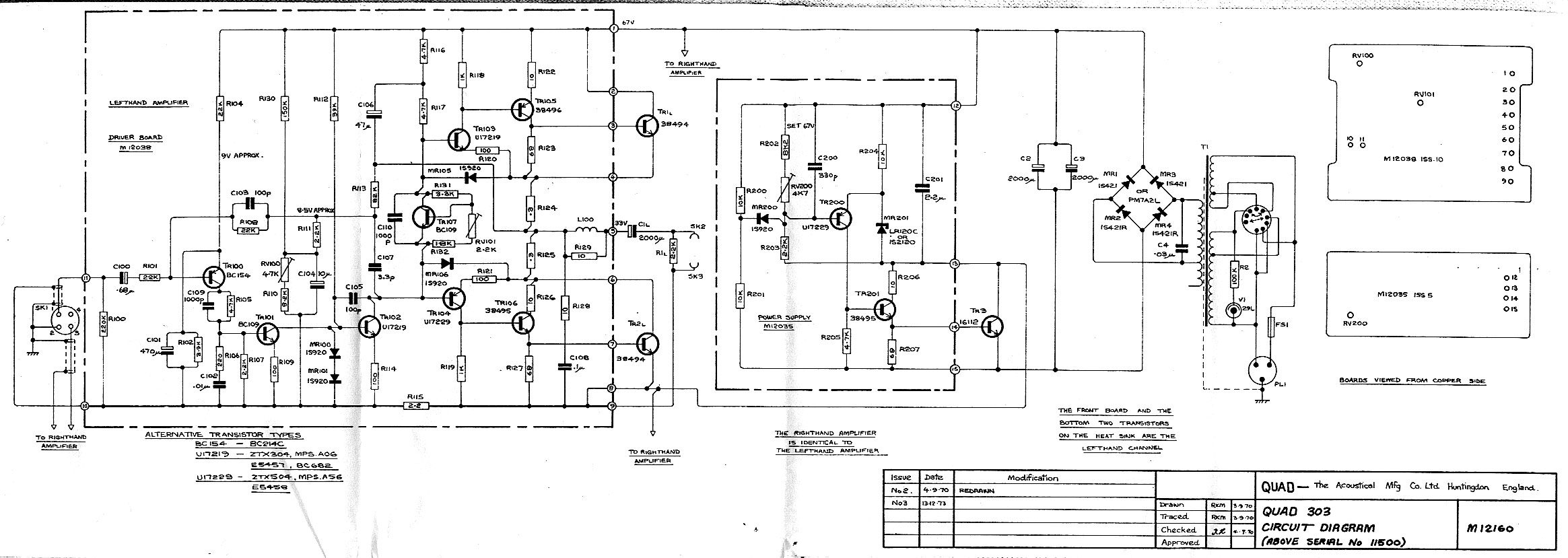

It's time to read a few more threads and do your own research by checking out the amplifier designs discussed here for yourself. There have been many commercial amplifiers that use various CFP/EF combinations in triples. That's Szlikai/Darlington type in your terms but none of this fits the definitions anyway.
Just as explained earlier, forget the masses of pointless gain when stability gets worse as you increase the number of close coupled devices and worse again with CFP coupling. The diminishing returns just keep diminishing unless you become a solid-state genius in the future and solve the problems for Physicists, Engineers and Scientists everywhere.
Quad 303 model is a well-known example of such a conjugate compound output stage. Note the different mixes in the upper and lower triples to also form a Quasi-complementary output stage:
