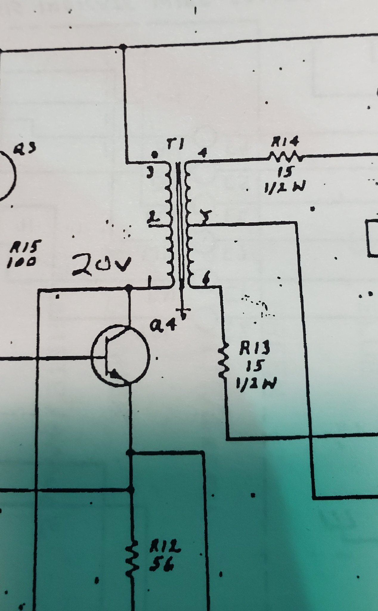

Can someone please explain what one dot on the transformer means. Usually when I see dot convention there's at least two dots

A single dot is of no use - its a notation to show relative phase of windings, so all windings should be marked. However there is also the convention that all windings face the same direction, so dots are not normally needed. One dot is just wrong and raises questions more than it answers them!
