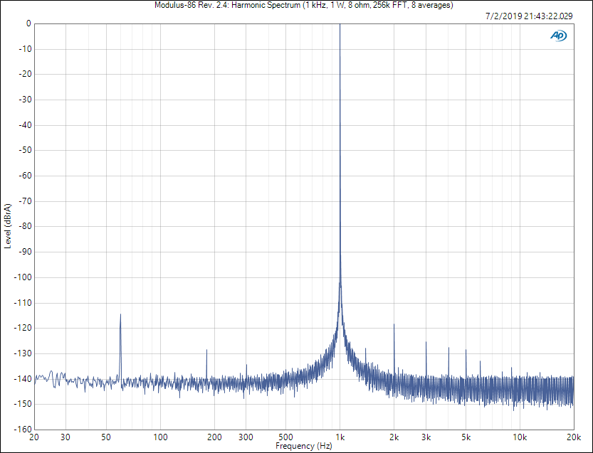

Do you have a spectrum. The THD measure si have seen are meaningless (we have discussed that and disagree). Rout is also far to low to match the FE206. The big amp of yours was fantastic but Rout could have been a bit higher for the big A12pw MTMs in that demo.
When the THD is 118 dB down, does the spectrum matter? Inaudible is inaudible. Either way, see attached.
I'm not aware of any science that backs that up, so we will have to disagree on that. We were quite a few in the room who disagreed with you during that demo, by the way.
